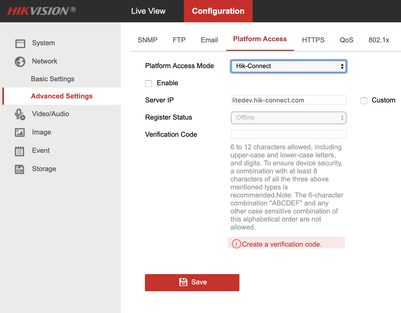

If it is just the 2 cameras then you will need to enable P2P in the camera's settings, the screenshot below shows you where to find the P2P settings in the menu:
2538
When you enable P2P you will be asked to create a verification code, we would recommend just using the password of the camera as it makes it easier to remember, you will then need to create an account at Hikvision online Hik-connect portal before then adding it to the app, this explained in this forum post - Hikvision App

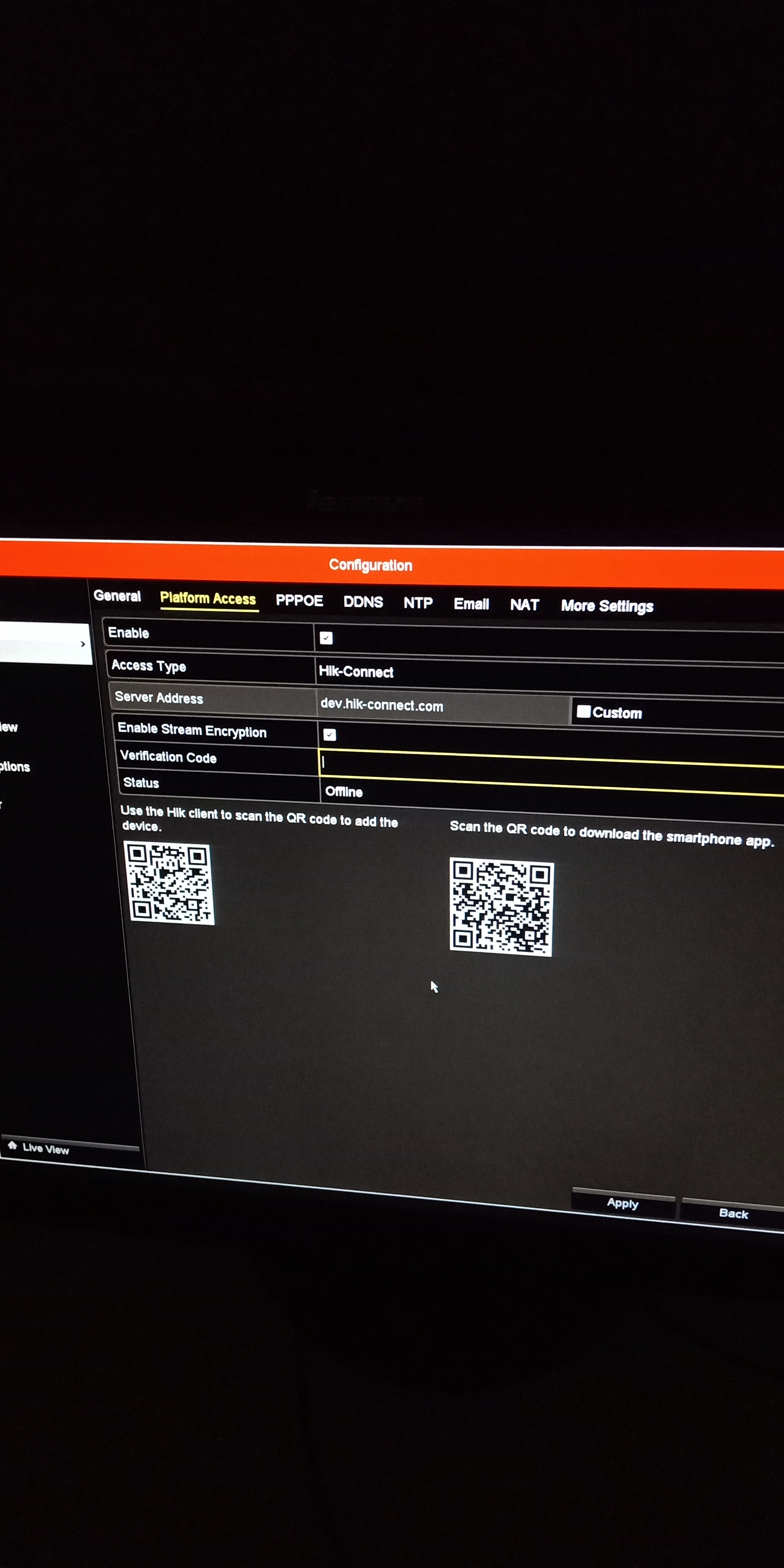

My settings screen and side-menu seems quite a bit different from yours.

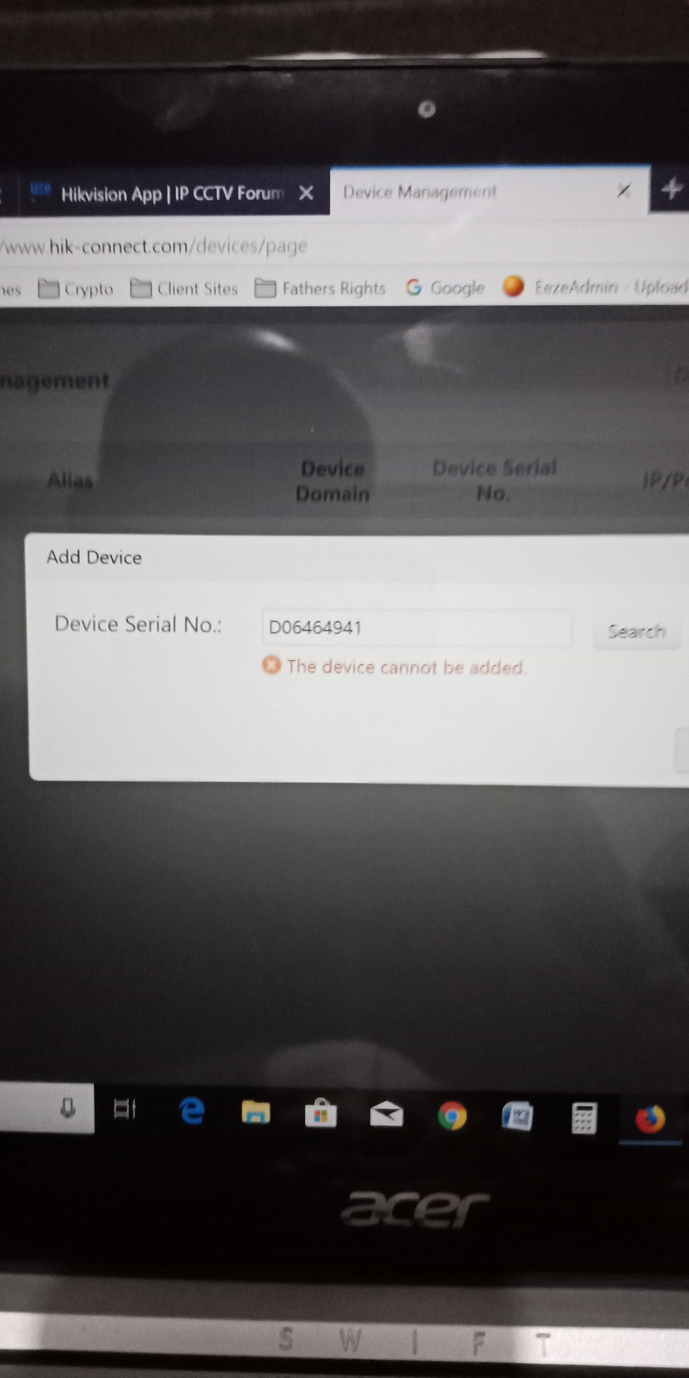

- I've created an account at HIKVISION however when I try to add the DVR to the devices in device management, it's not working. See image 1 which shows my settings screen. And Image 2 which shows the error on the online portal.
Thank you in advance for helping me with this...

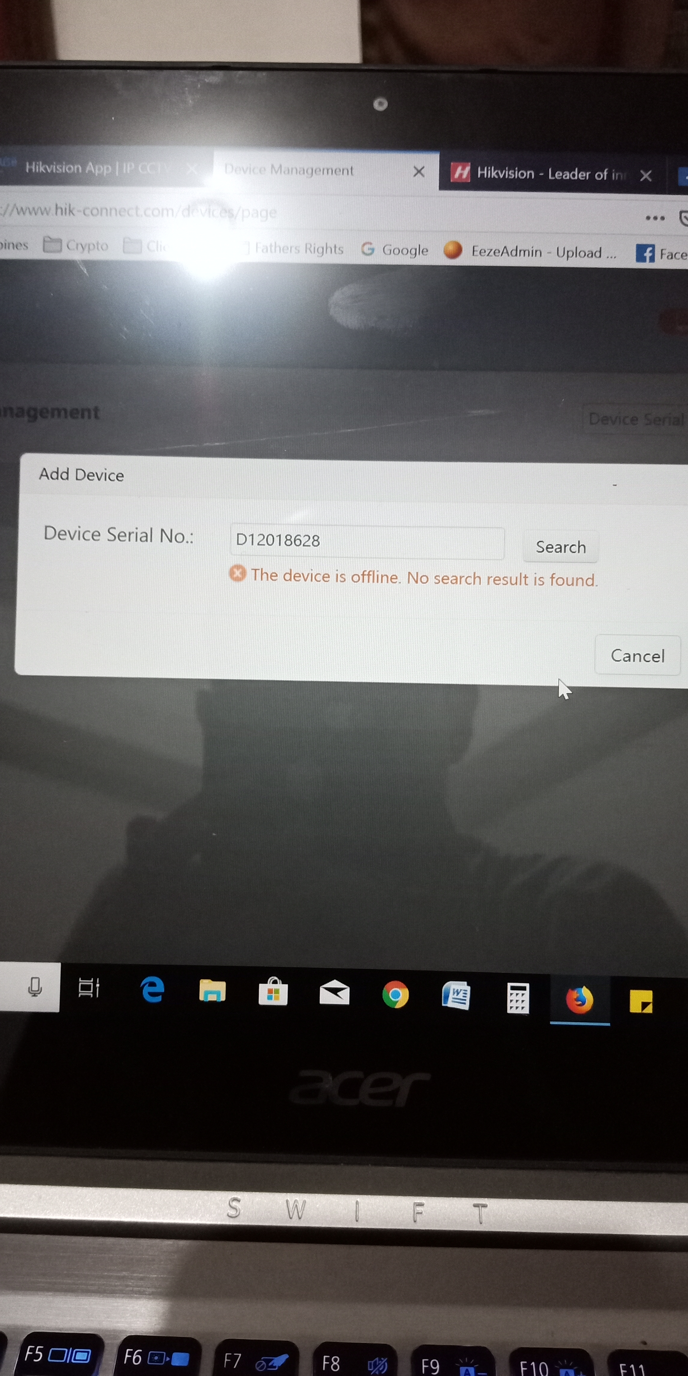

Hi Again
After reading the guide you posted, I noticed it said that if I do not have a NVR, and just a DVR, then I can just add the cameras into the online device management.
I've tried to add both, but each time I keep getting this error message. Please see attached file.

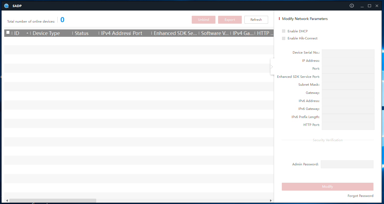

Please install Hikvision's SADP utility on a PC on your network, and share here what it finds/shows, Thanks.
Hi
Done that. Nothing seems clickable within it.
See attachment.

OK, as your DVR is not showing in the table list in SADP my first thought would be that your DVR is not connected to your home network.
Do you have a network cable connected to the LAN port on the rear of your DVR connecting it to your router?
No I don't, not yet.
As the modem is in a completely different room to the DVR unit.
For some reason I thought it would all be wireless.
Would it need to always be plugged in via a LAN cable or would this just be for the set up process?
Yes, if you want to access it from your PC, mobile phone, App, internet, etc. Then it will need to be permanently wired to your router.
