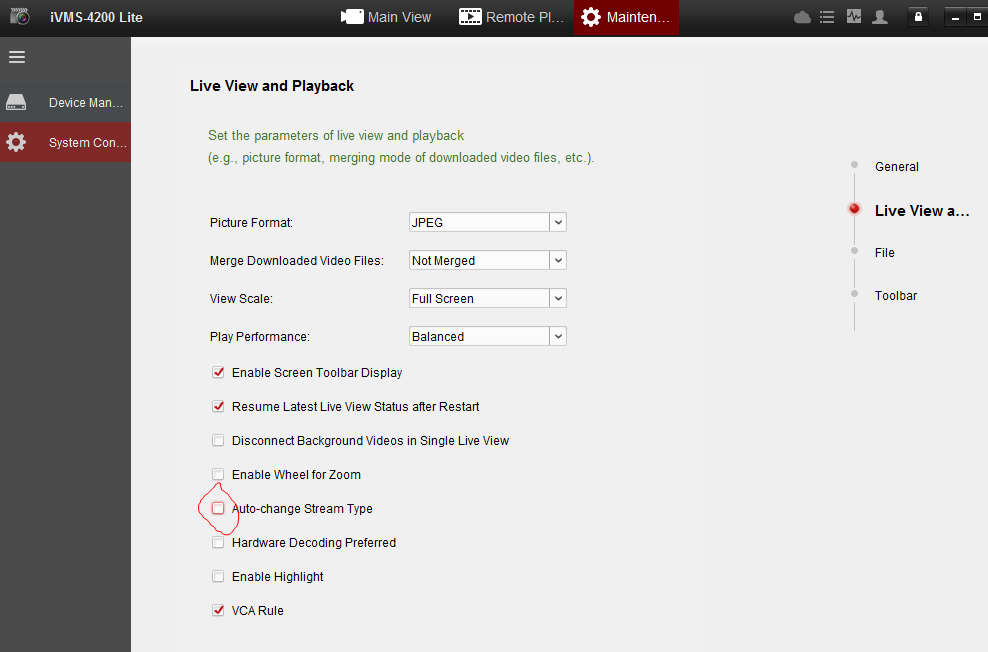

I setup some cameras and did not really pay attention to the audio/video sub-stream settings. We are using a older PC to run iVMS 4200 lite. I have some newbie questions I am hoping somebody could help on.
  • My understanding is that over 4 cameras and it will select the sub stream automatically. Is this true?
  • The default frame rate for the sub-stream was full frame rate... I suppose that was bad setup on my part as we were seeing dropped frames. I assume this should be set to typically match the main stream, 12 to 15 pfs is what I typically use with H.265.
  • Any reason to not use 640 x 480 resolution on the sub-stream?
I am hoping to use iVMS-4200 Lite for just viewing the cameras on a secondary PC. I wish the lite would allow you to select the sub-stream as the full blow version of iVMS-4200 does. It is too resource intensive for out PCs...
If there are any other recommendations to improve the performance, please let me know. Buying new PCs can not be one of them :-).
Should I look at a simple player instead - VLC or soothing. These are windows PCs. I wish there was a tinycam app for windows...
Thanks in advance for any/all help!
In iVMS-4200 lite, click Maintenance at the top. Under System Configuration>Live View and Playback make sure Auto-change Stream Type is NOT selected.

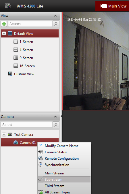

Then back in the Main View tab right click the camera and you will be able to select the stream type. Keep us posted.

Ah! Thank you very for your help. That makes perfect sense.
