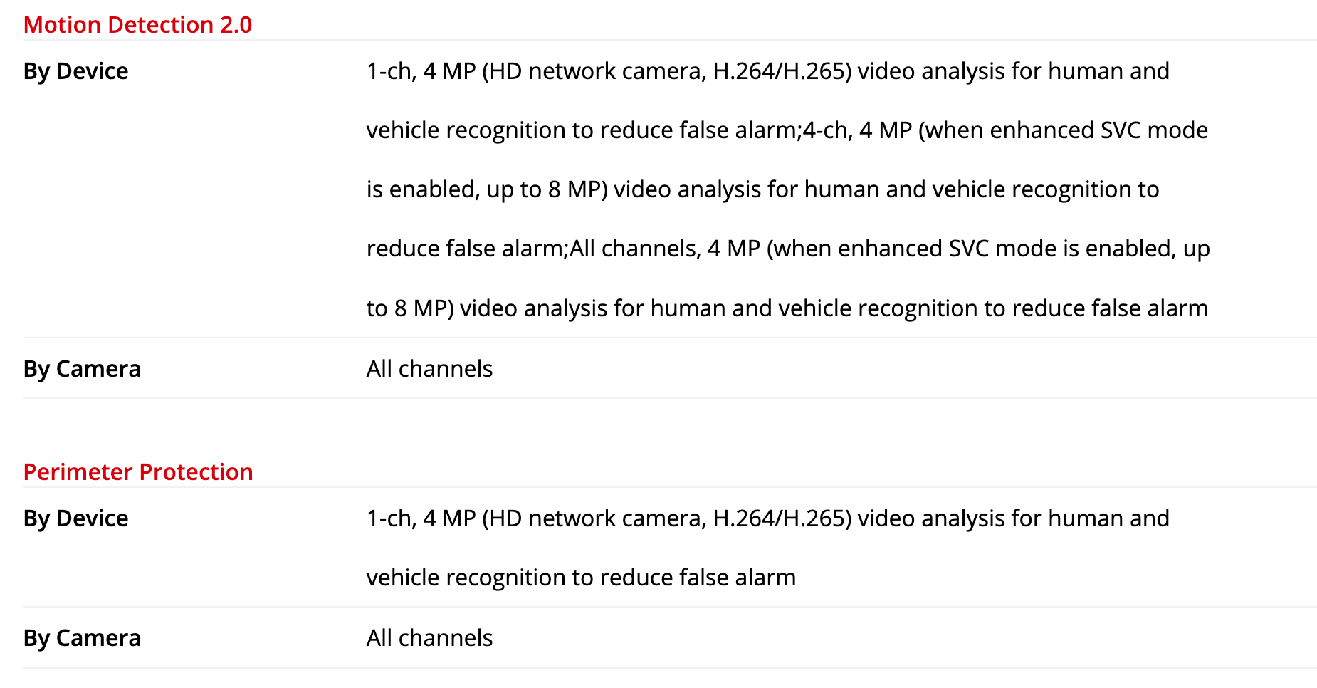

Hello Dan,
Could you provide me with a more detailed explanation of these specifications? If I were to purchase seven cameras, can I expect all of them to support both motion detection and perimeter protection, assuming they are 4 MP cameras?
To rephrase my question, this is the same NVR I mentioned in my initial post. So, hypothetically, if I were to use only 4 MP cameras (seven of them), does it mean that this NVR would only be able to accommodate a limited number of 4 MP cameras, forcing me to switch some of them to 1080p? This would potentially negate the purpose of buying all seven 4 MP cameras.
I'd appreciate it if you could also consider this in a broader context, not just limited to these specific features of motion detection and protection.
Hi @analysis_bruh
This area is confusing and even we don't understand it fully (we've repeatedly asked Hikvision to explain it to us but we have got very few clear answers from them).
But in your case it is simple, 'By Device' means the AcuSense events are being handled by the NVR and this primarily applies to non-AcuSense cameras (which is why there are some limitations on how many cameras can be set up with motion detection/smart events). "By Camera" means the AcuSense events are being handled by the camera which applies if you are using AcuSense cameras and this would be what you are doing when buying 7 new AcuSense cameras.
So with 7 x New AcuSense cameras, the events would be managed "By Camera" and you can have them configured on all cameras/channels.
