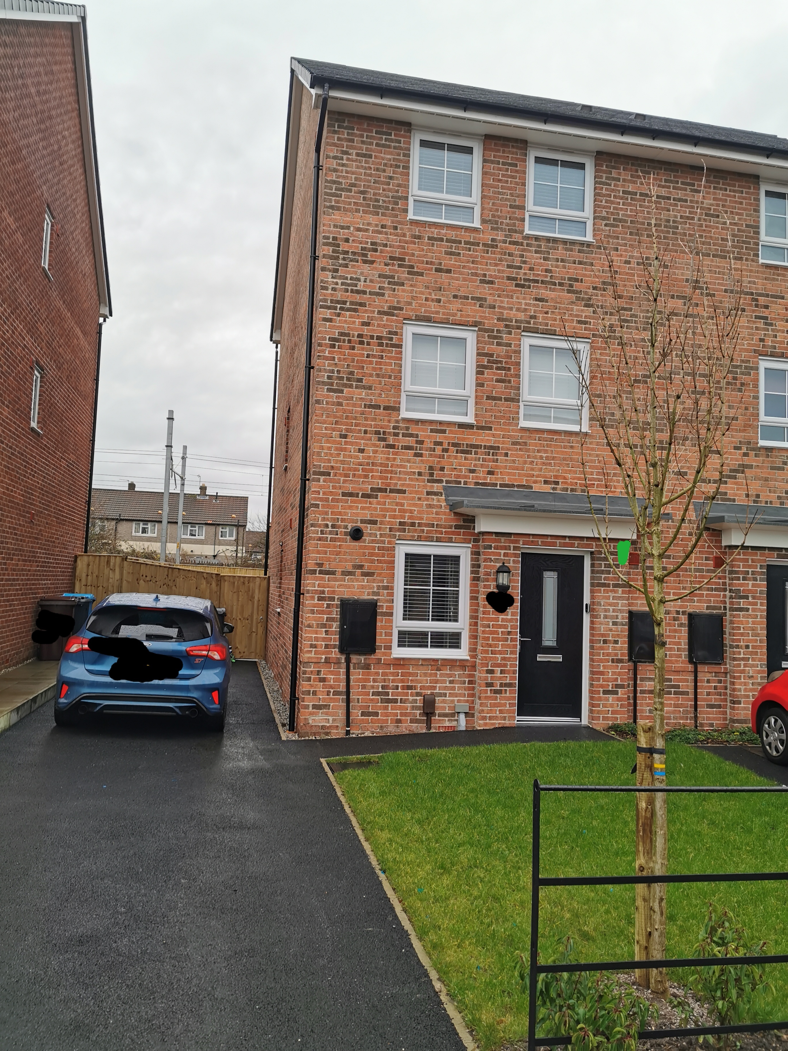

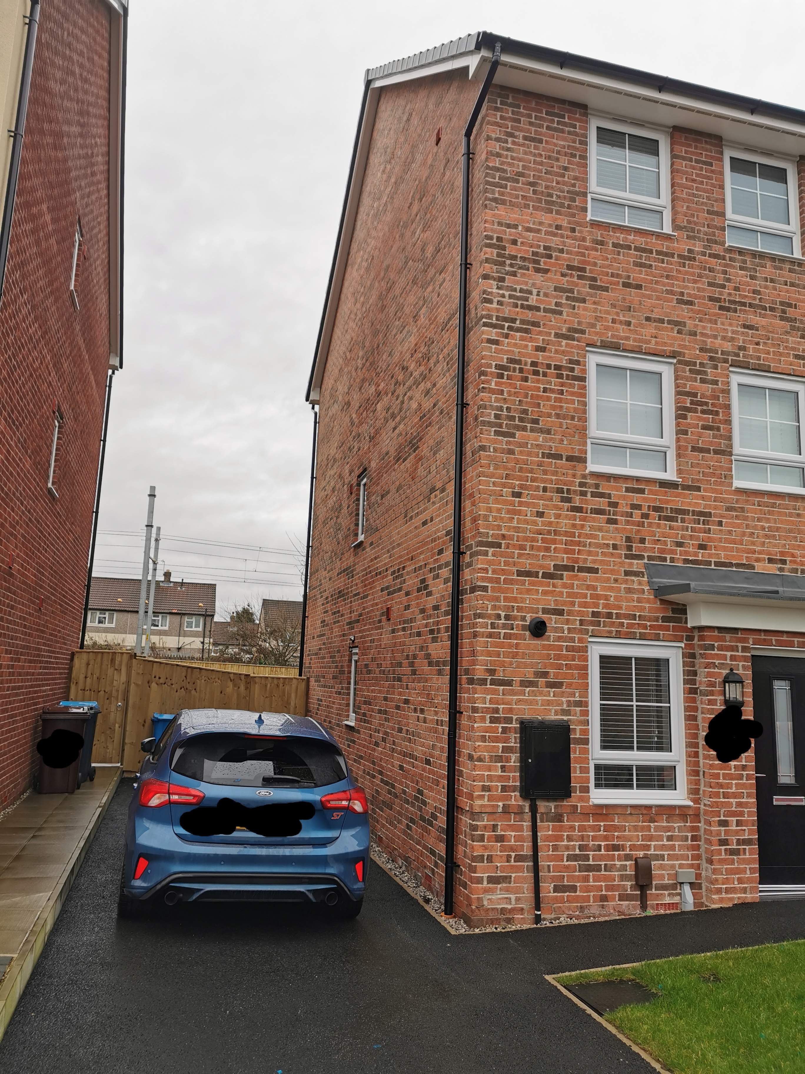

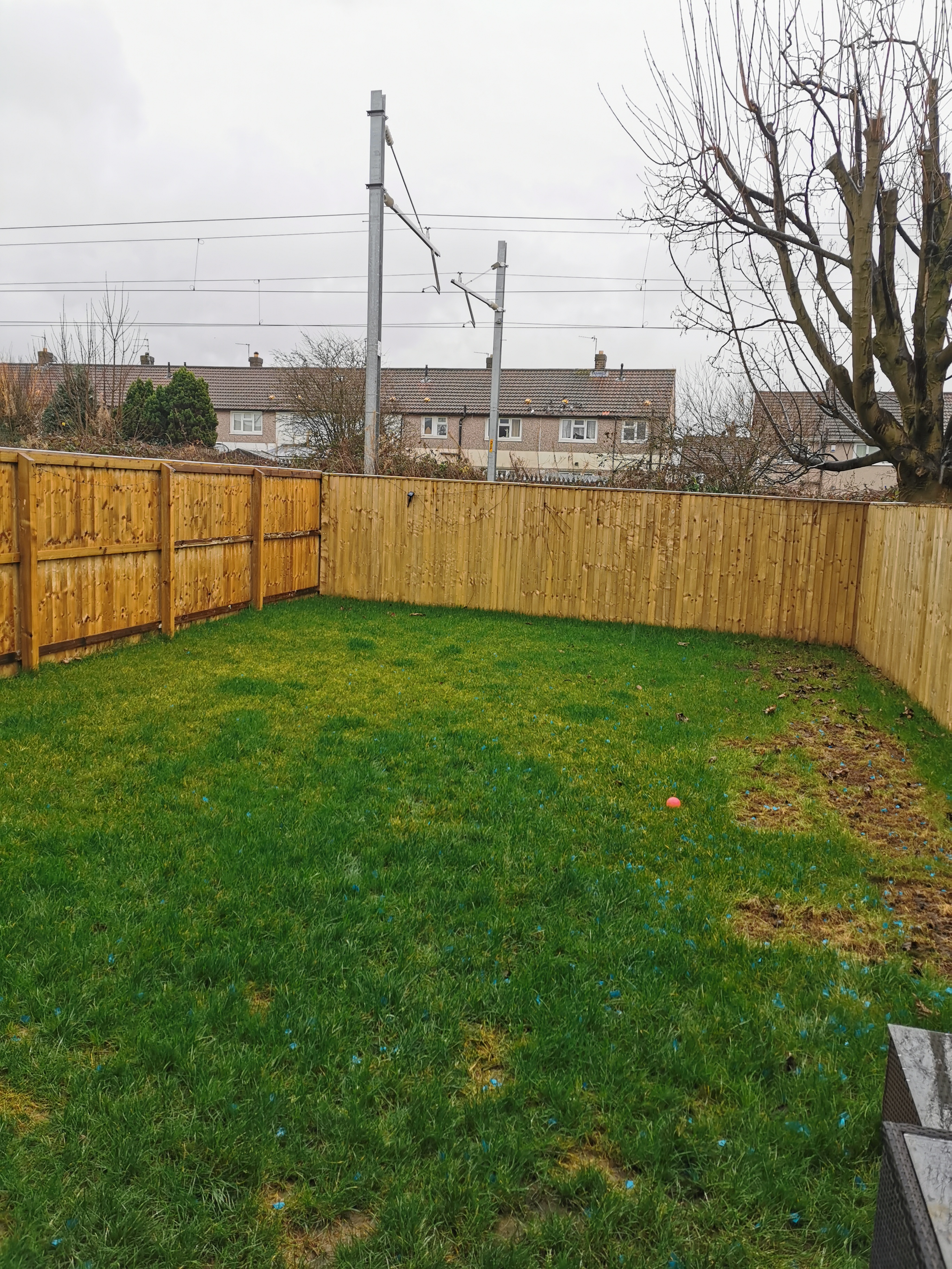

Hi everyone, I'm new to all this but I am looking to purchase my first cctv system for my home an would like some help if possible please. I'll attach some pics to try and show what I want to cover. I was thinking 3-4 4mm(not sure this is right choice) hikvision Turret cameras (ds-2cd238561-i 8MP). I need to cover the cars down the side of the house and the gate, the front of the house, the back garden/patio doors. I need to cover the back of the garden as the railway track is right behind the fence and is easy access to my garden. The garden is about 12m long an 10m wide Would one camera cover the patio doors and the back or should I get 2 cameras on the back, one towards the patio doors and one towards back of garden? Also as you can see from the pics, it's a town house style house so it's taller than usual houses so how high do you think I should place them as I presume the soffit are too high and I'd mostly get tops of heads? Also the side of the house, not sure if to place the camera at the front side of the house looking down towards the car and gate, or at the back side looking down? It's also very dark at the back at night so are the cameras I've chose good enough in very dark conditions? I'd like 24/7 recording and push notifications to my phone if there's motion. Would I need 4tb hard drive or more for 4x 8mp cameras? Sorry for all the questions, it's alot money to spend so I want to get this right.

Hi @Corky,
A 3 camera setup should be sufficient if you were happy to cover just the approach to your patio door, rater than having a camera pointing directly at it. You were right to be looking at a 4mm turret to cover the driveway/side gate, as well as your back garden/patio door approach. The turrets have a 30 metre IR range so should give perfect visibility of both the entire back garden and of your driveway at night. However, I would recommend a 2.8mm mini dome to cover the front door as they give greater detail at short range (ideal for identifying people at the front door), and only have a 10 metre IR range, which means people's faces wouldn't appear to be whited out by the IR at night as they would with the turrets. All the cameras mentioned also come equipped with Hikvision's new Darkfighter technology that will give you improved low-light images.
You might also opt for a 4 camera setup if you wanted complete coverage of the patio door. This would involve fitting a mini dome above/beside the patio door for a short-range, detailed image covering the door rather than just its approach, as well as a 4mm turret to cover the rest of the garden.
In summary, your setup would look like as follows:
1 x Hikvision 2545 (2.8mm) 4MP Mini Dome Network Camera mounted at head-height, to the right of your front door.
1 x Hikvision 2385 (4mm) 8MP IR Fixed Turret Network Camera fitted above your gate, about 3 metres high, covering the driveway and gate approach.
1 x Hikvision 2385 (4mm) 8MP IR Fixed Turret Network Camera fitted to the left of the patio door, at the same height, covering the entire garden and patio approach.
(Optional) 1 x Hikvision 2545 (2.8mm) 4MP Mini Dome Network Camera fitted to the right of the patio door, at head height, covering the entrance directly.
You will also need an NVR to connect your cameras to. A Hikvision 7604 (4 channel) NVR will do you fine (4 channels allows for 4 cameras.) However, if you wanted the option to expand your setup beyond 4 cameras then you will need an NVR with more channels - eg. a Hikvision 7608 (8 channel) NVR). We always recommend matching the manufacturer of cameras to that of the NVR to ensure full compatibility and access to all of the cameras' features.

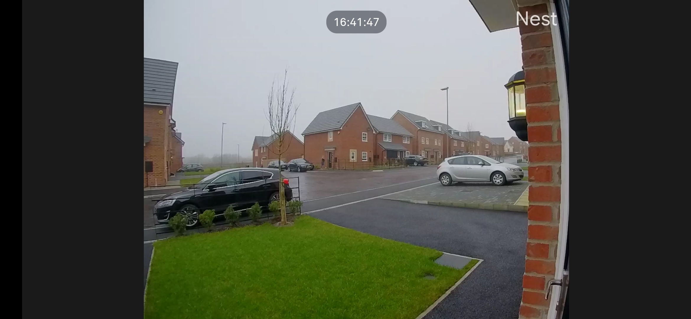

Thanks very much for your great reply, that's really helped. Can I ask would the mini dome on the front door be good enough to cover the car parked at the front on the pic I've attached to this post aswell or would you recommend a 4mm Turret on the front of the house for that? Sometimes we don't have both cars on the driveway you see and I'd like to cover that area too? I have the Nest doorbell covering the door at the moment but the notifications aren't reliable enough and sometimes delayed or don't come through at all, are the Hikvision notifications quick and reliable?

No problem - you're very welcome. A mini dome on the door should be fine to cover the car you're talking about as the distance between them isn't huge. The resolutions of the mini domes are typically twice that of the Nest cam you've got installed, so if you wanted an idea of how the picture would look it would typically be twice as sharp as the one you're currently getting. The 4mm turret I suggested you fit to the side of the house (above the gate) would cover the cars in your driveway and the section of road directly in front of it; so with that and the mini dome on the door all of your parking spots should be covered.
Re. the Hikvision notifications, we have had some reports of issues with the reliability of notifications they give. However, this is normally dependent on the complexity of the scene recorded and the event settings selected. It looks like a nice quiet road so I wouldn't imagine the complexity of the scene being an issue and finding the right event settings are normally achieved through trial and error (e.g. motion detection works perfectly for some while like crossing/area intrusion suits others better.) Once people find their best suited setting they rarely have any issues with notification reliability and speed. Hope that makes some sense and has cleared things up a bit!

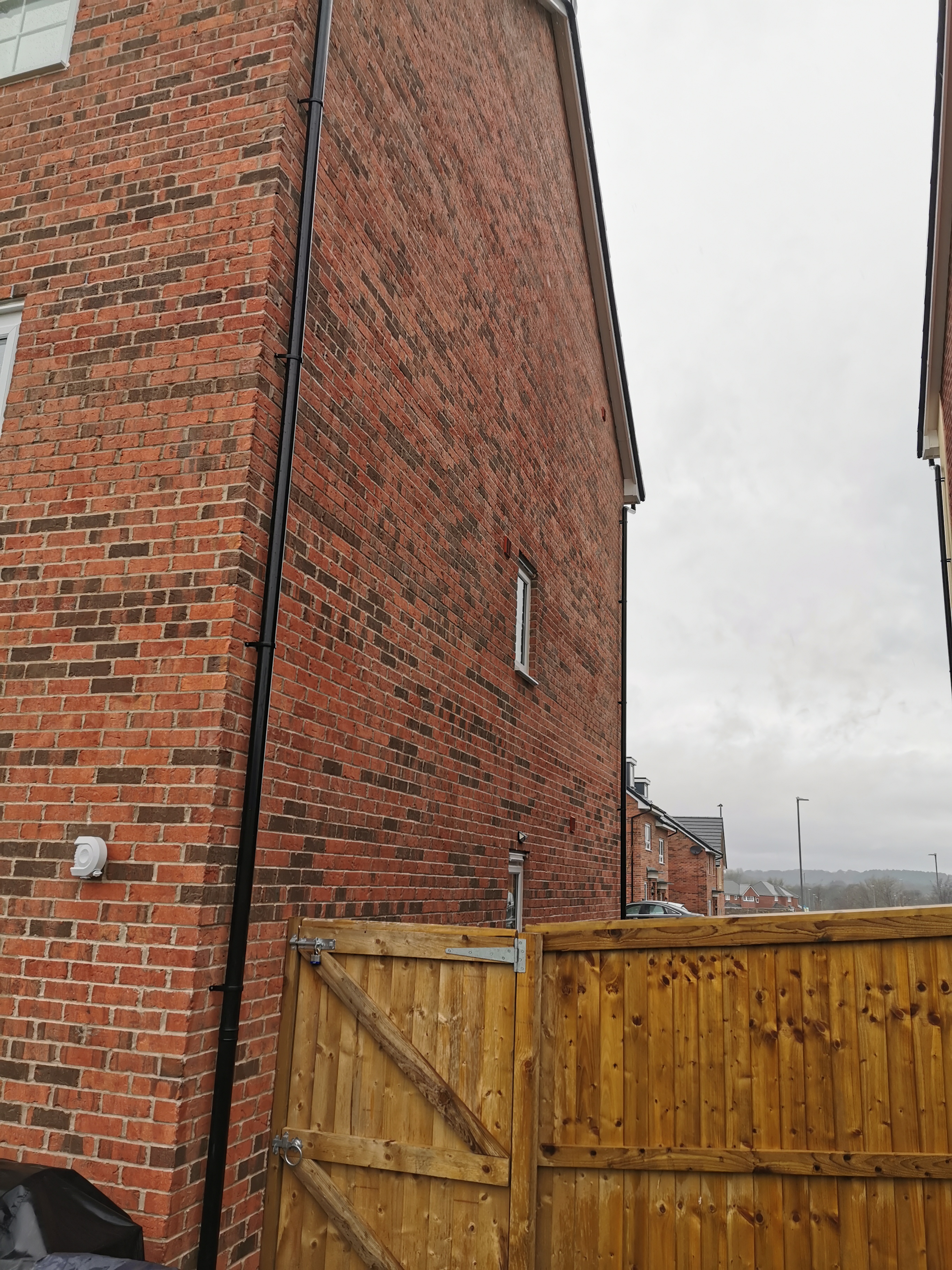

Thanks alot, for the Turret on the side of the house, would I need some sort of bracket or will it be OK attached straight to the wall? Thought I read something about ir glare on the wall if pointing down the side of a house, I may be wrong though? Would 2tb hard drive be enough for say 10-14 days recording aswell for the 3-4 cameras you've suggested?
Most people manage fine with mounting the turrets directly to the wall, although there are options to mount them on a bracket (which would help with eliminating IR glare from the wall as it allows you to mount the camera further from it) or a junction box. If mounting the cameras without a junction box, to ensure your connections are weatherproof, you need to be sure that the wall is less than 30cm thick and that you're happy to drill a 3cm hole through it so that the cables in the back of the camera fit through it correctly. Using junction boxes means the mounting wall can be thicker and the hole smaller, as it means you can pass a thinner cable through it. The thicker section of the cable is housed in the junction box and connections are all kept completely weatherproof.
You're right to think IR glare from walls can be problematic but I wouldn't be too concerned about it. You just need set the viewing angle of the camera slightly away from the wall so that as little of it as possible is in its field of view. A slight adjustment to the viewing angle will still mean the frame should cover everything you need to in the driveway.

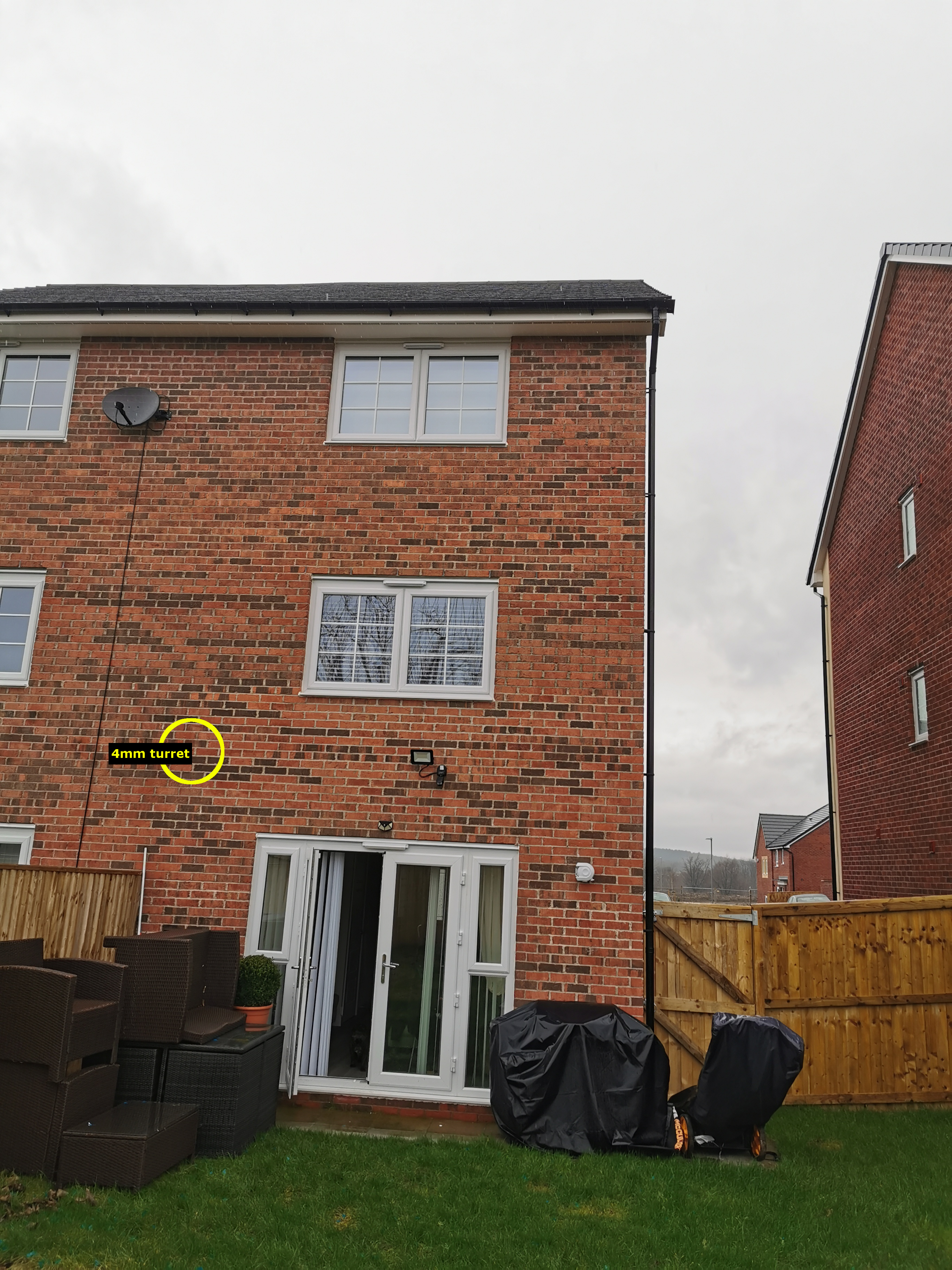

Thanks again for your information/tips. Do you think a 4mm Turret would work in the position I've marked on the picture attached? Just last night we had someone trying the car doors/front doors in our road and they walked from the direction I've marked. Not sure I would of got a decent look if the mini dome was to the right of the door because I only got the back of him on the Nest doorbell.

No worries, hope it all makes sense and sorry to hear that - it's understandable why you would want the cameras! A turret on the position that you've marked wouldn't have any real benefit as the only coverage it would give that the other camera's wouldn't already is of the front lawn and main road and so the gains of the new camera wouldn't justify its cost. If you wanted it to cover the front path then you would be pointing it downwards which would only leave you with the top of people's heads. Furthermore, the 30m IR range on the turrets would be too long for use here anyway and would probably result in whiting out in the image. This new position will not give you any greater coverage, especially at night, than the system already recommended. The only thing I would maybe suggest is mounting the turret on a bracket to give you the extra coverage of the full length/width of the driveway (as it would be positioned further from the house and more central to the drive.) The mini dome would probably be mounted higher than your Nest doorbell is, meaning it would cover more of the front door and it's therefore unlikely you'll only catch someones back as you did last night.

Don't think it could go higher than the green mark I've made there because of the porch above the front door. Is that where you mean to put the dome?

Re. the camera position, yes that's where I meant to put the dome. These are mounted at about head height in order to capture people's faces, rather than at chest height which I assume the Nest is? I'll mark up where I suggest putting the cameras on the photos in a moment so you can see what I mean.

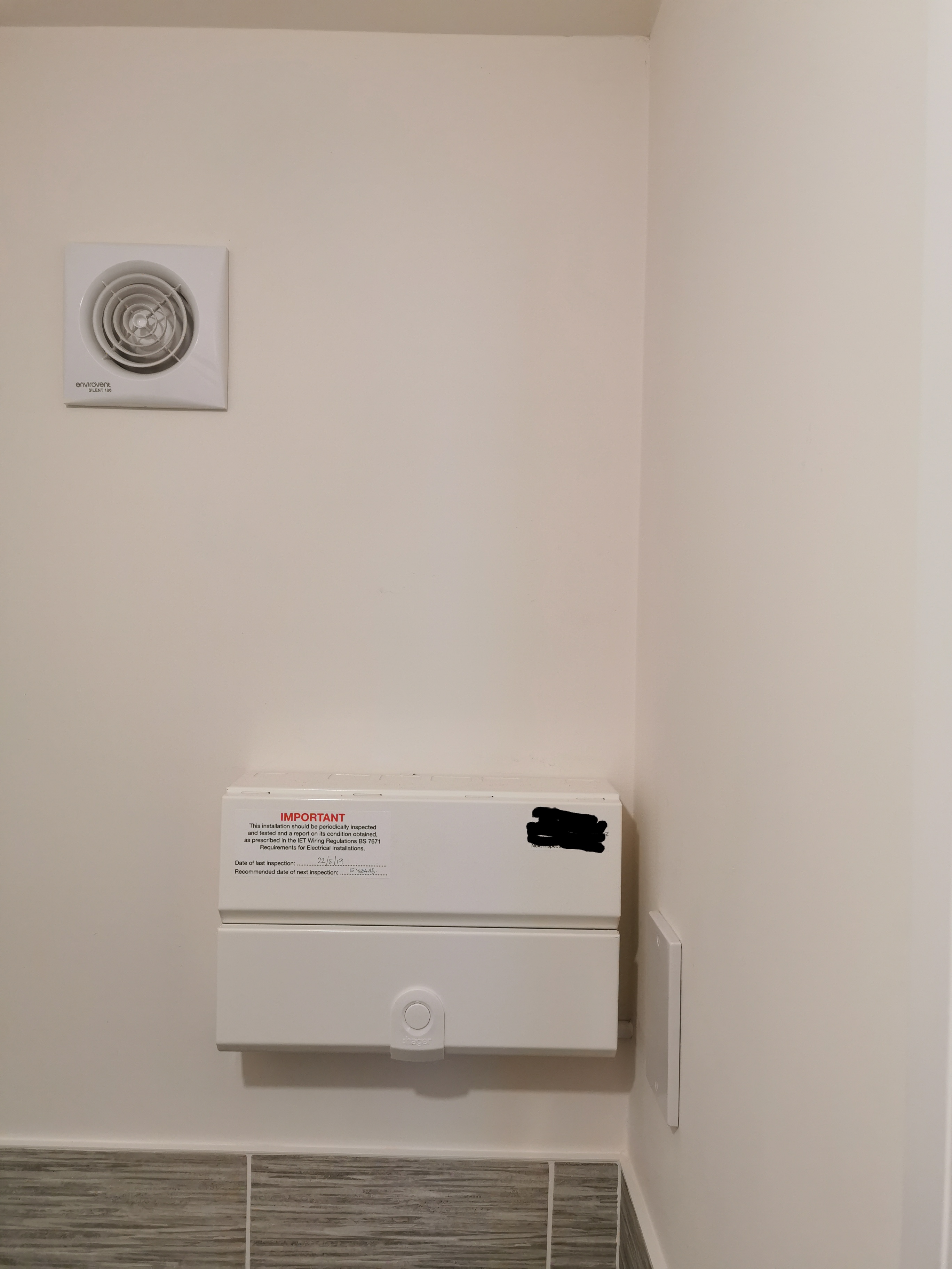

Directly behind where the mini dome will be is a toilet an the electrics are in there aswell, don't know if that'll make any difference

As long as your installer knows what they're doing and takes care not to drill through any cables in the wall (seems obvious I know), then you should be fine.
