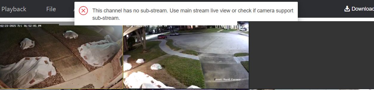

This is on a fairly new (to me) DS-2CD2387G2-LU on 5.7.19. Hooked to a 7608 I-series on 4.61.020. Out of the blue, with no changes on my part, I am now getting this message when doing the 3x3 live view. My other 7 cameras are fine. In camera management live view works just fine, as it does in HikConnect. Just live view via web interface is giving this error, no matter if I have it on substream or main stream. If I do single camera view via web interface, main stream does work but substream still does not work.
My settings in the camera re: substream resolution, frame rate, etc. are idential to all my other cameras. I've rebooted the camera, rebooted the NVR, nothing seems to work. Another interesting thing is that using web view and going into smart events, the feed works just fine.
Any ideas what to look for to fix this?
After reading the comments by @JB1970 in this thread:
I downgraded this troublesome camera from 5.7.19 to 5.7.15 and it completely fixed the problem. No idea why. When I reloaded 5.7.19 it went back to the same substream problem, so maybe this is another bug in that firmware. So tired of all the problems with these 2387G2's....
