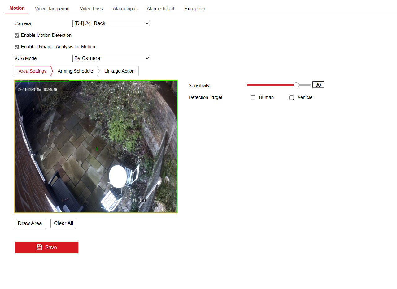

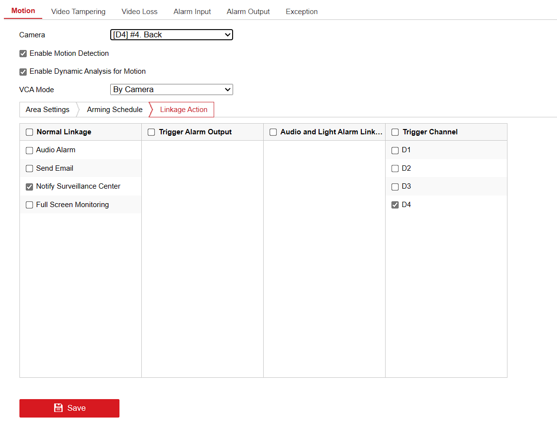

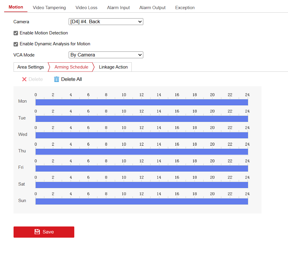

I'm trying to tweak my current setup so that I have motion detection triggering constantly in the background tagging relevant motion events of the whole camera area so that when I log into the web GUI I can then quickly see where motion was at say 2am when I was asleep. At the same time I have setup intrusion detection in areas where I immediately want notifying.

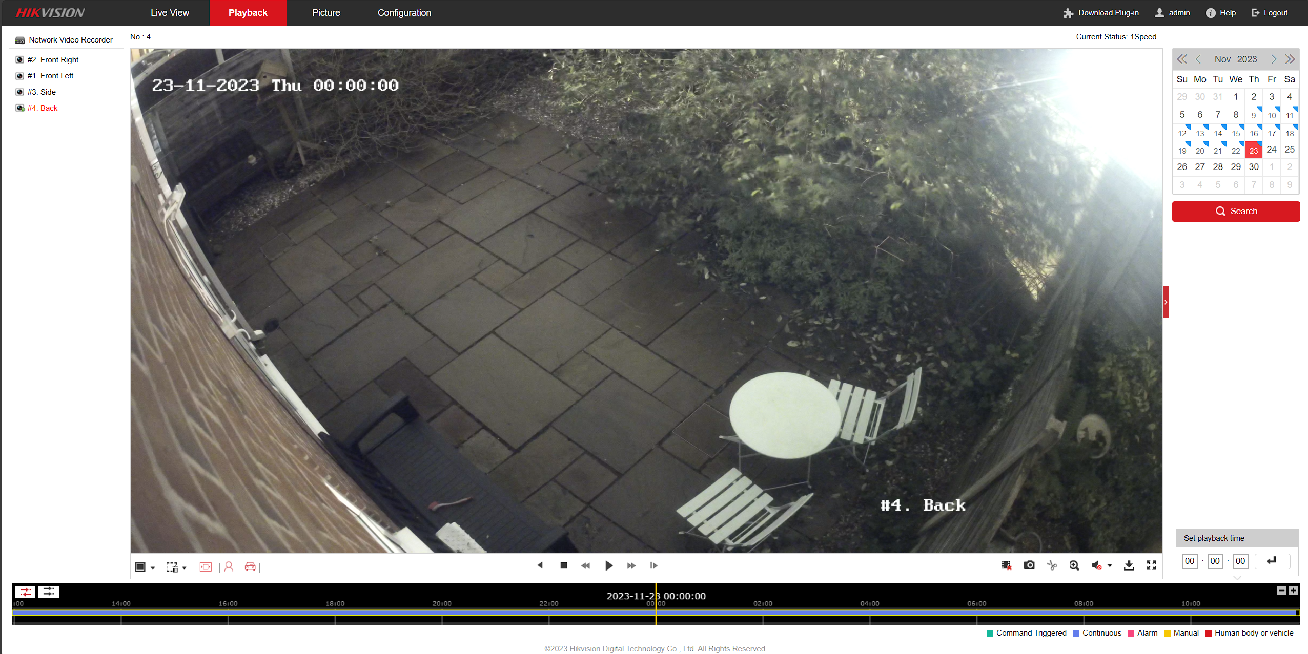

At present Motion detection is setup as follows but as you can see in the final picture during playback no motion event are tagged even though (I think) all the settings have been correctly ticked.
Am I missing something obvious?

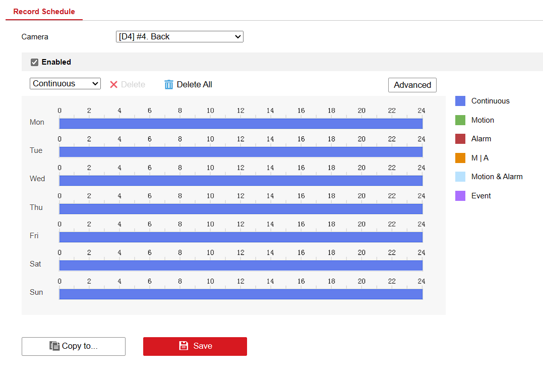

Hi @mattyc491
Unfortunately, it is not possible when using the browser GUI to get event markers in the playback timeline when recording continuously. This feature was supported several years ago but was removed by Hikvision because they claimed it made the browser access unstable.
If you want to be able to playback event triggers quickly, the best thing to do would be to get the NVR & camera added to the Hik-Connect mobile app which can receive event notifications and allows you to scroll through past event triggers.
