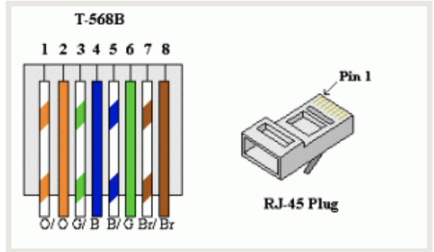

in a cat5 cable the blue pair and brown pair are usually not used, I've used these for dry contacts etc. I split these pairs out into another socket.
You can do the same for cat6 and higher, bear in mind this could affect the characteristics of the cable and reduce the overall data rate.
rj45 pins
1, 2 data / poe
3, data / poe
4, 5 free, usually telephony analog phone line. can be poe. check
6 data / poe
7, 8 free can be poe. check
