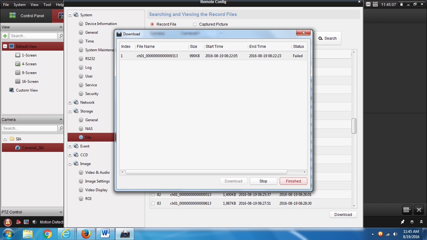

i think I found the place to download the files to my computer but it keeps on saying failed. what could be the solution to this?

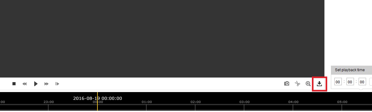

how do i take certain video footages from the sd card and save it in my computer with out removing the sd card?
If you access the camera via a web browser, navigate to the Playback section and click on the download button, bottom right of the viewing area.
I've attached an image to show where it is.
