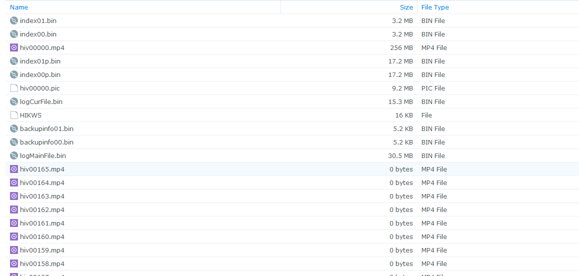

I have managed to set up the camera to record to my nas drive with motion detection. All I can seem to find is one mp4 file that's always 256mb and only part of it plays in VLC until it just stops after a few seconds. I have tried to use the hikvision IVMS 4200 software to play them but it doesn't have an option to actually open a file. How can the files be played properly

I would try Hikvision's own VSPlayer
Some customers have experienced issues playing back files compressed with Hikvision H.265+ CODEC because this is CODEC is unique to Hikvision and is not fully compatible with most video players. You can also try using Hikvision's Format Converter to change the files you want to share with others to more standard formats. (.mp4/.mov/etc...)
