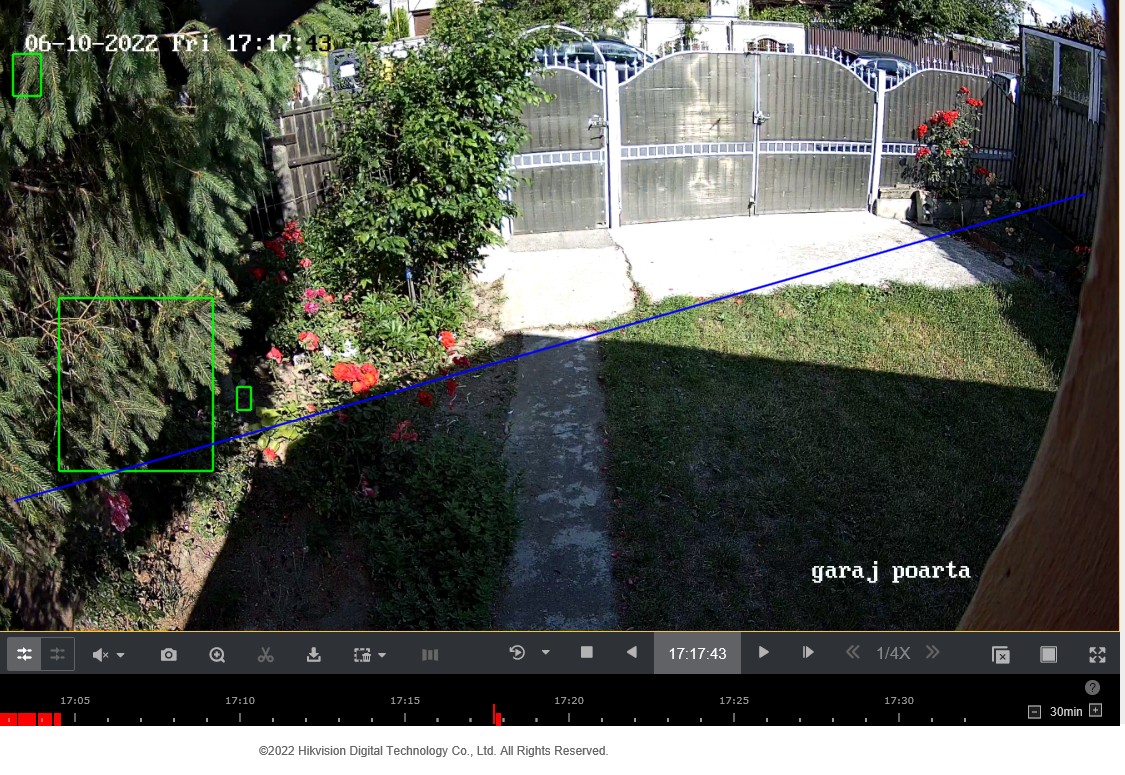

I would like to see in the playback timeline only those configured smarts events and nothing else.
So, using the NVR Web interface, I've disabled Motion and enabled only Line crossing and Intrusion Detection.
For the camera, Arming Schedule is 24/7 and NVR Storage Schedule Settings is Event during 9 AM - 5 PM.
On the NVR event Linkage method for this camera is Send Email & Notify Surveillance Center.
So, I do receive e-mails when line crossing or intrusion detection is triggered, I also receive those events on my mobile Hik-Connect application and I'm able to play them BUT, on my PC, using the NVR web interface, on playback, I see a lot of other events, marked with RED blocks. It seems it is a sort of motion event registered although Motion is disabled.
It is very hard to search through all those red blocks and find the real smart events, I could check the email and see the timestamp then search on the Web interface but this is not convenient.

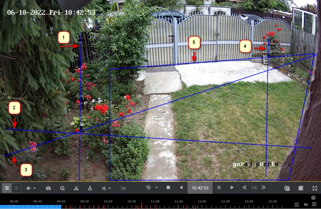

Hi @aureliandan
Can you share a screenshot of what you are seeing in the playback timeline?
Are both your smart events overlapping in the live image? Can you share screenshots of your line crossing and intrusion configuration?

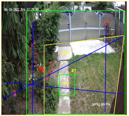

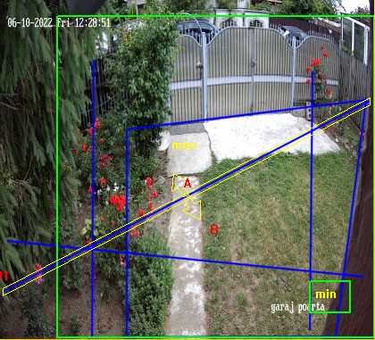

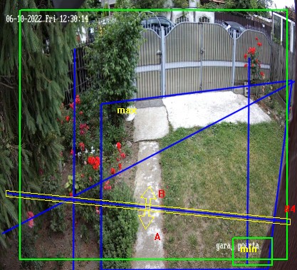

I would mention first that this is a test configuration to see what is the best method to configure smart events to catch as many scenarios as possible. As you can see in the the first image, there are 4 line crossing (1,2,3,4) and one intrusion detection (5). On the bottom of the playback window all those red marks are registered events although only two smart events were detected and I received e-mails for them. I have continuous record until 9 AM then record only Events.
Line 4 was added as it seems intrusion detection does not work on that region, perhaps is to far from center
Looking now at the configured events, besides Line crossing and Intrusion detection I have also "Scene Change Detection" enabled with 50% sensitivity. Could be from here ? Although what I understand is that we should have a major scene change in order to trigger this event.

I think the issue is too many events in such a small scene, the NVR/camera can manage multiple events but when they are very close together or crossing over each other like you have them set up this can cause issues.
The reason you are seeing quite large blocks of red event recording is that even when a slight movement happens in that scene it is likely going to trigger 2 or 3 of those lines/intrusions that you have set, when several events are triggered so close together the NVR doesn't have any time to stop recording and those 2-3 events are squeezed together into one large block of recorded footage.
This is also likely why you are not seeing many event notifications because if too many different smart events trigger close together the NVR can get confused and know what event to notify you of.
If you want to test whether intrusion or line crossing gives you the most reliable triggers then we would recommend testing them one at a time.

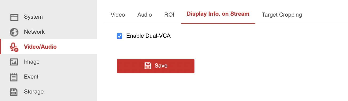

The likely reason that you're seeing indicators for both configured events AND smart events is that you have 'Enable Dual VCA' ticked in the camera menu (it is enabled by default). If you're happy with how you have your 'real' smart events configured, you can switch it off on each camera as shown below:
That should mean only your configured events show as markers. Having Dual-VCA enabled allows you to retrospectively search for a line crossing event, that differs to what you have pre configured. However if you don't need that facility it can be switched off.
1. I've disabled "Enable Dual-VCA" from the NVR and I've checked also on the camera interface was also disabled.
Same behavior, red blocks were marked on the playback timeline on the NVR web client for all scene movement.
Based on the documentation:
"Dual-VCA is used for adding VCA information to the stream. When you use the smart playback function in playback, the device can analyze videos that contain motion, line, or intrusion detection information, and mark them in red"

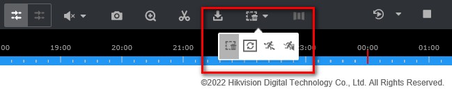

I thought this will mark the event in the timeline if I have for example continuous recording. They say "when you use the smart playback" but I don't see that option in the browser window. I see only an option to mark those events in the timeline but that didn't work.
2. I've disabled all smart events (there are also no basic events enabled) -> no motion registered in the playback timeline (that was expected)
3. I've enabled a small line crossing smart event on an area without trees or movement (Human checked) -> no motion registered in the playback timeline (now that is promising :) )

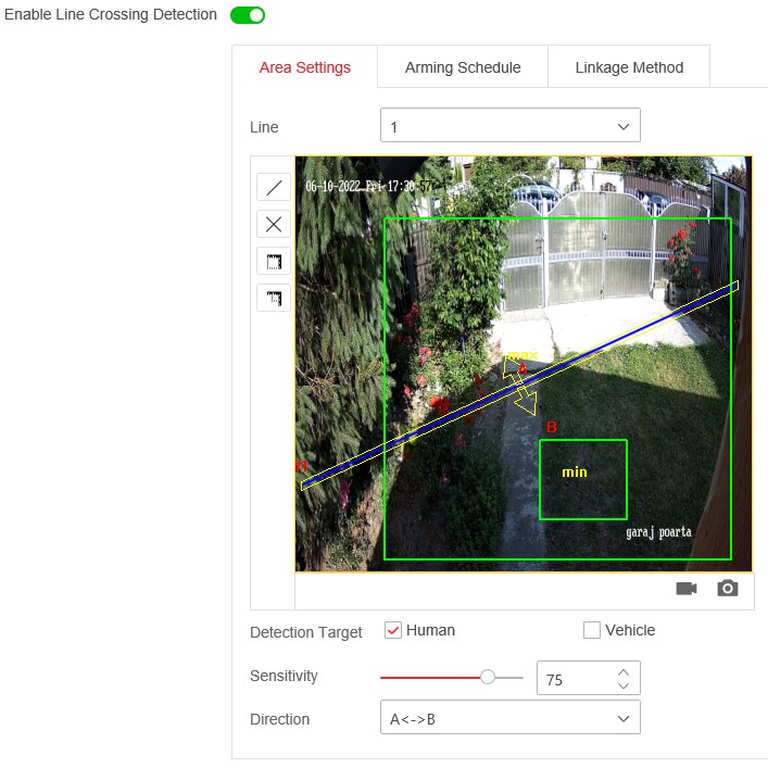

4. I've expanded the line to cover a few moving branches (no MIN MAX boxes specified on line crossing definition only Human checked)-> a lot of moving events were registered in the timeline, almost a continuous red bar
5. I've added MIN and MAX boxes on the line crossing definition (Human checked) -> now I had only one or two events registered and I've noticed that these events were triggered when the movement was larger than the MIN box. See below the definition of the smart event MIN and MAX boxes and in the next image when the event was registered the motion area was larger than the MIN box
So, the NVR knows when a real event is triggered as it send me an email and also I see that event in Hik-Connect mobile application. I don't receive e-mails or push notifications for the other events registered in the NVR web playback timeline and sincerely I have no clue what to configure so that I get rid of those motion events that are not considered real smart events with human detection.
