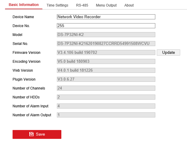

running on a very old build v3.4.106 build 190702
By going through firmware files available here I believe, this is a K2 series model.
However, I noticed, the parent directory specifically mentions 76,77,86 NI-K2,K3,K4 with an absence of 7P

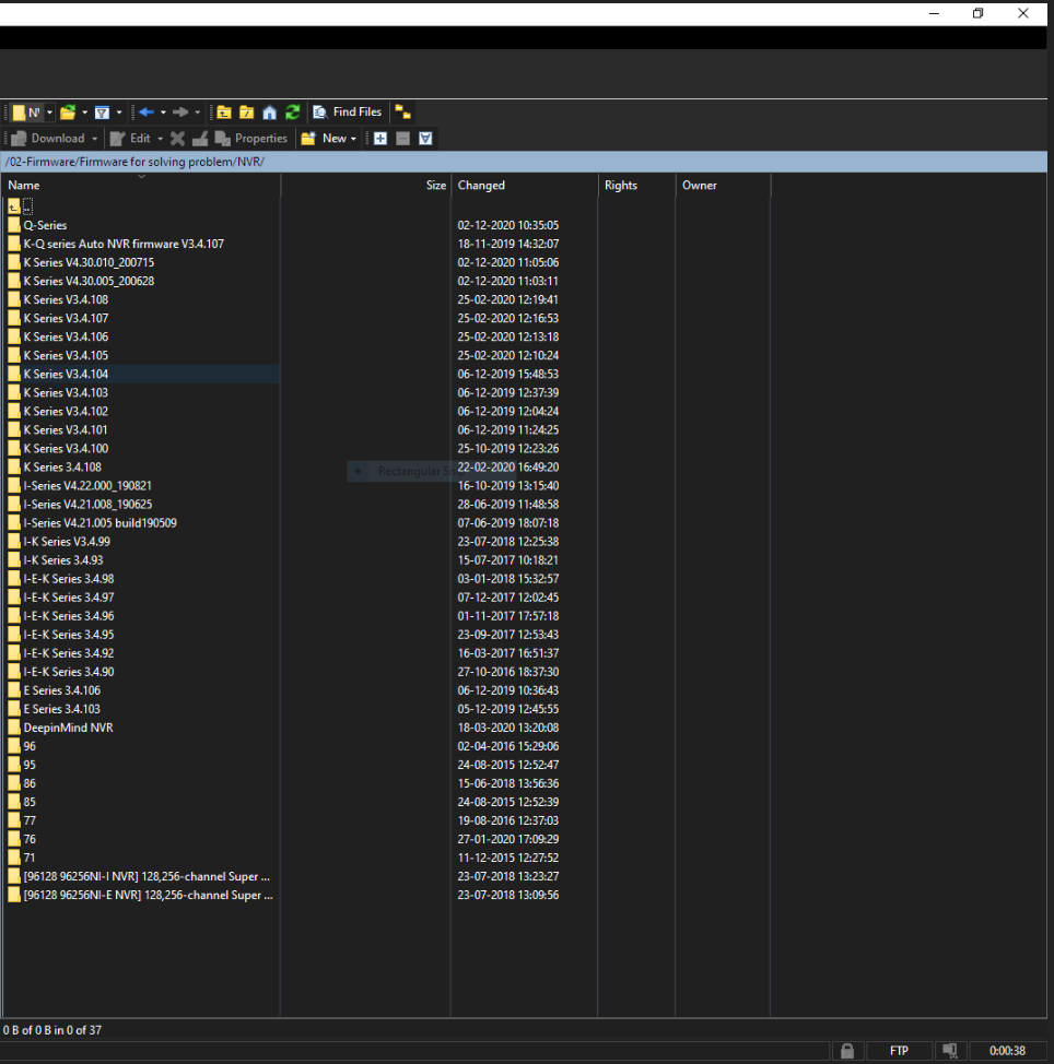

Thank you for your reply. I was just informed by Prama-Hikvision India via email to upgrade to v3.4.107-190927 which they suggested to me to download from their private FTP server.
Interestingly, upon calculating the SHA-256 of the one I downloaded from their FTP server and the one available publicly on hikvisioneurope.com/portal here, they came out to be the same.
Does, this mean am I free to upgrade to newer firmware offered for [76 77 86 NI-K2 K4 K8] for my 7P series as well? Their FTP server also lists other versions for K-series (screengrabs attached)
If yes, can you please suggest a safe path for incremental updates?
