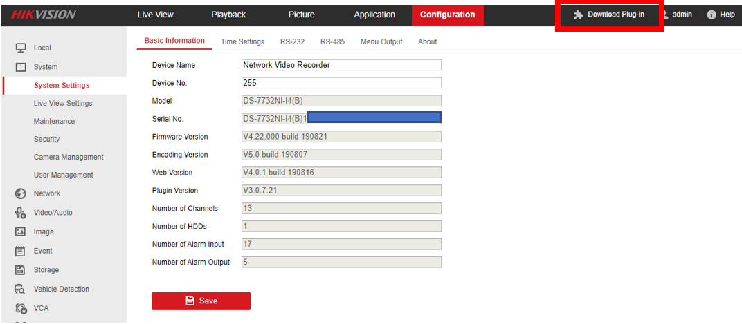

The NVR GUI (directly connected to TV or monitor) should be radically different if you came from ver3.
The webGUI will look similar. With Chrome, download the LocalServiceComponents plugin seen here:
Close all browsers and install it.
That may enable features not available in IE11.
