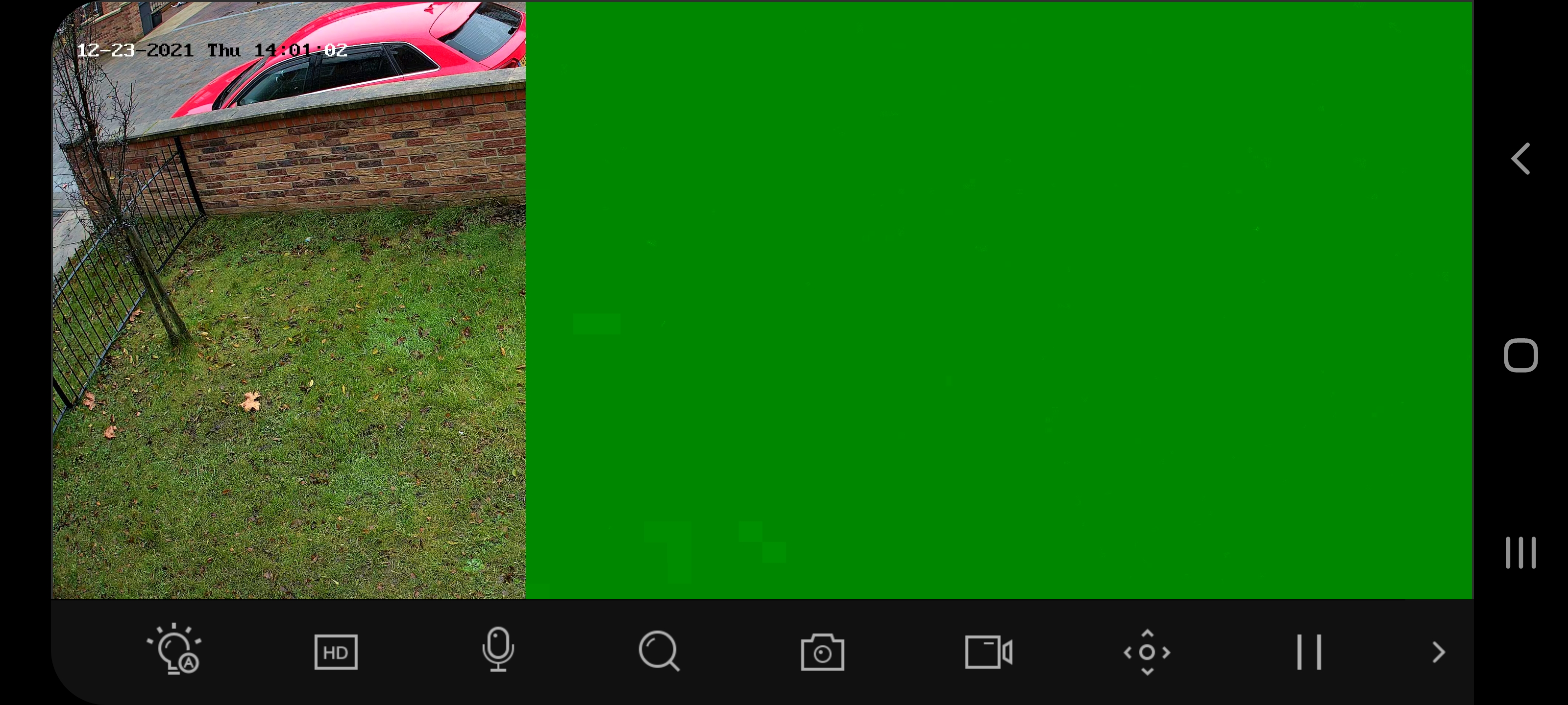

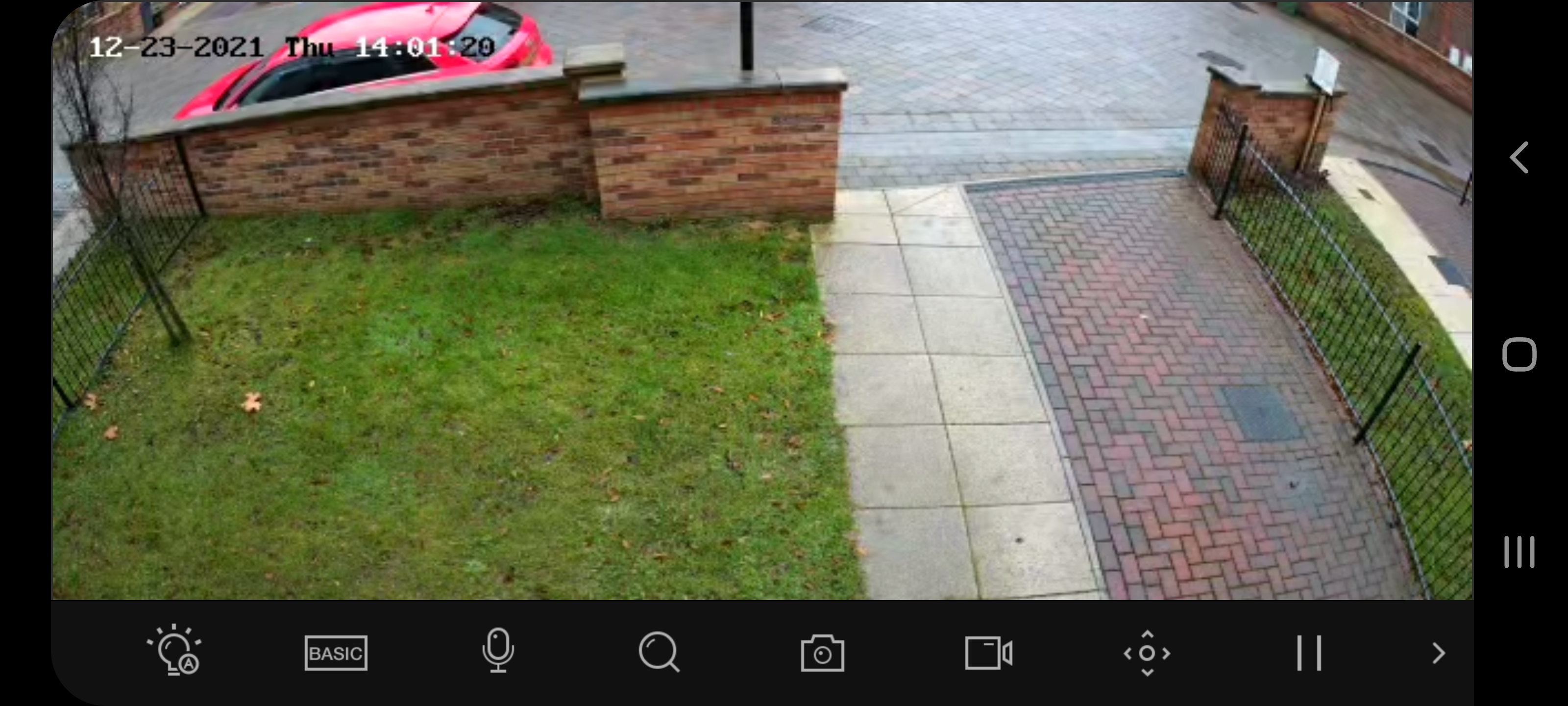

Small issue. My camera is up. I can view it on the app in basic. But when I press HD the image gets a large green block over it

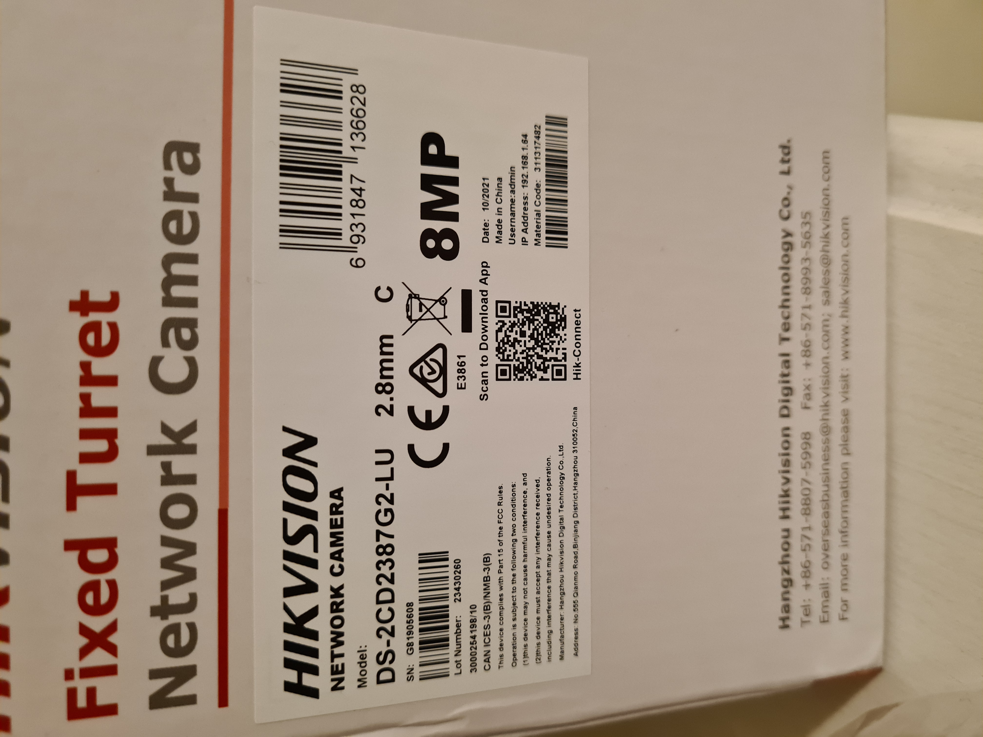

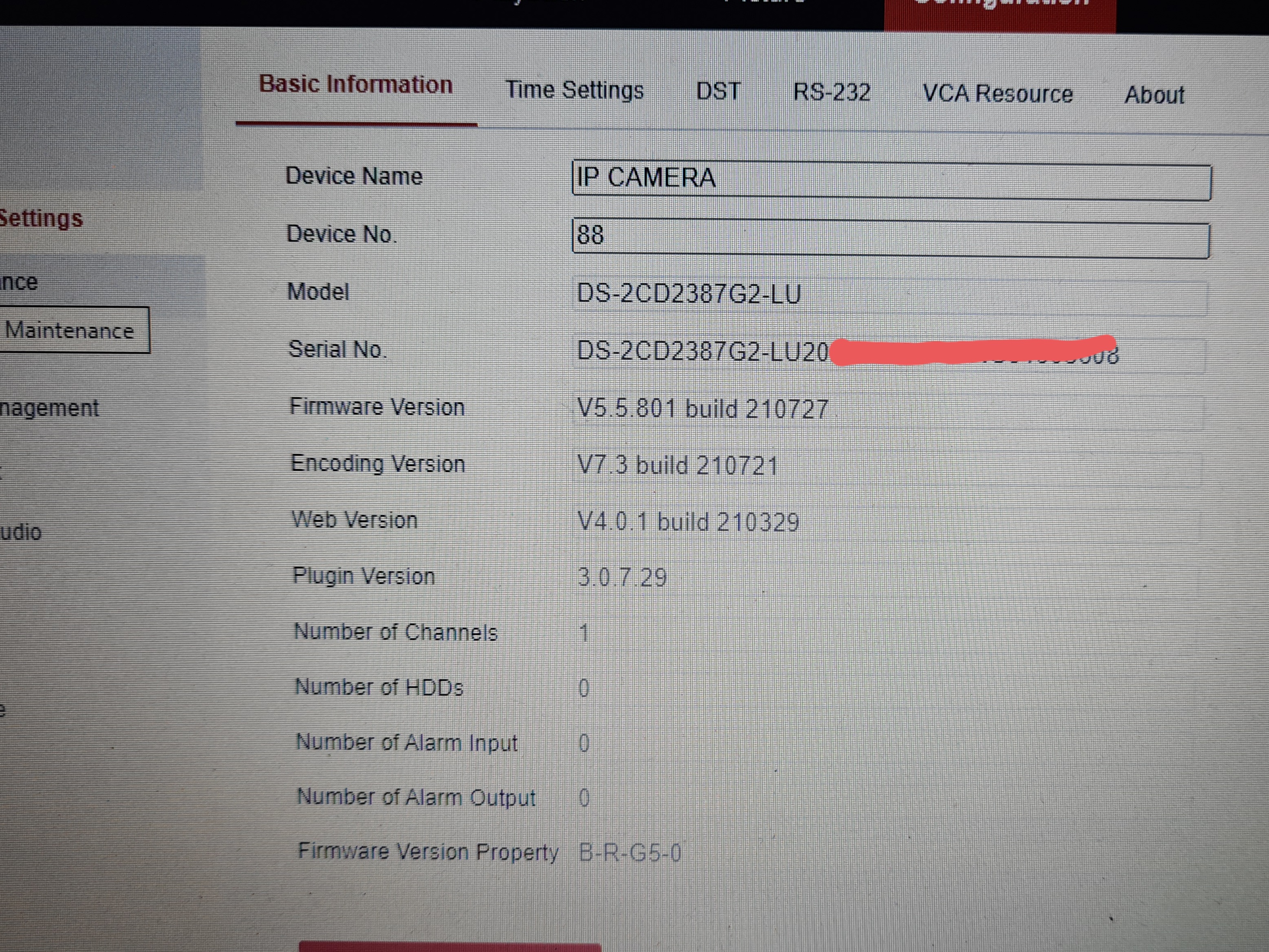

ok, which camera model is this and what firmware version is it running?
Will have to check version on laptop.
Here
Thanks @Vauxfan
The latest firmware for that camera model is v5.7.1
I would try updating the camera and see if this clears the issue in the app.

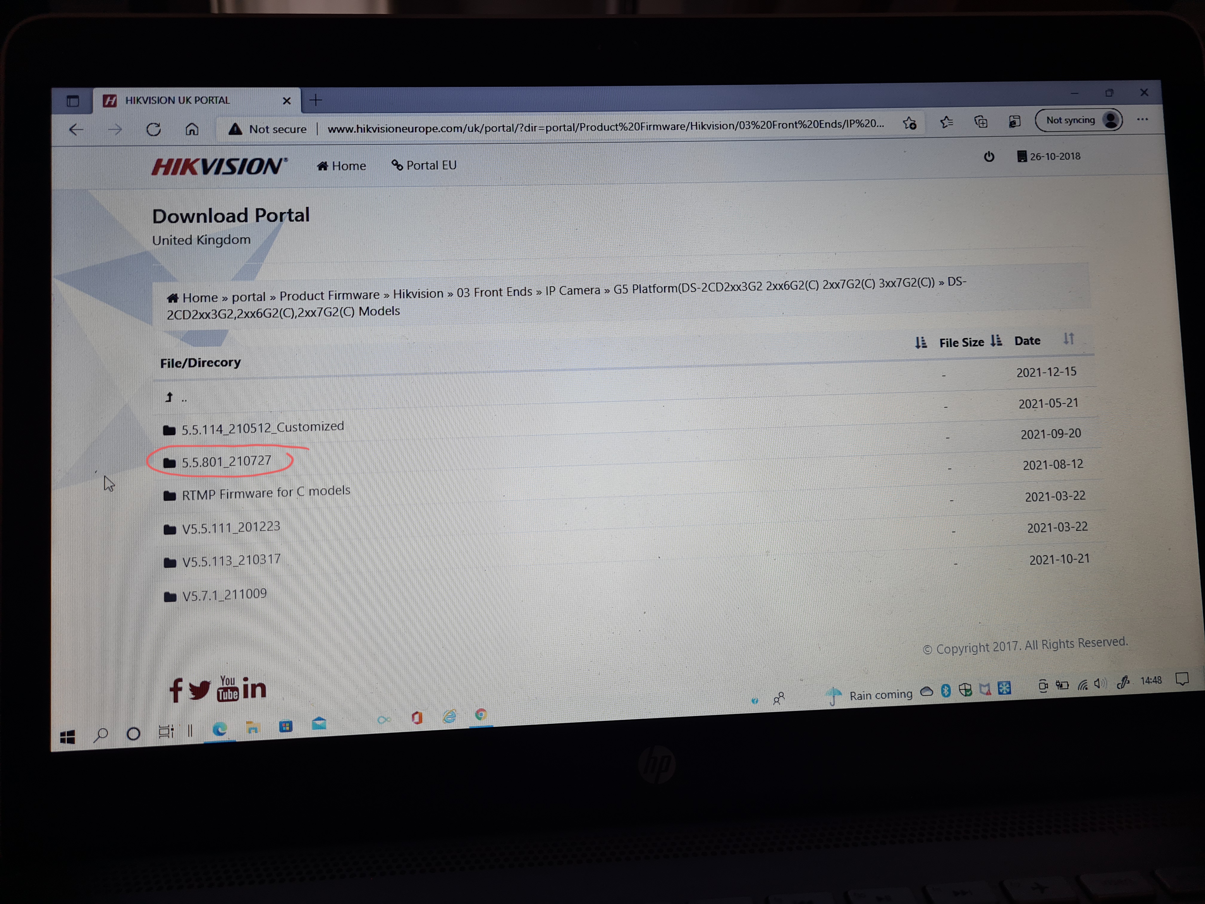

Which 1 should I pick on here?
The bottom 1? Can I load that with out any of the others?
Yes, the bottom one - v5.7.1 - is the latest and only one version higher than what you are currently running so should be no issue going straight to that version.
