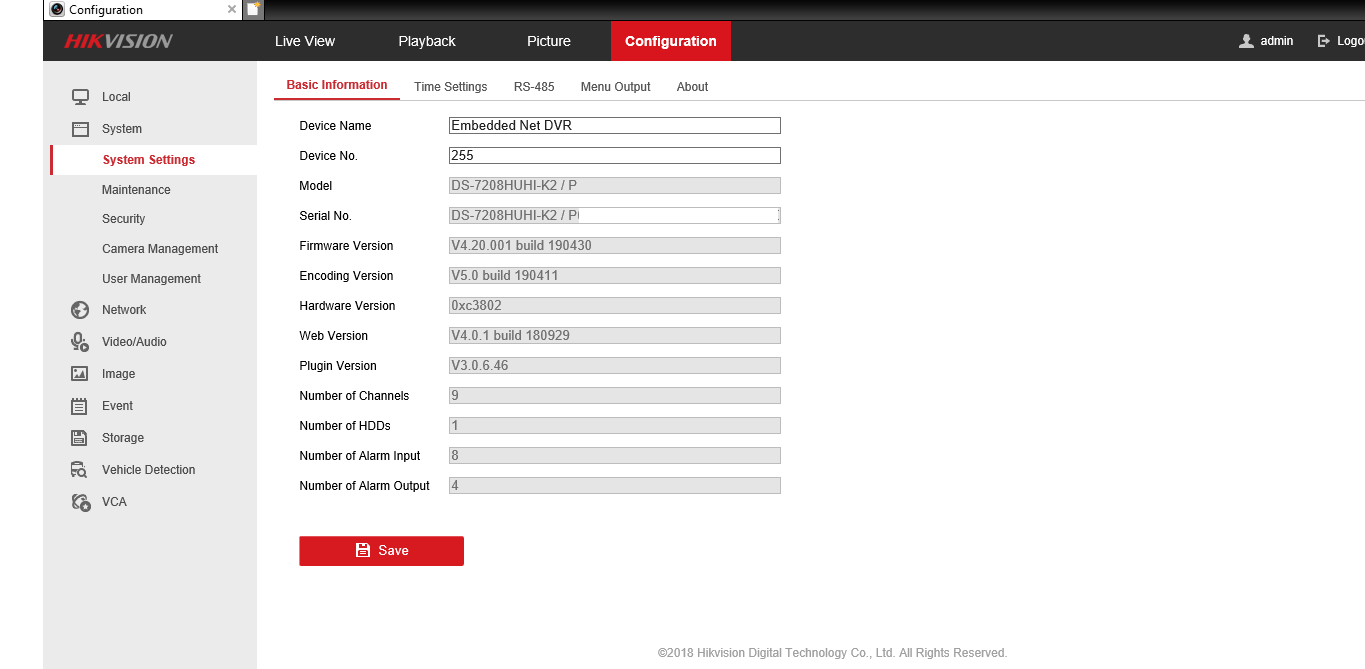

Hi all,
I am new here .I was trying to update the latest firmware for this Hikvision DVR model DS-7208HUHI-K2/P..
atm I have the Current Version V4.20.000 build 181107..
The reason i try to update it was ,i cannot see camera live view when I use web browser IE
I install the LocalServiceComponents. but it was not successful, only I can view live when I use IP Acusensce camera, when I sign to this camera of ip address
I though the problem was a old firmware, so I decided to upgrade using usb however there was no success, I tried 3 usb's and none of them manage get the job done..
Then I tried to use IE web browser to upgrade but still nothing .. this isn't the first time I have upgraded dvr etc , but this time I cannot find a way to upgrade.
The only way I haven't tried is to restore all parameters to default settings..
I tried all of this firmware by the verision and by the date ..
V4.20.000 build 181107 - 2019-03-19
V4.20.001 build 190430 - 2019-09-20
V4.20.100 build 1801204- 2018-12-22
V4.21.000 build 190722 - 2019-12-03..
So I have given up for now. I thought I try asking online if something is wrong or something else. Please let me know if anyone can assist further.
Regards Nick
Finally all sorted ...
regards Nick
Hi
How was this sorted, did another version just work? I having the exact same issue
Thanks Matt
Hi Matt.
I Was doing wrong with Europe portals before, that’s why it was going wrong etc ..
What I do .. I just choose the main Hikvision webside , then from there I search for NVR or DVR i want to upgrade ..
here is the link ready for you .. if you are on same device I am ..
Regards Nick
