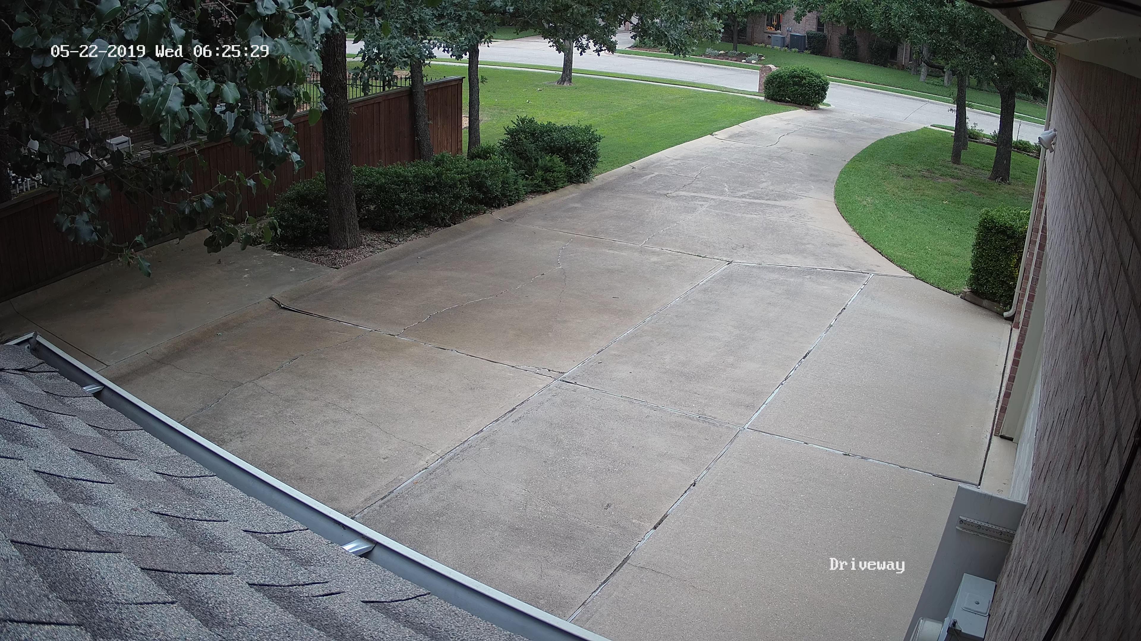

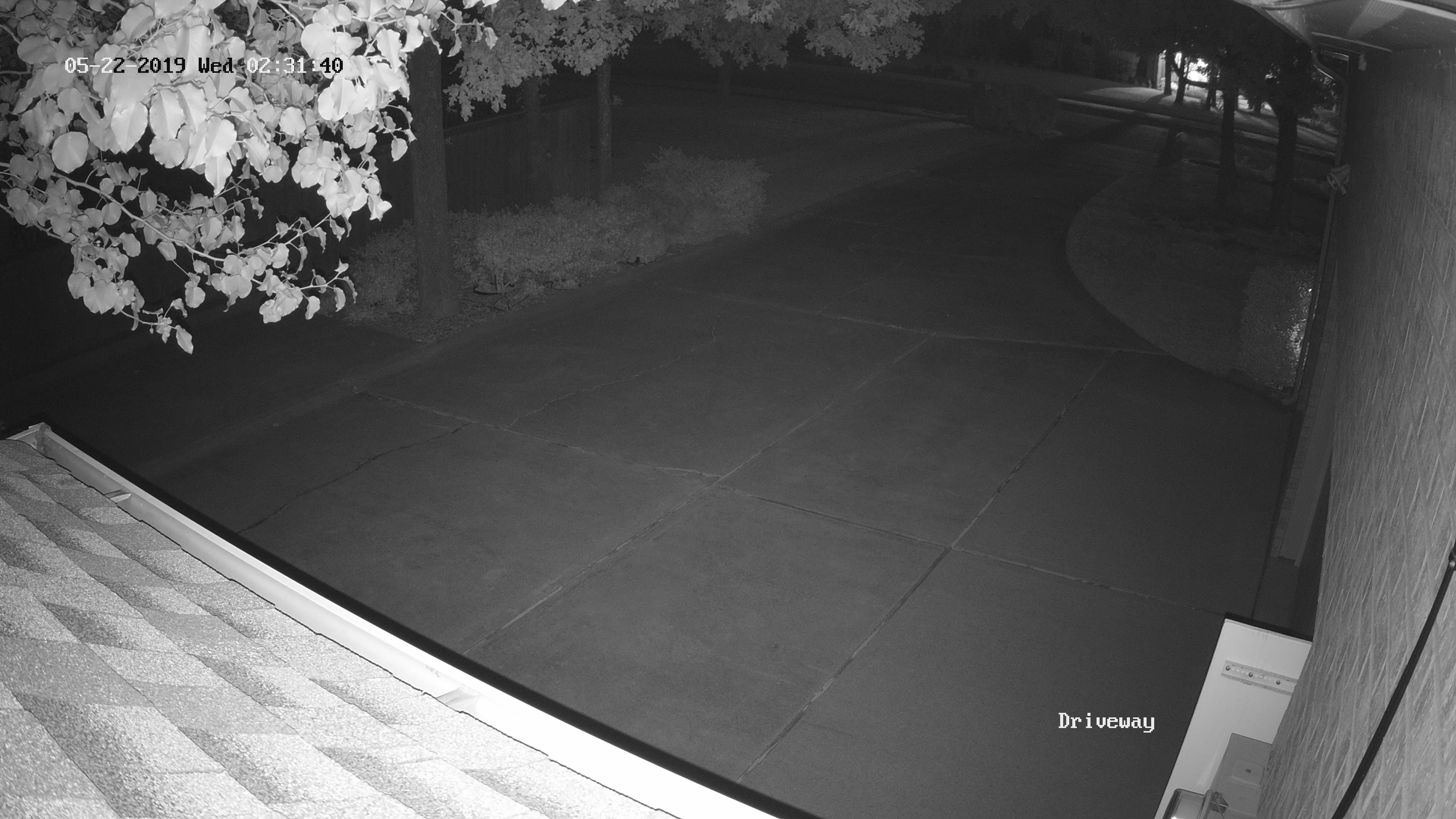

I bought the 2CD2385G1 and it's fantastic, would highly recommend getting it. The 2CD2385G1 is still fairly new and not sold everywhere so I think that's why there's a lack of reviews, but it is the upgraded version of the 2CD2385FWD. I attached some screenshots from the 2CD2385G1.
Thanks Nuro for the screenshots, they do look good. Is that a 2.8mm or 4mm? I'm guessing the single hole design is better than the 2 small holes design (from the previous version) for some reason.

It's the 4mm. Only thing I wish was it did audio recording as well.

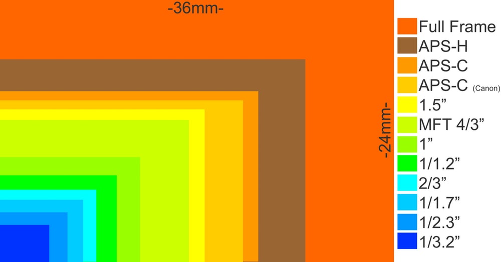

I was also looking to buy the DS-2CD2385G1-I. I noticed that the image sensor is smaller 1/2" compared to the DS-2CD2385FWD-I that has a 1/2.5 image sensor. Could you tell me the name of the new sensor being used in the DS-2CD2385G1-I so I can look it up.

It's a simple mistake to make but in sensor sizes a 1/2"(half inch) sensor is actually bigger than a 1/2.5" sensor which moves closer to a 1/3" (third inch) sensor. You can see this laid out in the table below:
2536
We don't yet have a side by side test of the 2385FWD vs. 2385G1 and we haven't opened one up to see exactly what sensor it is using, as far as we are aware the IR LEDs are the same EXIR LEDs of the last generations of turrets. The Darkfighter technology in the EasyIP 3.0 cameras is not full Darkfighter like the more expensive 5-series Darkfighter cameras, the 3.0 cameras are referred to as 'powered by Darkfighter' because they only use the software side of the Darkfighter technology to improve how the cameras process low-light images. Many of the people who have bought the G1 versions from us have previously had FWD versions and we have yet to have any feedback saying that the older FWD had performed better, but more importantly the choice between FWD and G1 versions is soon not going to be a choice (in the UK at least) as the G1 models will be superseding the older FWD models.
