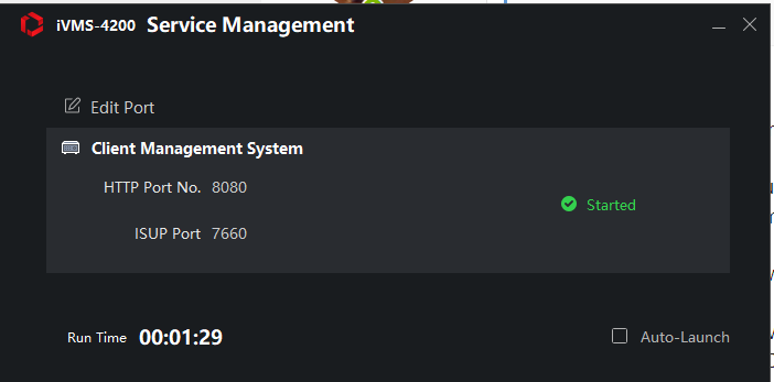

Finally when i open iVMS 4200 now i get a pop-up is this ok or an error?
Cheers in advance
If you are reffering to login password you can change over IVMS after you login into it. If you are reffering to verification code of hik-connect you can change it throught indoor station, go into configuration and find hik-connect. There you can change verif code.
After you change admin password you will need to change it in IVMS to login, and verif code will be asked on hik-connect app.
Don't worry about pop-up windows as long as they are started.
