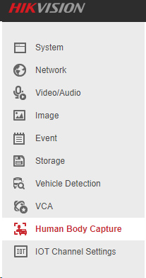

but my NVR doesn't have "people counting" in the left hand menu of the configuration screen.
I have: vehicle detection, VCA, Human Body Capture options but no "people counting".
Anyone have ideas?

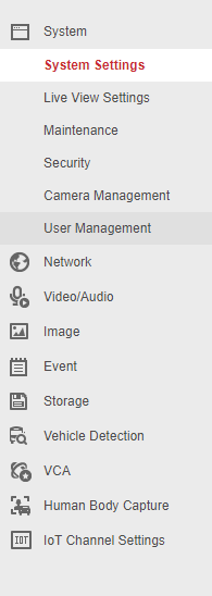

I've upgraded the NVR firmware:
Still only getting these options though:
Any ideas?
The user manual for your camera seems to suggest the People Counting settings should be accessed by logging directly into the camera.
If the camera is directly connected to the PoE ports on the NVR you will need to enable Virtual Host in the NVR setting to allow you to log in to individual cameras.
