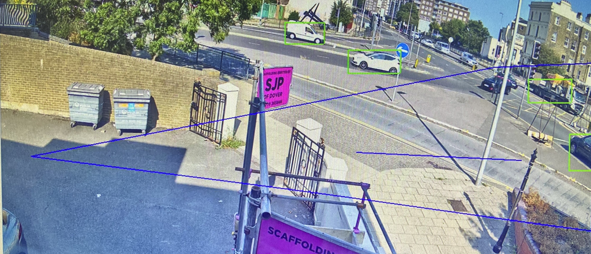

i own some of the DS-2CD2186G2-ISU with G3 and G5 platform. I'm able to see the blue area boxes and green motion detection boxes via iVMS, similar to this one:

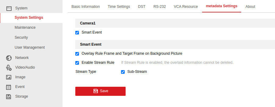

However i would like to record the green boxes / motion detection events via rtsp and without iVMS. I have enabled the following settings, but the substream still just contains the blue area boxes without the green motion detection boxes.
Did i miss anything here or is this not possible?
