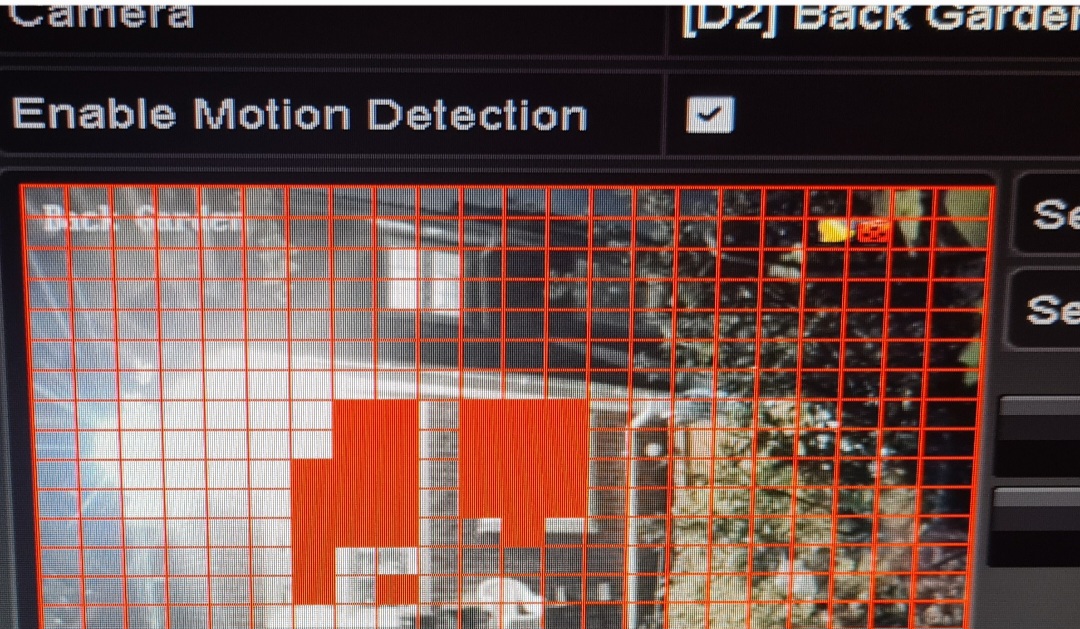

I have a second Hikvision NVR exactly the same model which has not been upgraded and I have attached two photos to show what I am talking about.
You can clearly see the green motion indicators beneath the blue timeline and the other photo shows the red boxes lighting up as I turn the dining room light on and off.

Having done more research into this and having posted my question on a few other forums it appears the latest Hikvision NVR firmware has simply done away with these features.
My previous NVR Firmware was V3.4.105 (old style interface). I'm thinking about finding the latest V3.x.x Firmware (so pre V4) and doing a Firmware rollback.
Does anyone have any experience of rolling back to older versions of firmware? I know the manufacturers frown upon this, but in reality people do this all the time. I am willing to risk bricking my NVR to try and get back the features that I want.
Any advice appreciated - thanks.
There have been a huge amount of changes between your previous and current versions and not just visually.
If you want to downgrade, you can generally just do that in the same way you upgraded, choosing the old file. It won’t brick your NVR but will probably wipe it to a factory default inactivated state so you’d have to program it from scratch.
It would be better though to learn how the new setup works. Download the manual and get used to the revised operation.
