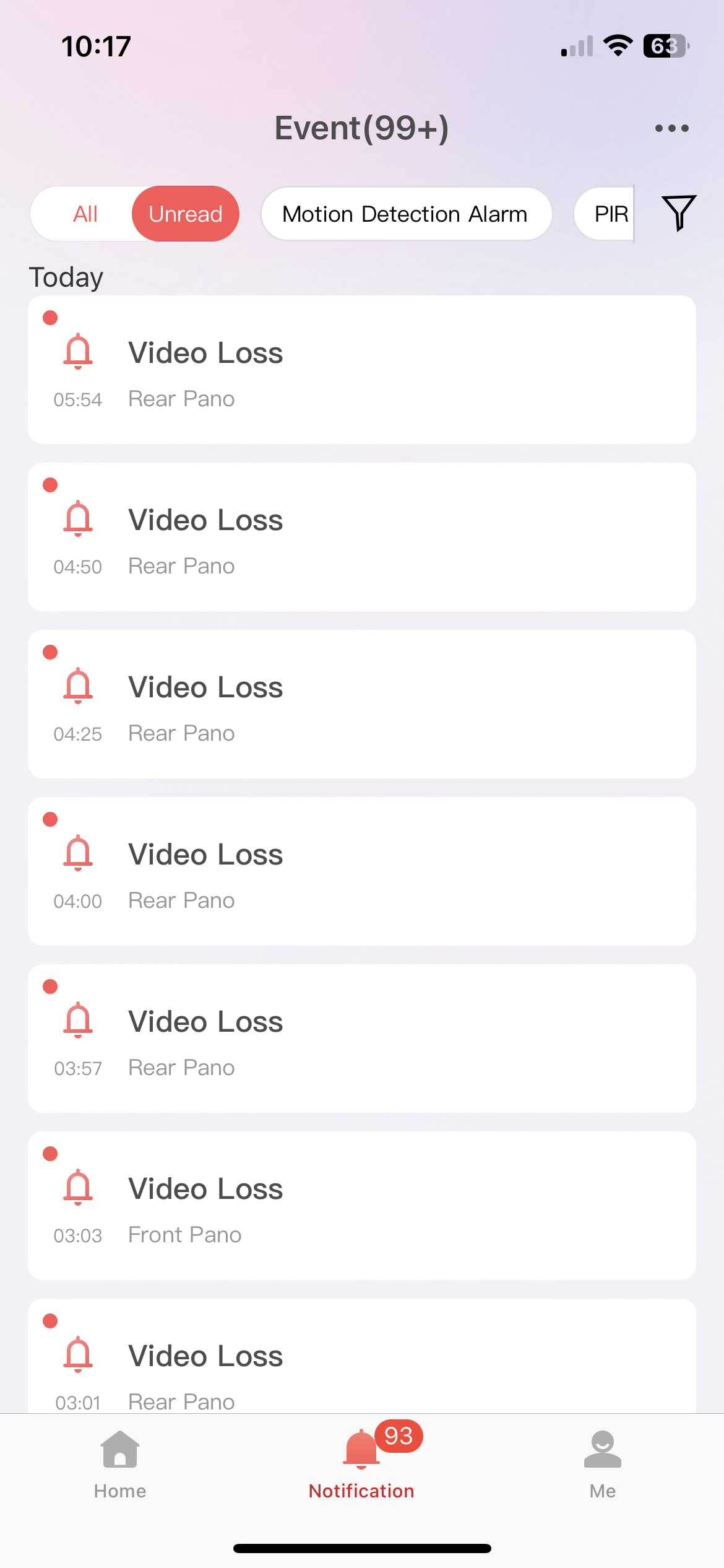

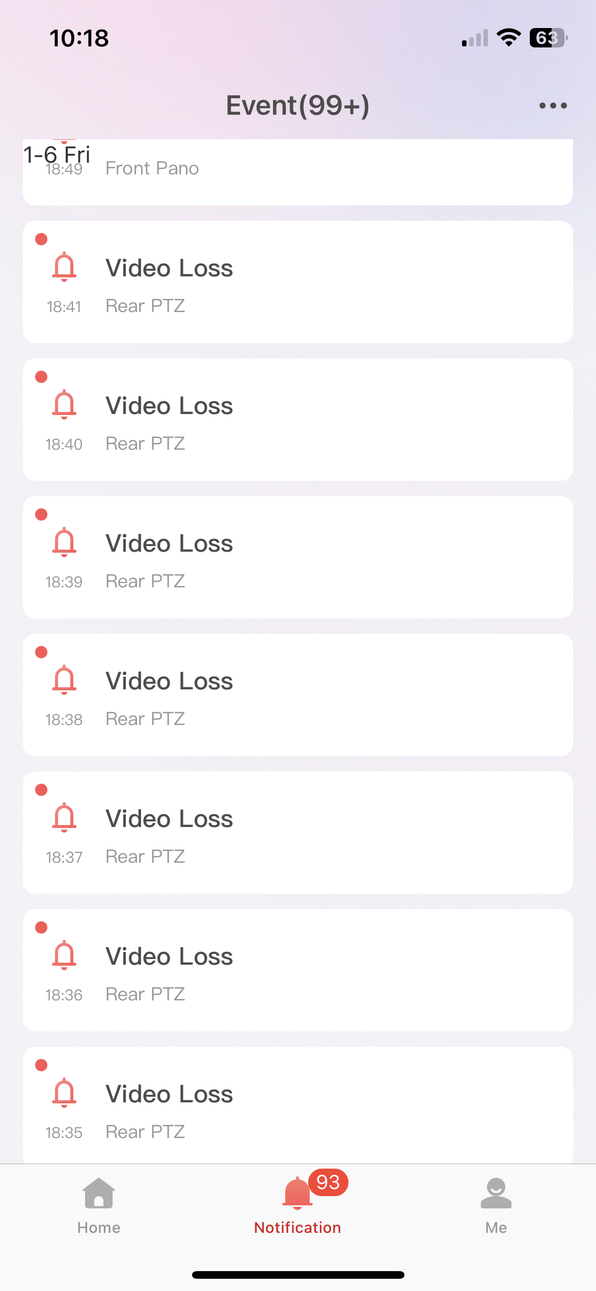

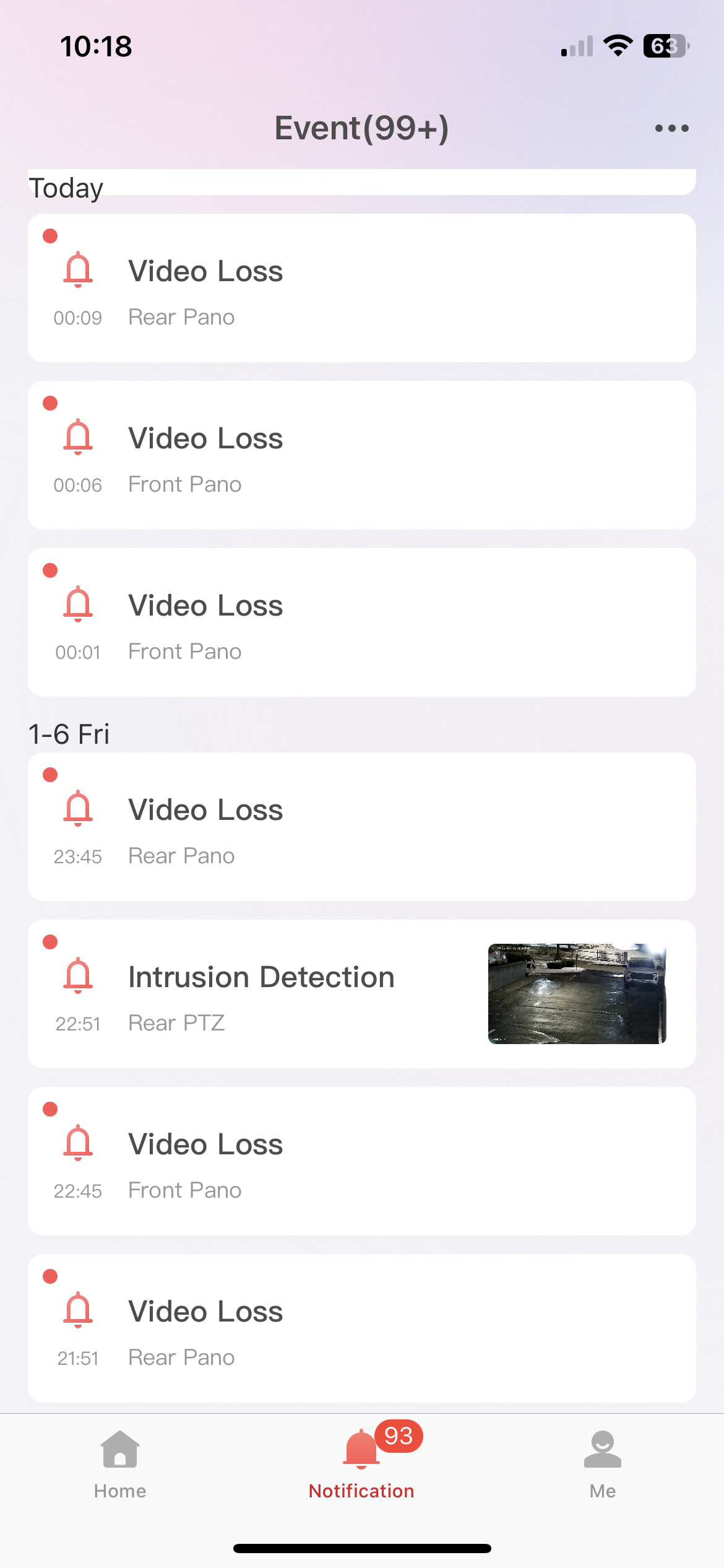

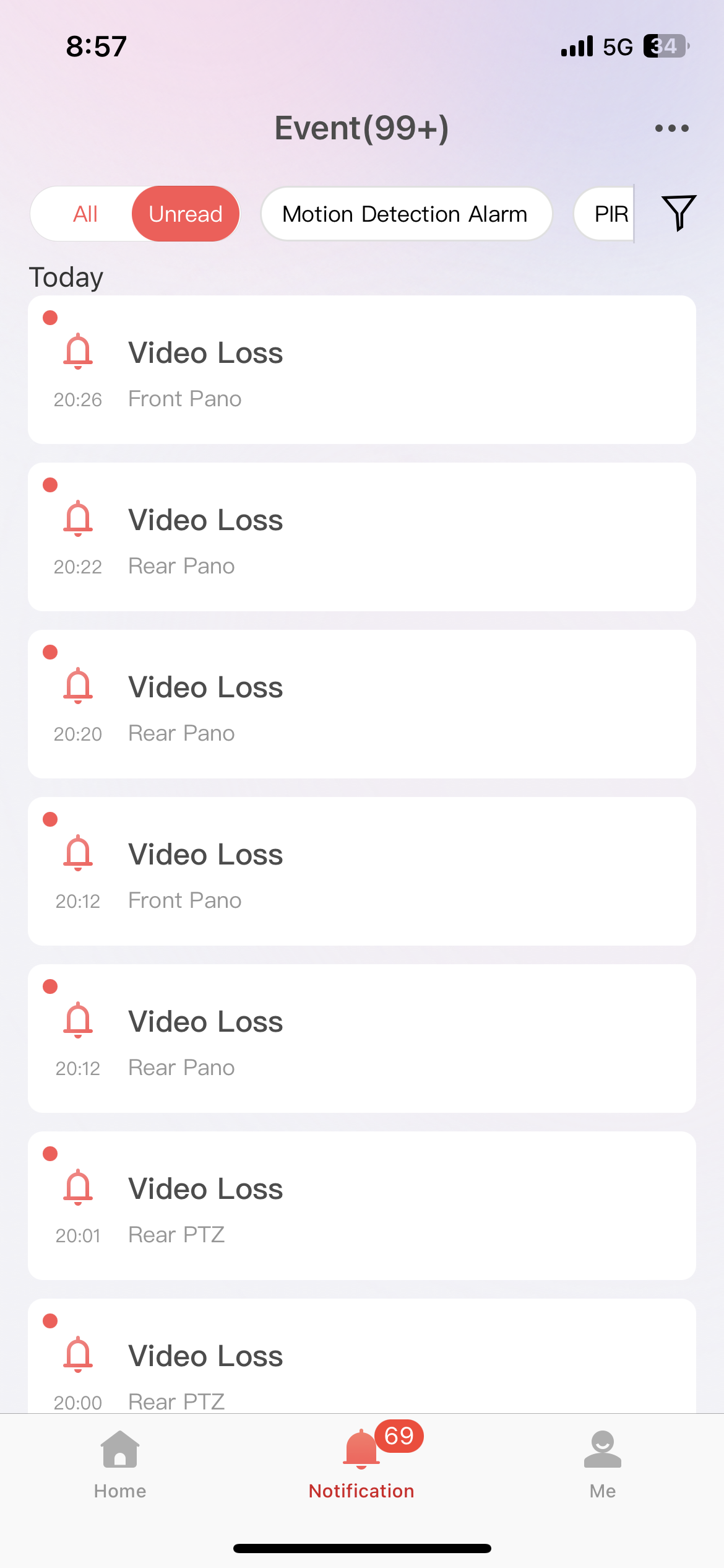

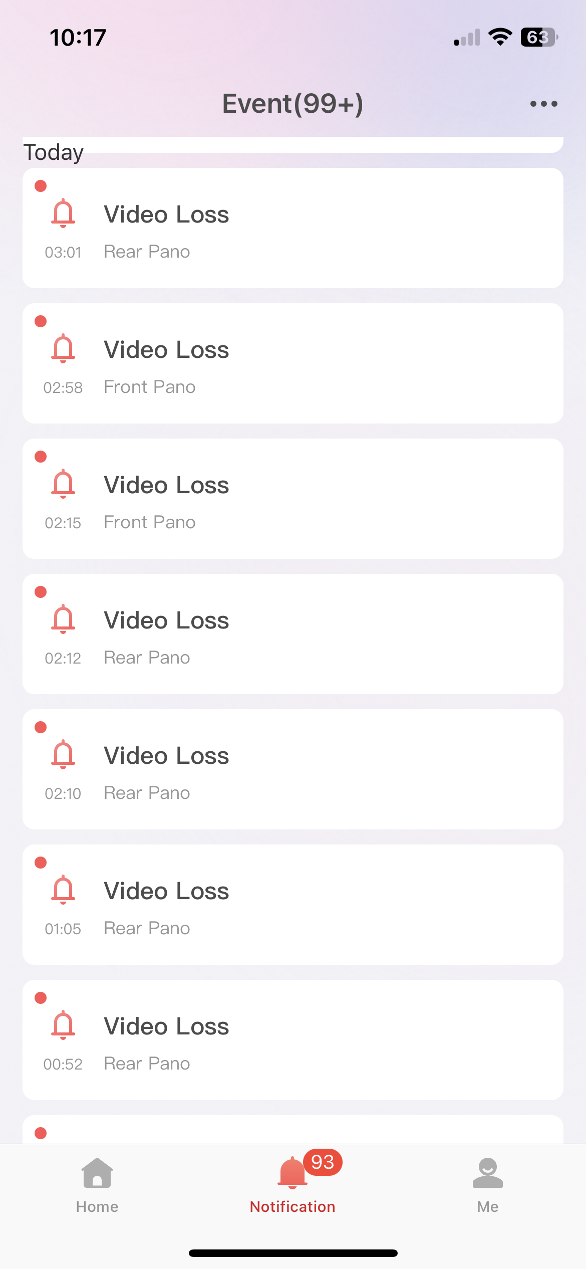

I have tons of video loss (35 in the last 4hr), only during dark, worse in rain/snow. I have someone coming out to do a line certification, I doubt I have a cabling issue.

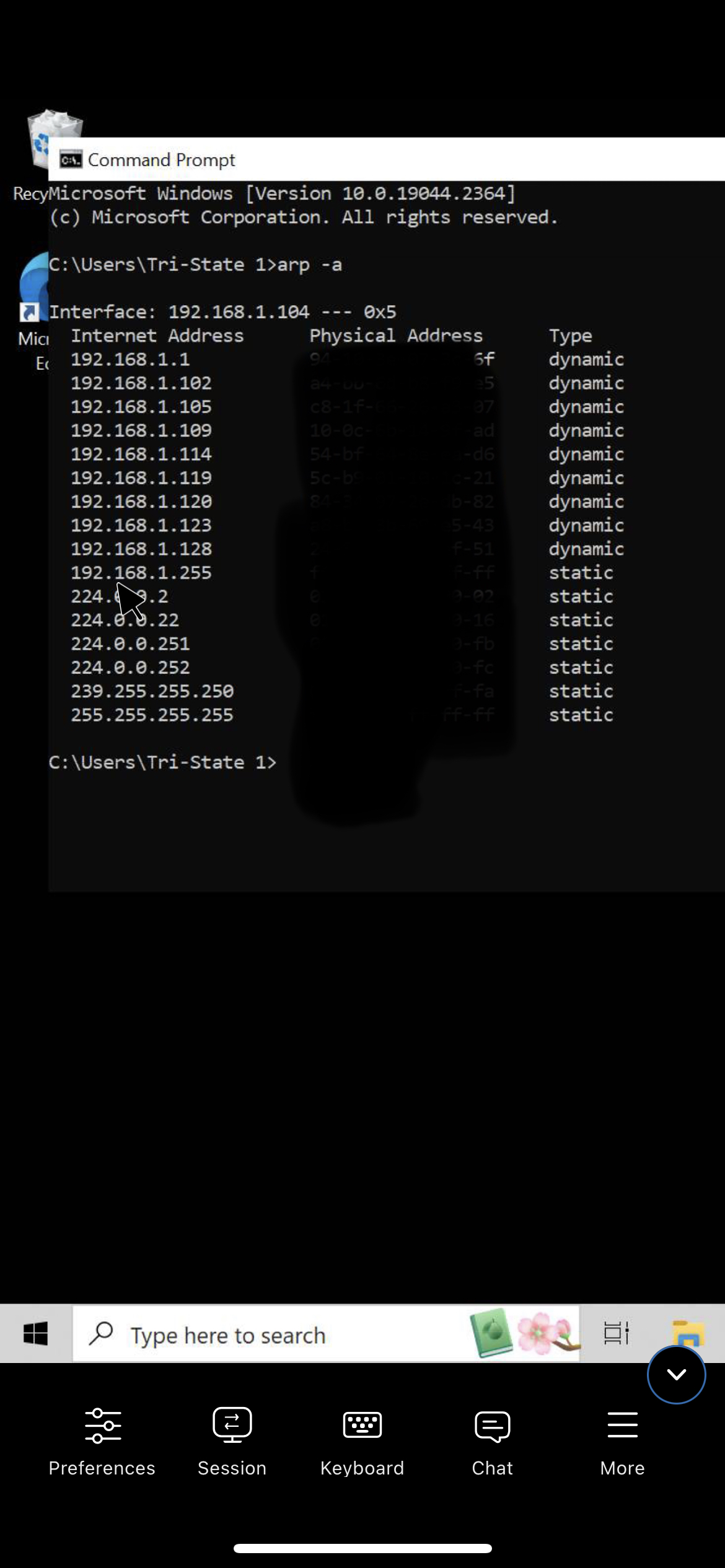

Network is dhcp, I don’t see any ip conflict when running arp -a half of my network is static.

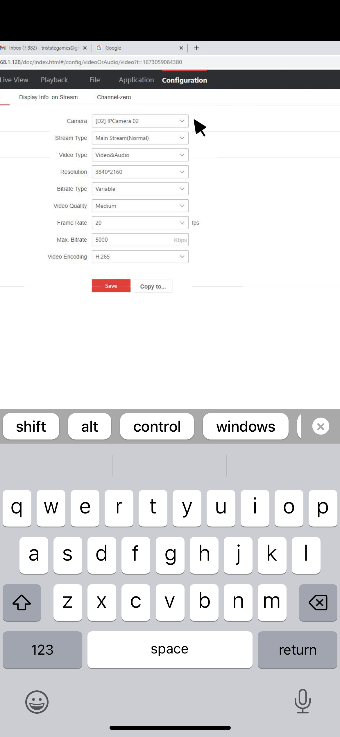

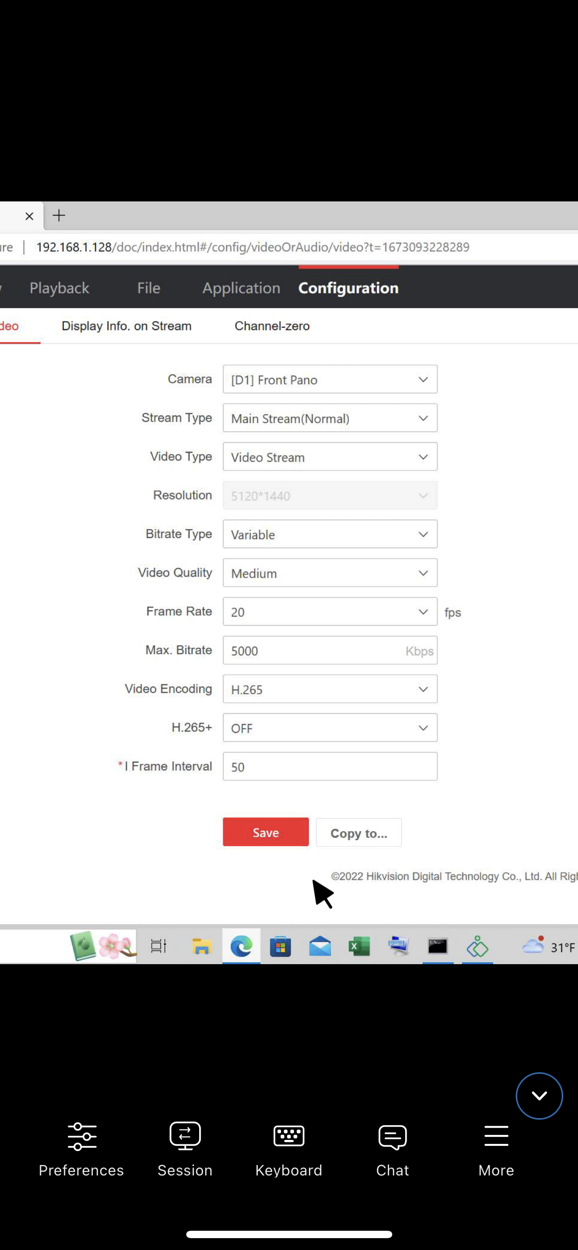

I’ve tried h264 and h265, currently set cameras from nvr web inter face as follows:
Bit rate variable
video quality medium
Frame rate 20
Max bit rate 5000
Video encoding h265
H265+ off
I frame interval 50
I had frame rate and bit rate up higher, tried reducing around 5:00, didn’t seem to help at all. I do have footage loss ~10-30 seconds that doesn’t report as video loss, this seems to happen during an intrusion/trip wire event. None of the cameras are running IR (good ambient lighting), none of the cameras are running built-in lighting. Ptz’s have auto defog enabled.

I will have a line cert done just to rule that out but all day everything works fine, then dark hits and it’s game over. It’s been like this since install, couple weeks.
Are your static IP addresses outside the range of your DHCP server?

Are your static IP addresses outside the range of your DHCP ?
I thought my work stations were set to static, the two that are on are dhcp, the others are off during the evening so I couldn’t confirm remotely, I’ve attached a picture of my ip addresses,I believe these leases are:

The panoramics have a fixed resolution of 5120x1440. Do I need to enable ultra hd?
I was thinking of temporarily reducing all cameras to 1920 x 1080 (HD). you may have to do this at the cameras web gui

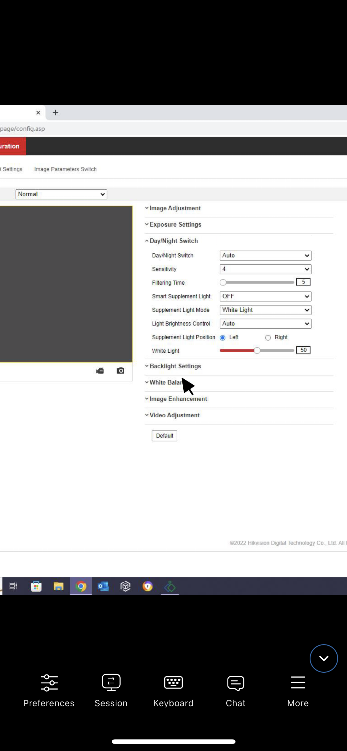

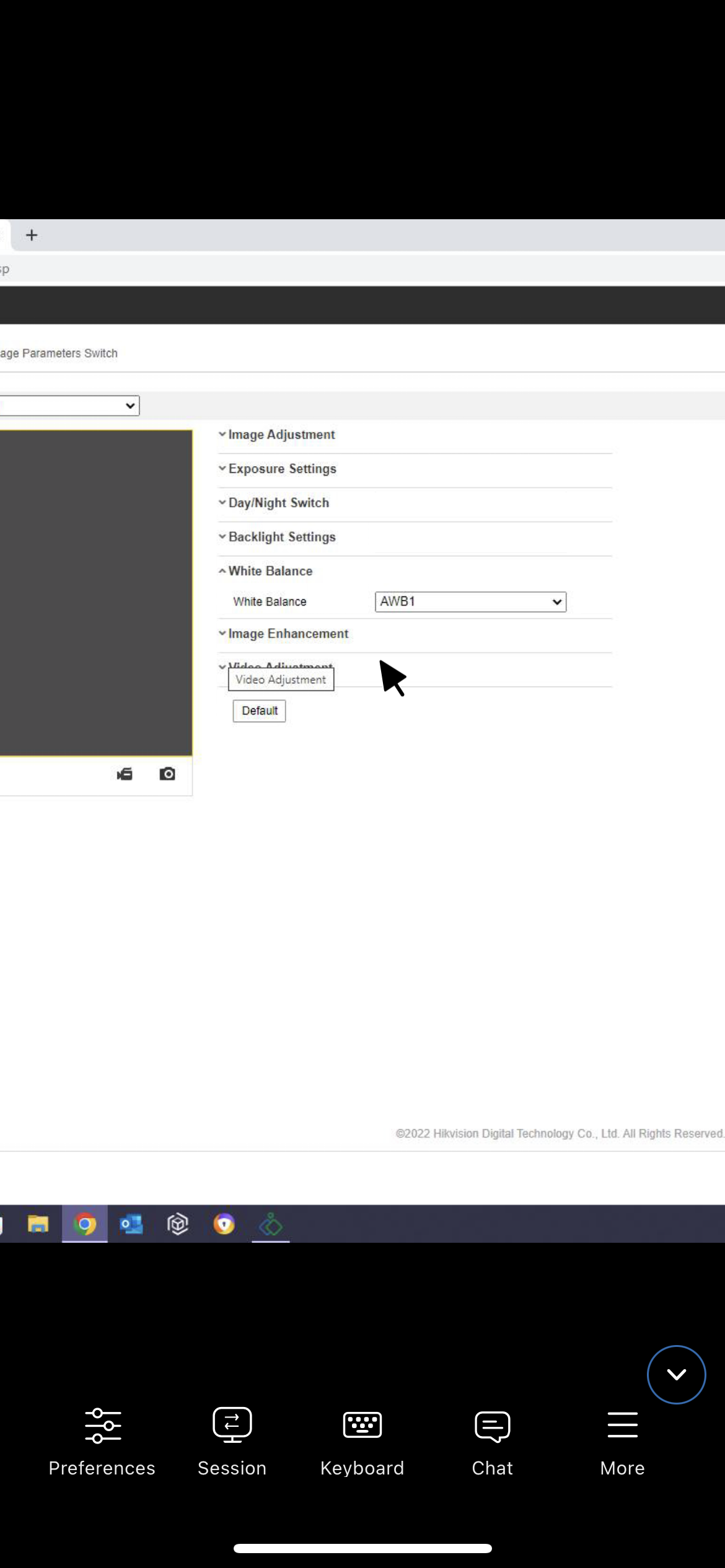

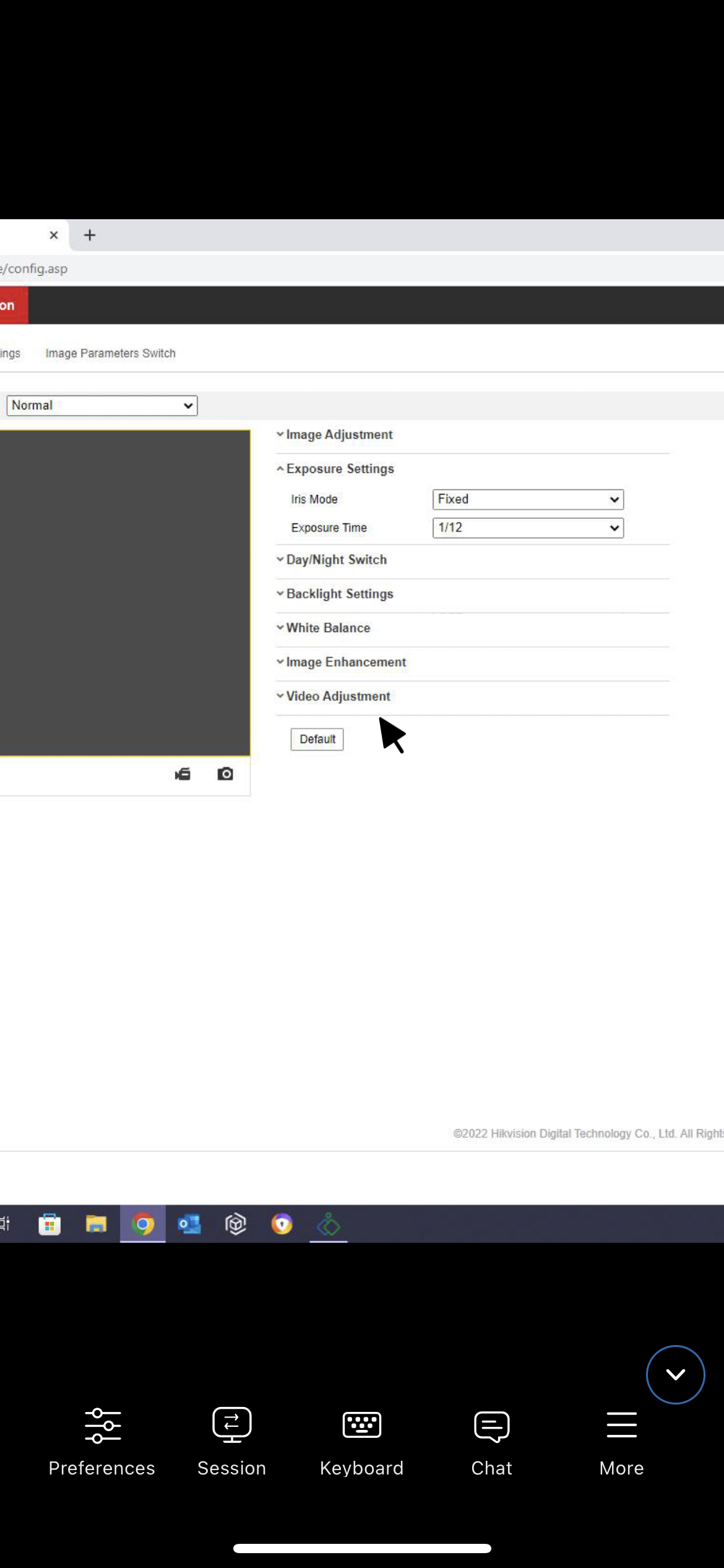

What are your camera exposure settings for night use?

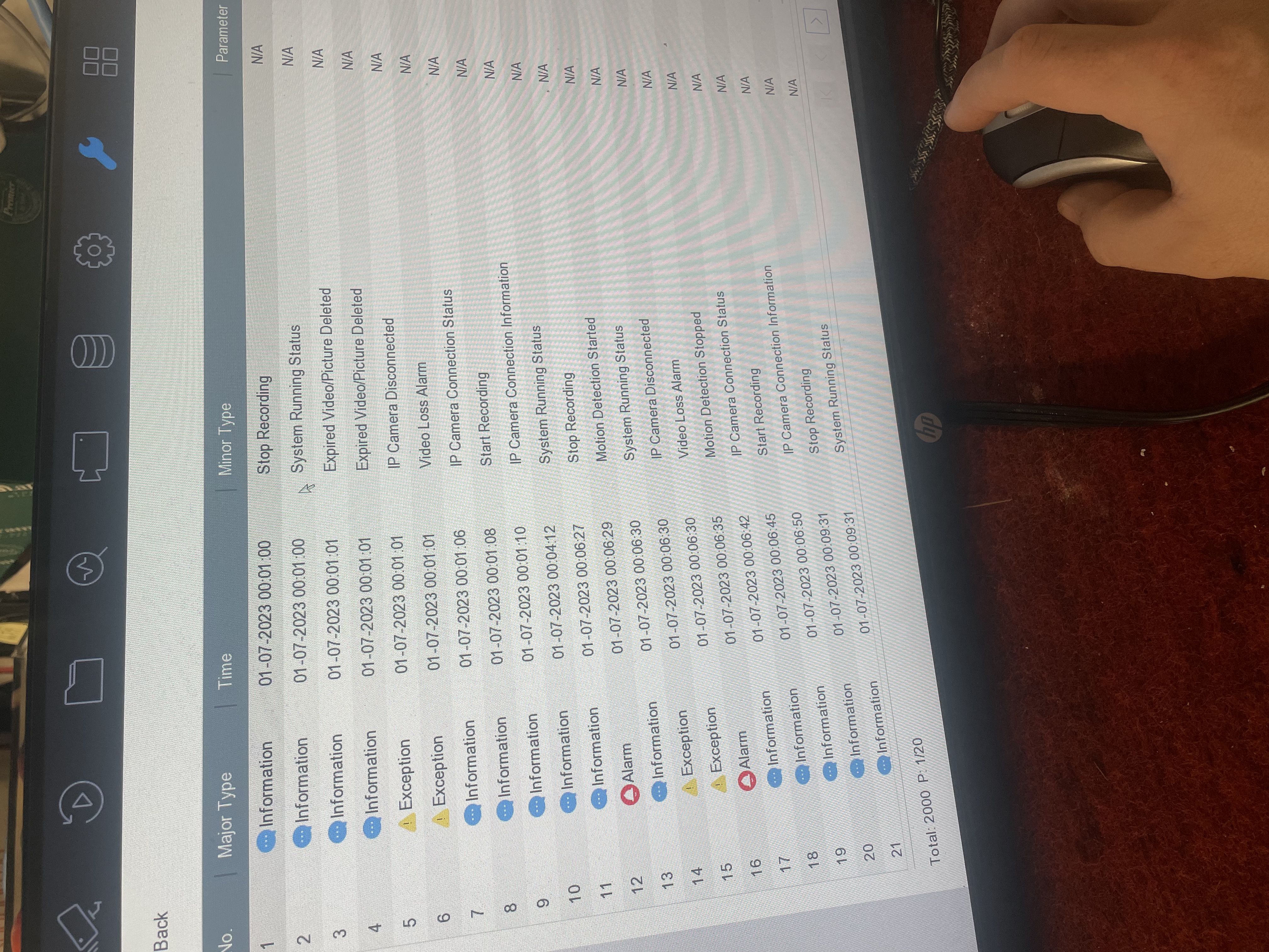

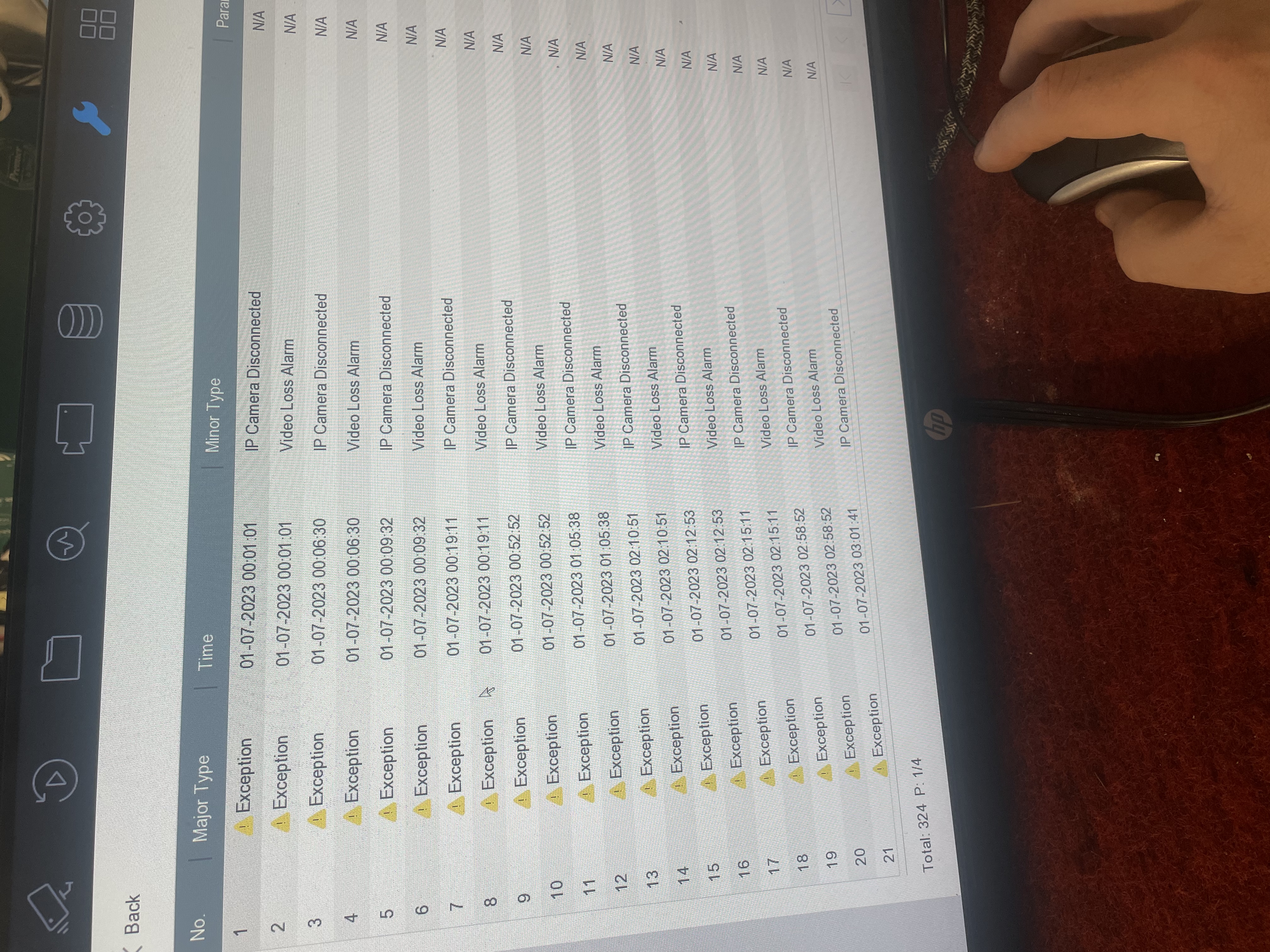

I have viewed from the nvr, the “video loss” error is recorded there. I also have black (missing video) in my timeline play back. The 2 panoramics are set to 24/7 record. It also will occasionally pixelate the recording at the nvr, sometimes green bocks other times just a blur.

I still could not see how to adjust the resolution in the camera web gui, pictures of settings attached.

which camera has the 1/12 exposure setting? seems very long, The NVR should read / write the settings from the Hikvision cameras, I'm not sure about the Dahua cameras, I wouldn't rely on setting the Dahua from the NVR. Use the web gui.

The colorvu panoramic has the 1/12 exposure, , all the cameras are dropping out in the evening, worse when there is activity (rain, snow, motion).

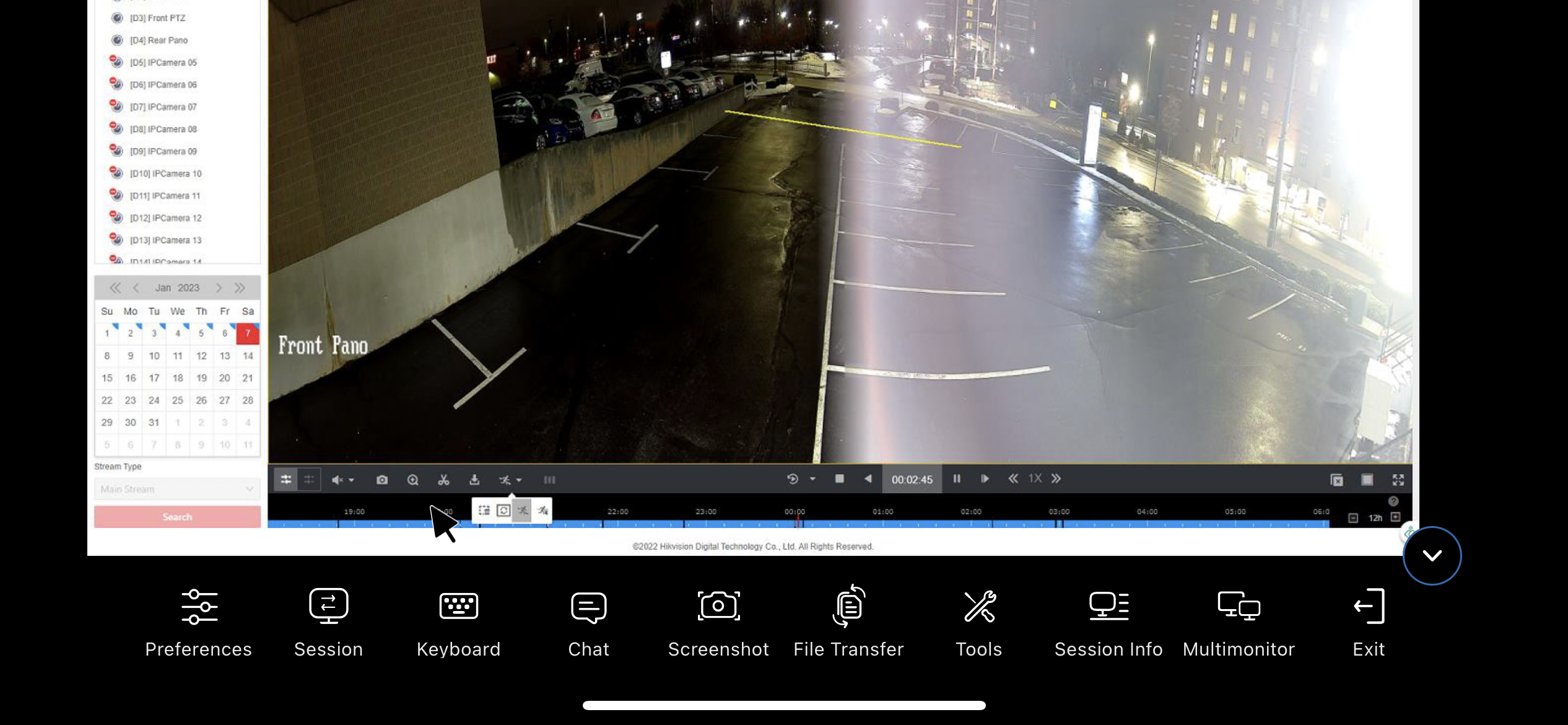

There really isn’t any images to post as it’s video loss. I’m posting some pics off all the offline alerts. Here’s some pics of the event alerts, and a pic of the timeline with black space in the timeline.
It seems like the ptzs have a run of signal loss, then it changes of to the panoramics, not sure that this is the normal trend but it was yesterday.

What name is this camera? Can you change the exposure to 1/250?

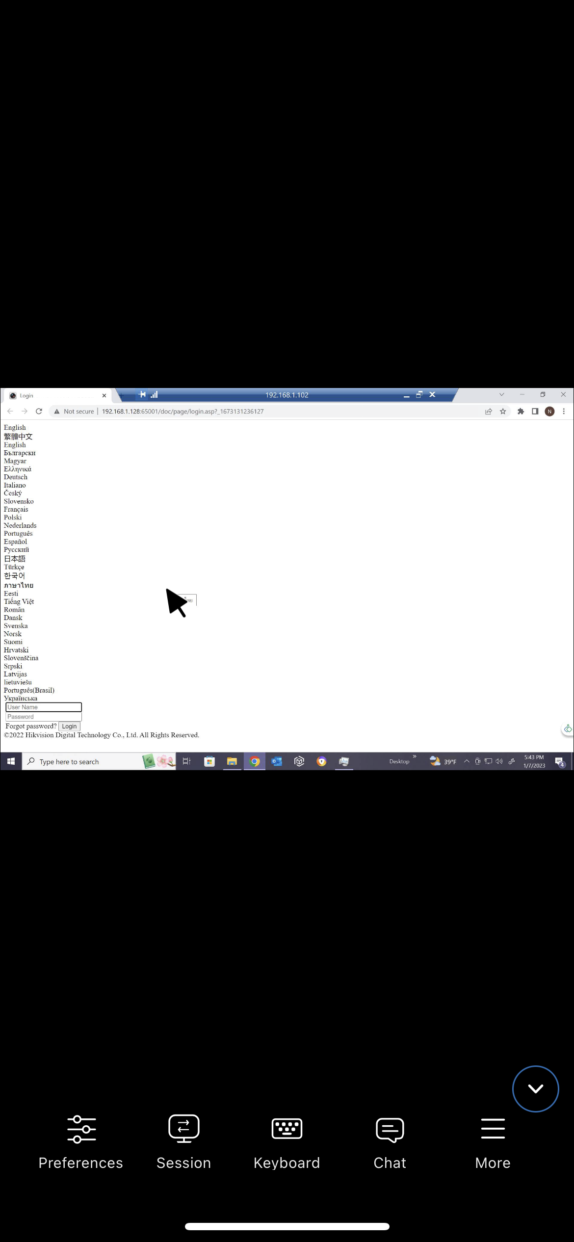

Why does the image settings page not show an image?
I can try to make the change, the video cuts in and out, I described difficulty setting trip wires because video pops up, then disappears. Happens to all the cameras, was happening when wired to a network switch without the nvr as well. I have had bad cable before, but it was cheaper cable from Amazon that was cca(didn’t realize when purchasing), so I’m hoping it’s not bad cabling.

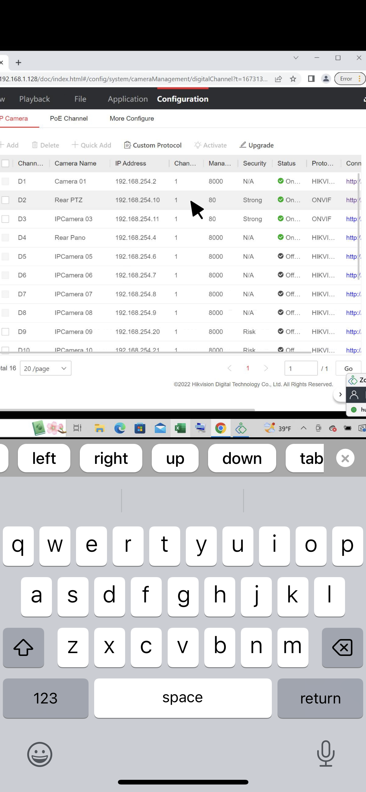

Sorry I meant the names assigned to the cameras on the NVR. Could you post a picture of the camera overview page from the NVR web gui?

Assigned names are:
Rear pano
Front pano
Rear ptz
Front ptz
I reset the panoramics today so names have changed, camera01 was front pano, name changed after reset.
After I reset the cameras earlier today I can not log in to the camera directly, I’ll attach a picture of this too.(edit). The dahua web interface is no longer working, I don’t think I did any network changes while resetting the hikvision cameras. Might be resetting nvr and staring fresh.

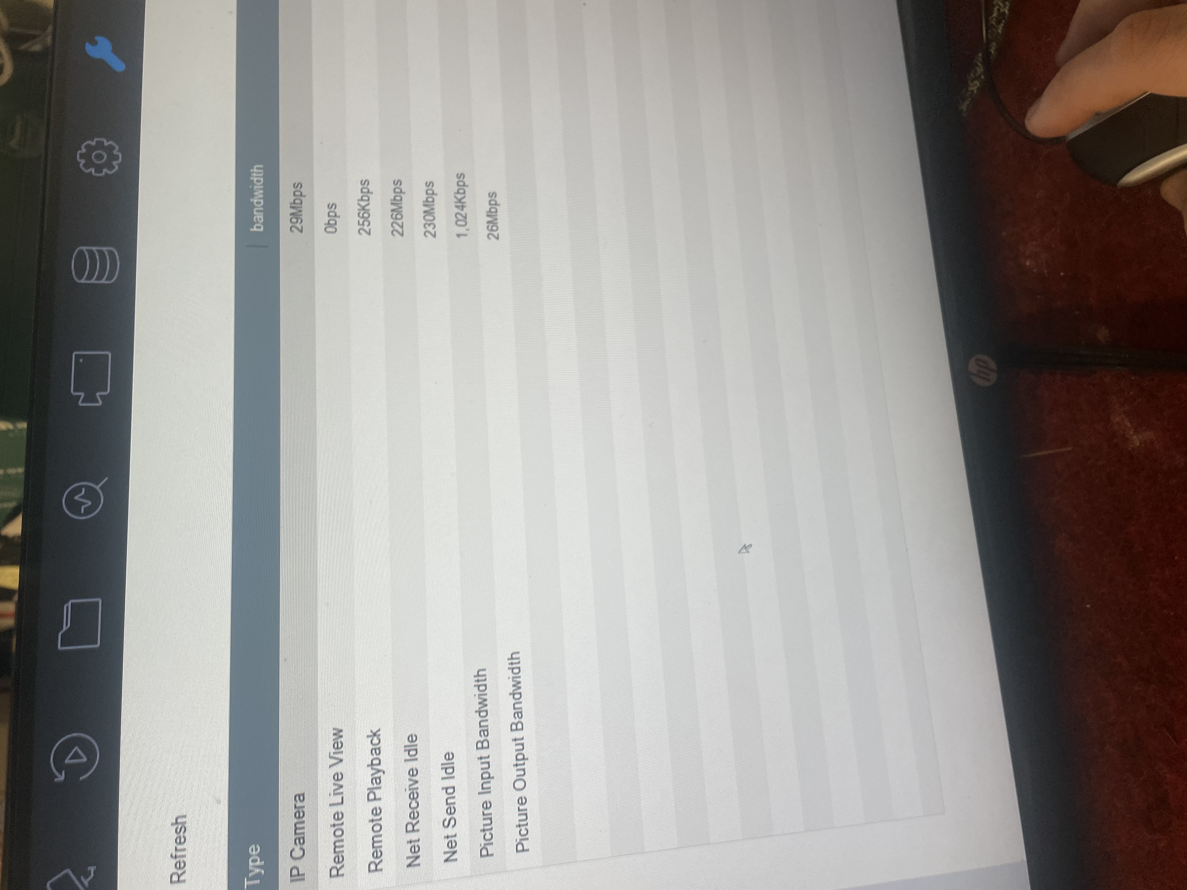

The nvr seems to have a solid connection, the video loss is reported on the nvr, I believe this video loss error that is reported on the nvr would be there regardless of an internet connection.

The 1/250 exposure seems to function fine.
Video seems stable when viewing the image screen and event image.

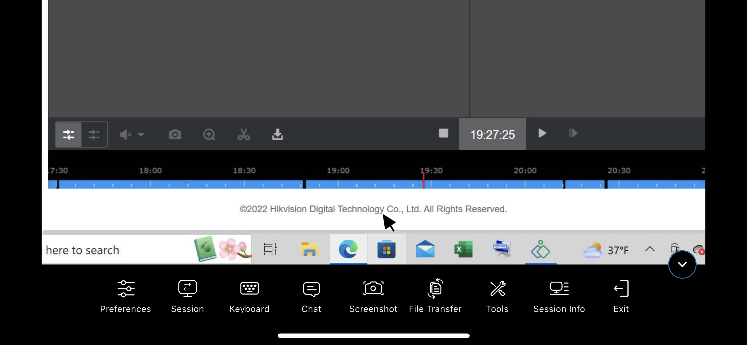

Nope, video still cuts out, I scaled my two ptzs back to 1080, will report back in the morning. Video loss is not for long periods, generally sub 1 minute.

Check the NVR logs for any network connectivity problems. Look at the router logs as well for network outages, you may be able to show DHCP activity connecting to the NVR. The NVR should get the same IPv4 address.

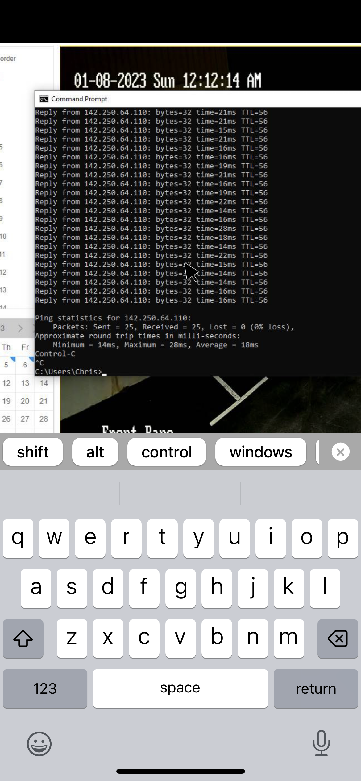

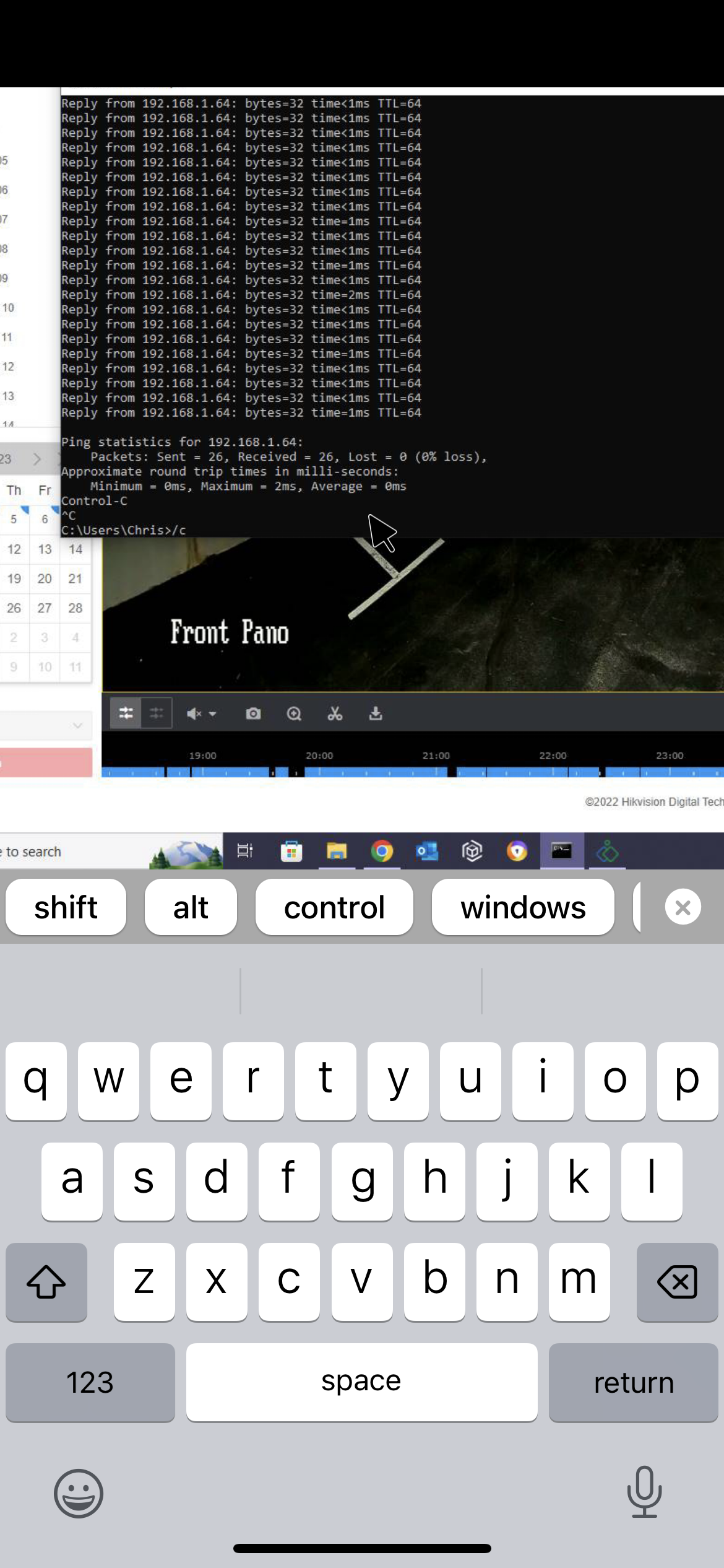

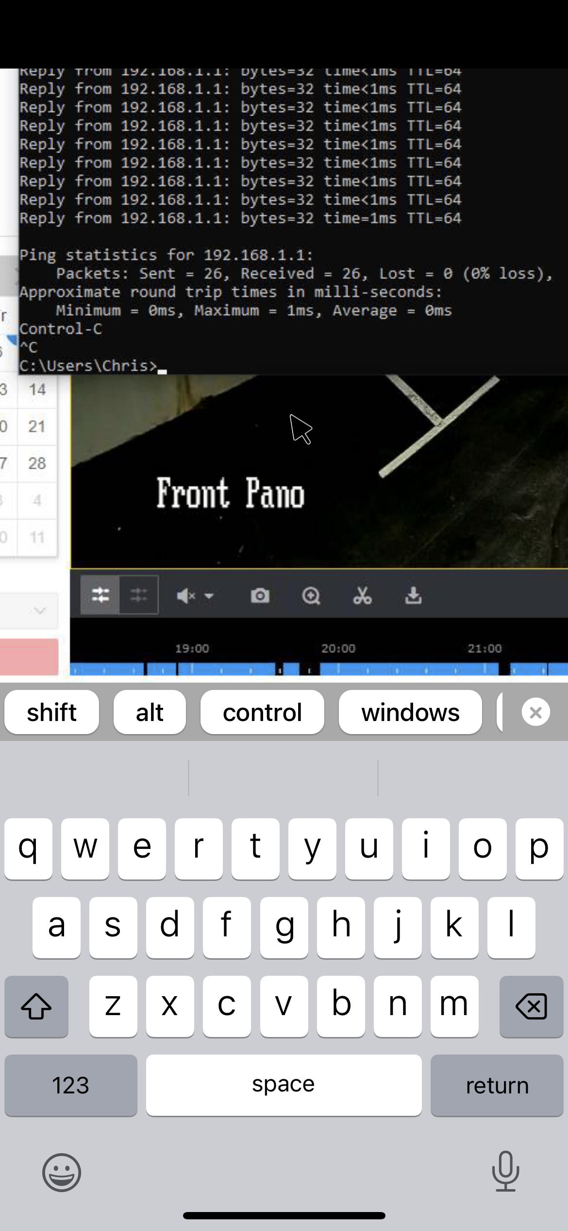

Open a command prompt window and do a 1000 ping test from the pc to the router, then pc to NVR. post the results
ping /n 1000 <IPv4address>

Good morning, I’m in the US, the testing has been through wired windows work station, it does not have WiFi, I am remoting into the office computer then connecting to the nvr/camera web interface(s).
I attached 3 pictures
Fastest was computer to router
Slowest was computer too google
Other was computer to NVR

Ping results were as expected, no problem at the time of the test.

I didn’t see any more blank space in the timeline. I did also dumb down the resolution for the PTZ. I’ll gather the info and report back Monday, thanks again.
That's why I like to drop the video resolution on all cameras and see if the problem goes away, then figure out why.
