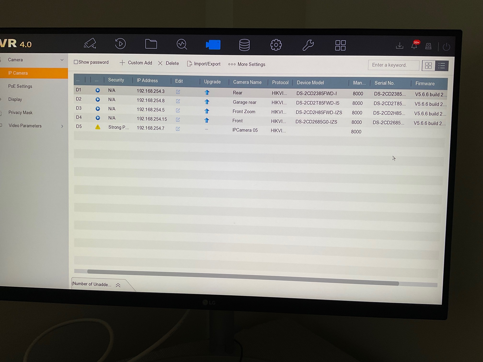

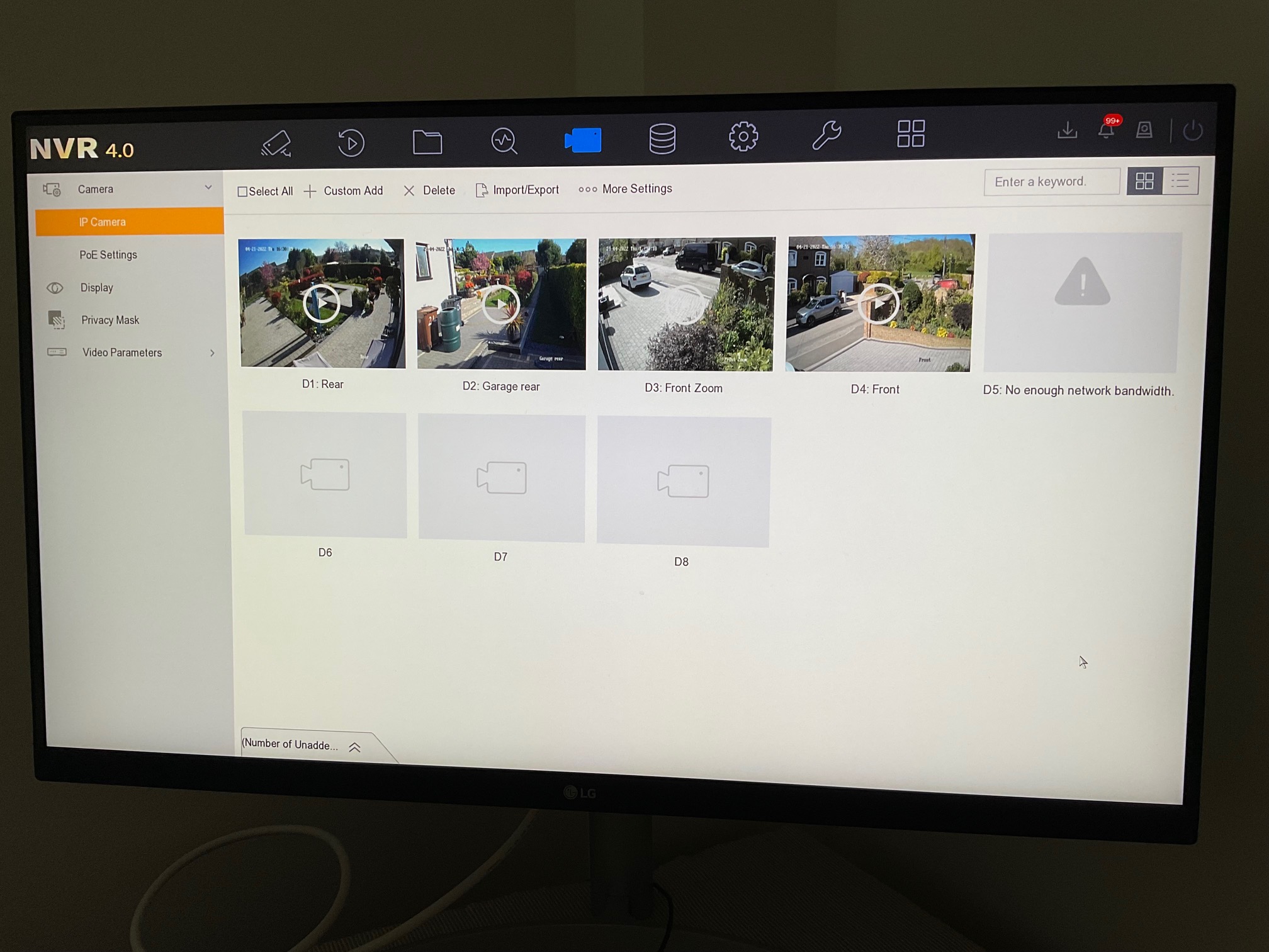

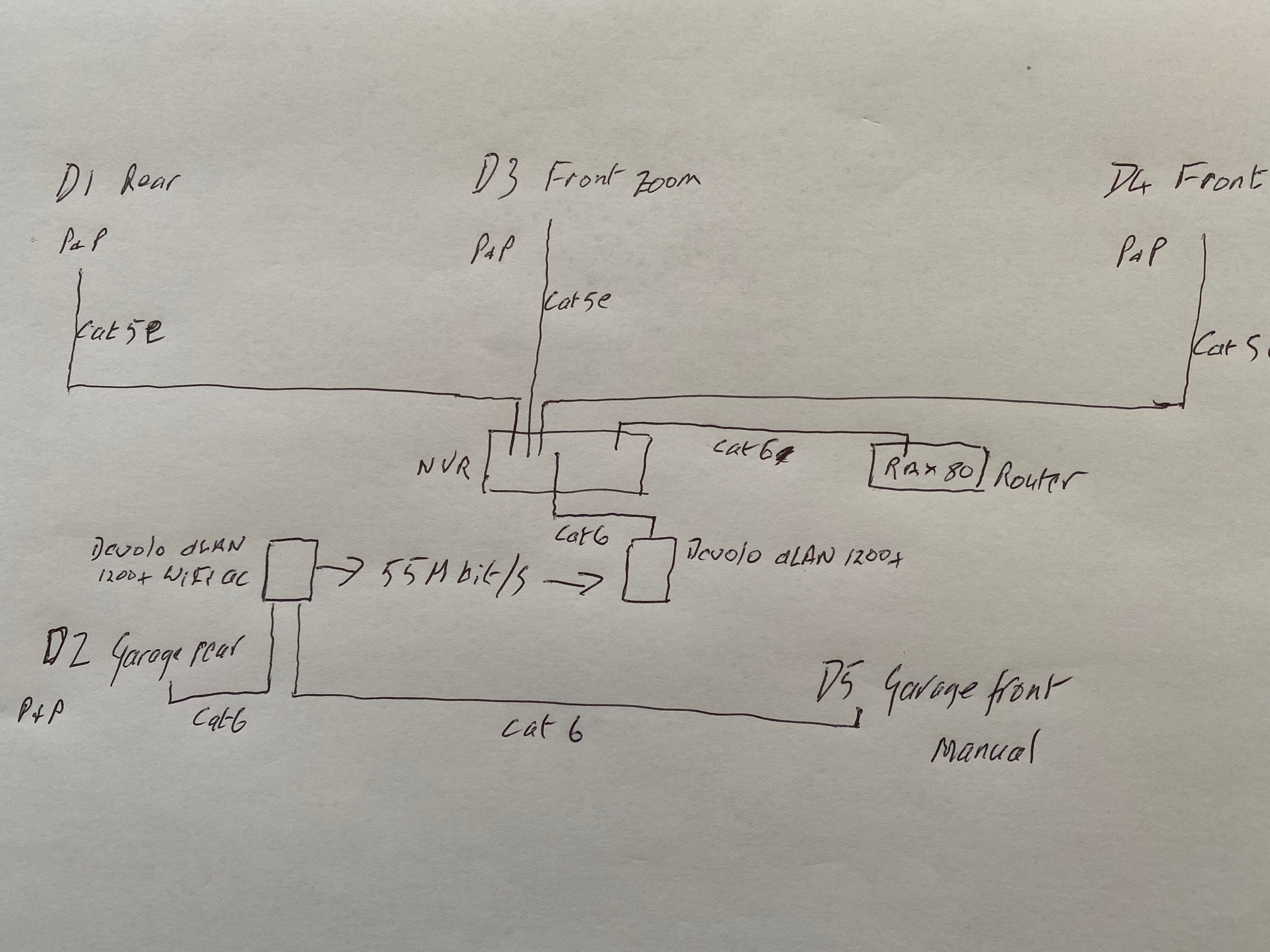

Hi!
I’m a newbie to this forum, but I’ve been struggling for months trying to solve a couple of problems by myself, and so would really appreciate some help.
I have a DS-7608NI-I2/8P 4K capable NVR on firmware V4.22.005, Build 191208.
I have five Hikvision 4K capable cameras, all on firmware V5.6.6, Build 210625.
My first problem is that no matter what resolution I set the cameras to, using their individual browser addresses, even setting all to HD, my NVR after a reboot, sets one of them at random to VGA resolution (640x480) and only records it at that resolution. (I’m referring to main stream, here, not substream).
My second problem, which might be linked for all I know, is that after a reboot the NVR assigns plug n play addresses to only four of the cameras, and the fifth one I have to set to manual and run through the remaining IP addresses until I hit the correct one.
Please help!
