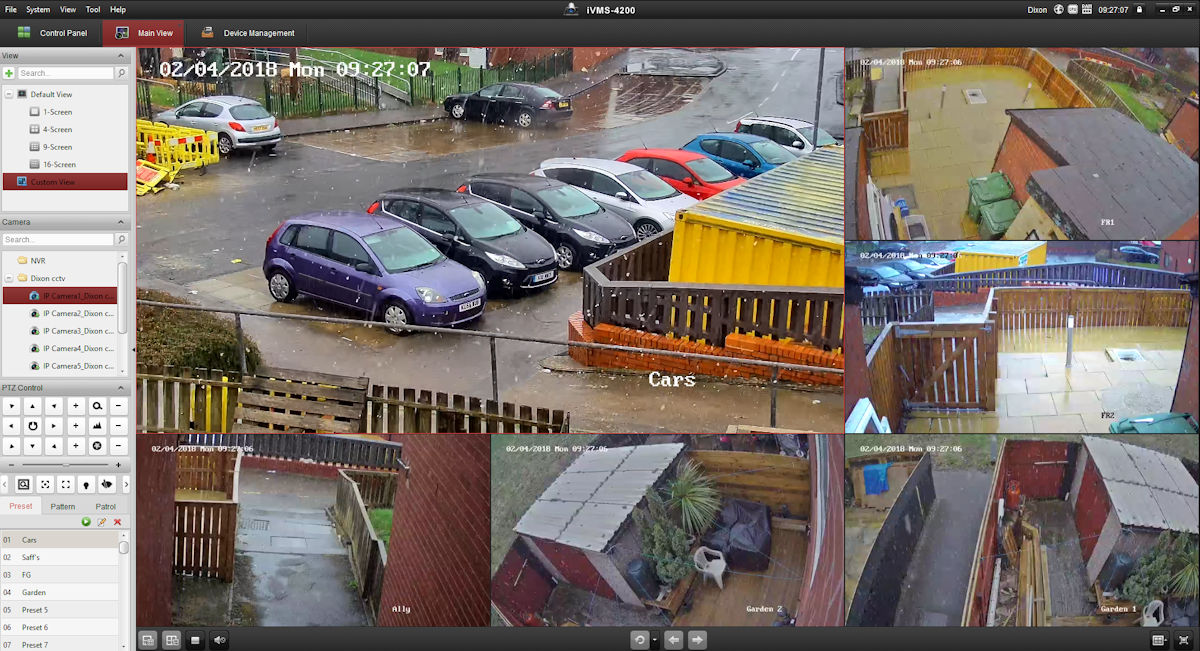

We have just replaced our old swann system with Hikvision from Use-ip
NVR DS-7608NI-K2-8P It's an 8 channel nvr. we have the choice to expand it, although there is only 2 channels left, you will also need a hard drive for it WD purple is the way to go
The 2385 is a suberb camera, we have 4 of them ranging from 4mm to 6 mm, not sure you would need a bracket, think that will depend on how you run your cable's, IE inside to out through the walls.
We also have a DS-2CD2342WD-I 12mm 4mp in the ally, maybe ideal for your shared access, and a PTZ over looking the car park.
We installed 3 of the camera's above the upstairs windows, that way it was easier getting the cable into the loft
1 camera (ally) installed high on the side of the house straight into the loft.
The other camera is just below the upstairs bedroom, that way we just run the cable along the skirting and upto the loft
Our Nvr is in the small bedroom and we have a monitor in the room also i bought another monitor that sits in the kitchen, we just bought a 10m long HDMI cable and run that too it.
As for controlling it from downstairs, i'm sure someone will be able to help on that
The key to the install (for me anyway) was planning planning and more planning, don't rush it
If i got stuck at all i got in touch with the staff at use ip who was more then willing to help
I have attached a pic of how our's looks, good luck
