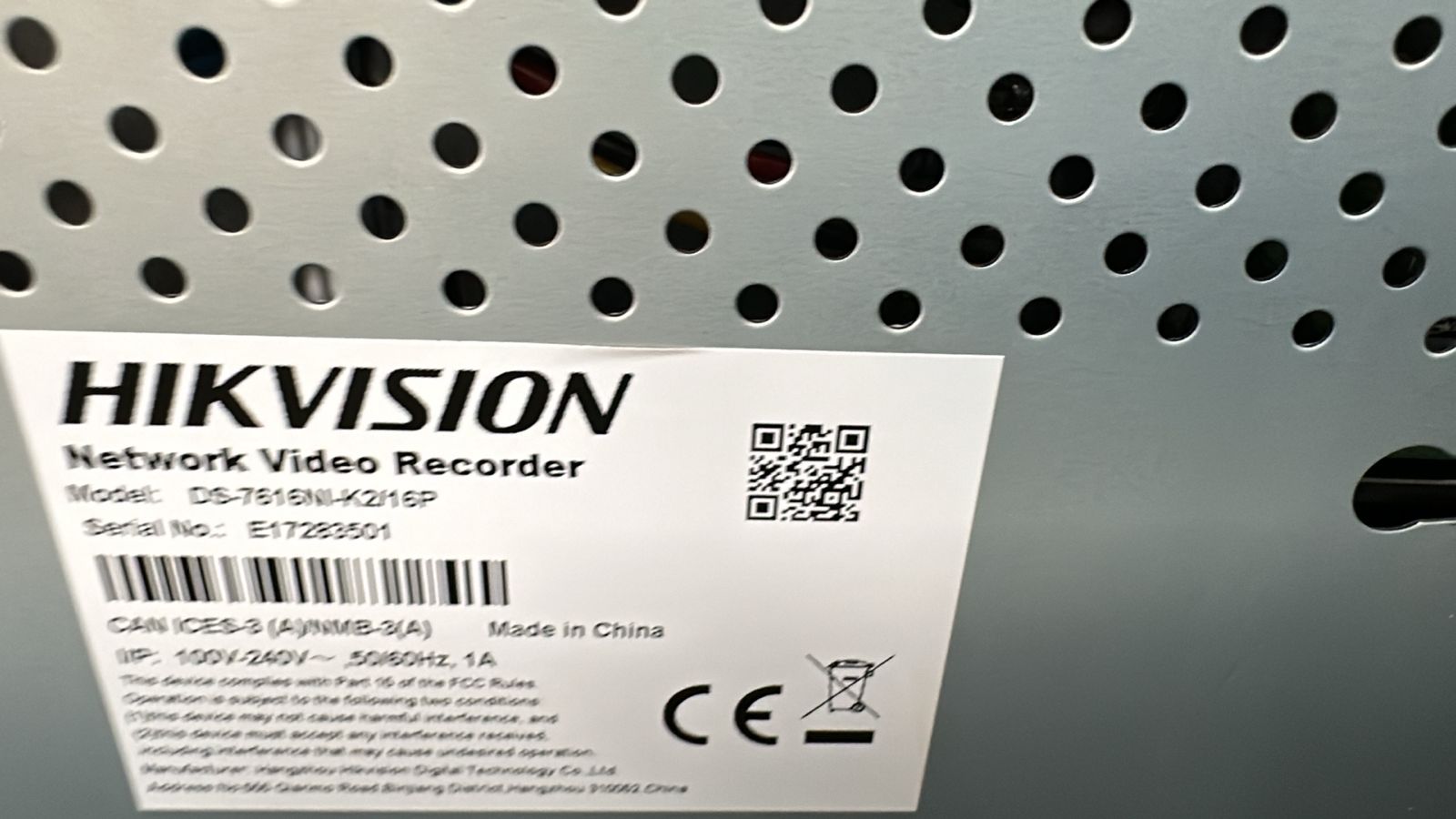

Hi dan,
my nvr model is DS-7608NI-Q2\8P and tried to connect it with camera ColorVu model DS-2CD2087G2-LK 8 MP but unfortunately does not work despite the quality of the image
what is ur advice?
