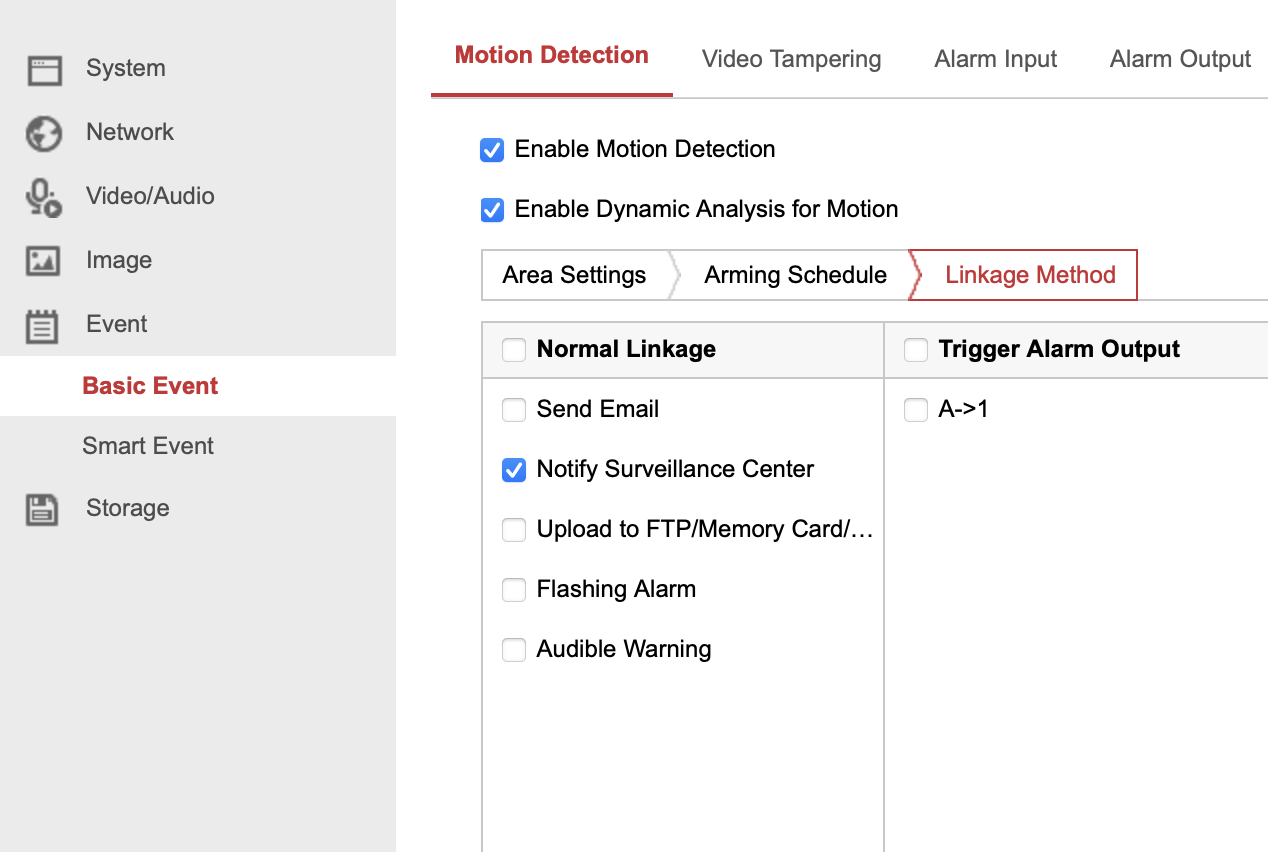

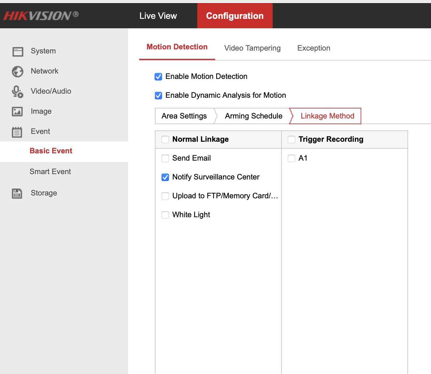

The LSU/SL variant never had that option as far as I'm aware. The option was only available on cameras without the strobe light. I have both the LU and the LSU/SL models and it's only on the LU even though they use the same firmware file (G5). It is not in the latest 230706 build for the LSU/SL and I'd not expect to see it added TBH.
To get around that, some people have just triggered the strobe, but altered the strobe settings so that it comes on permanently without flashing. You can do that in the camera - Basic Event > Flashing Alarm Light Output > Flashing Frequency (normally on). The flashing light is the middle LED. It is a different colour temperature (about 4000K) to the outer 2 LEDs that are used for illumination (about 3000K). It's not going to provide sufficient illumination for the camera to be able to produce a decent exposure if there's not enough light; that's what the ColorVu LEDs are for and if they need to be on, then they should be on. But if you do have sufficient light and you're just wanting an LED to come on as a deterrent without flashing, that workaround works fine.
LU (no strobe)
LSU/SL (with strobe)

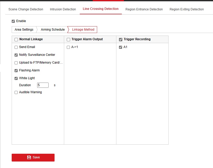

I have spoken to Hikvision support and they have assisted me with downgrading the Firmware
