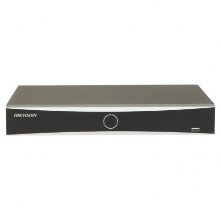

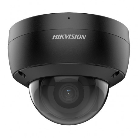

I’m looking at putting a small system together with this camera
And this NVR
The camera will be connected via PoE to the NVR but it is not possible to run any cable between the router and the NVR. If I use this wifi dongle with this specific NVR can anyone see any problems arising? Apologies if it seems a simple question but it’s the first time putting a system like this together.

There is no official compatibility list as such for the WiFi dongles that some versions of NVR can use (the NVR you specified can use a WiFi dongle that can be configured by the NVR) - some will work, some will not. It's possible to use a WiFi bridge such as the Vonets models (available on Amazon) to facilitate the connection but they need to be configured using another device first.
If you want to use a dongle that will work directly look for one that contains RTL8188EUS:8179 or RTL8192EU:818b in the PID. PID can be found in Properties > Hardware IDs on a PC that the dongle is connected to (that info was provided by Hikvision to me some time ago)
The WiFi functionality seems to have been removed in the latest firmware (4.76.005). There used to be a heading in the 7604NXI Network > General page but it's been removed (which is a backward step). I guess an externally configured wireless bridge or Powerline will have to be used where it's not practical to cable.

The TP-Link WiFi adapters that feature an RJ45 port on the bottom will work fine. I don't like them as they re-broadcast the WiFi network (at least they do in their default configuration). Perhaps that feature can be turned off using the software to make it a simple WiFi bridge which would be better. The Vonets VAP11N can be configured as a bridge.
I'm not sure why the WiFi configuration would've been removed. It definitely was present on a 7604NXI NVR I used recently but is also definitely missing on the one that I unboxed last week. I updated the firmware using web browser prior to connecting it to a monitor so can't be sure when it was removed.
