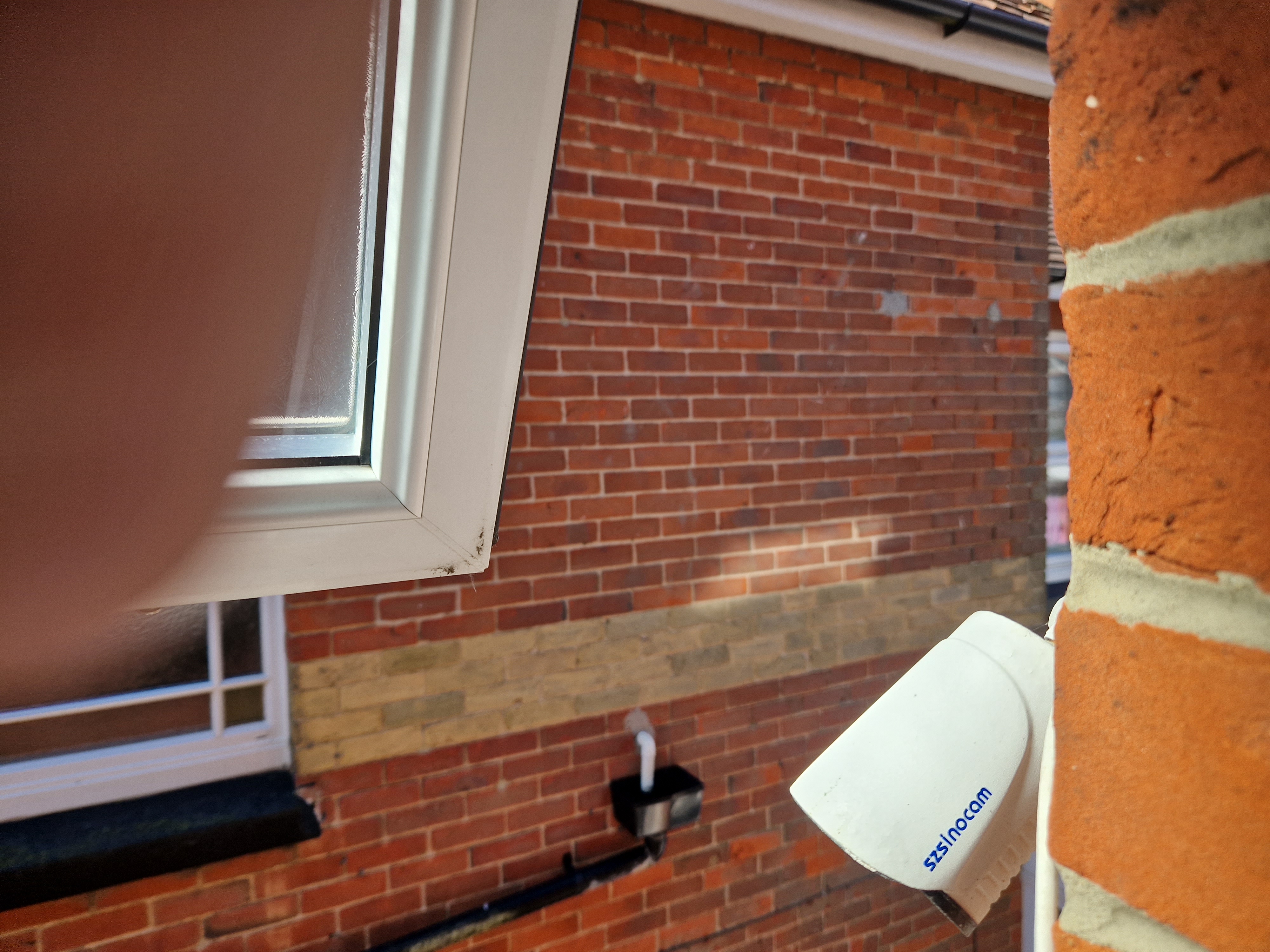

I don't know the model number, but these are the cameras.
okay,
I can't see this exact model on Szsinocam website, but some of their other bullet cameras do support 64GB MicroSD cards so it may be possible to run your cameras on their own using MicroSD cards but the only way to be sure would be to take the camera down and get hands-on to check for the card slot.
I was hoping to record to the cloud, but I first need to get them connected to the wifi!
Yeah, once the cameras are connected to your local WiFi it should be possible to link them to a 3rd-party CCTV Cloud Storage Service. (but there will be ongoing subscription costs when using a cloud service)
