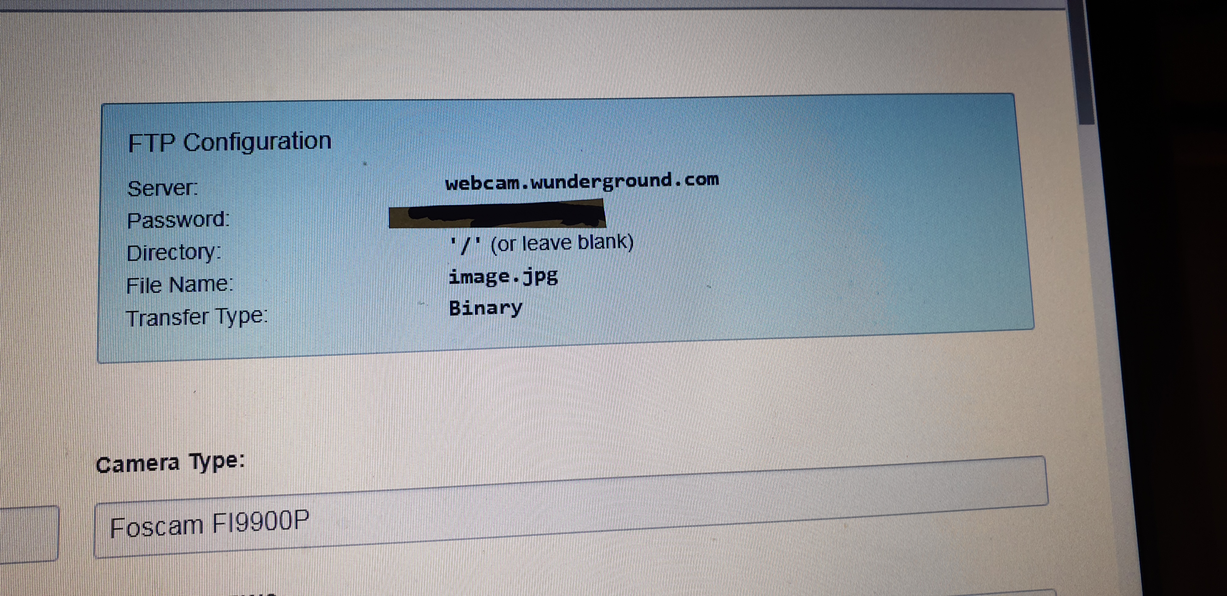

I would like to add Pics/video to Wunderground website
Wunderground have given me the following settings :
FTP Configuration​
Server:
webcam.wunderground.com
Password:
Directory:
'/' (or leave blank)
File Name:
Transfer Type :
Binary
I have filled in above data on " FTP SETTINGS" Tab, No pictures transmitted to Personal Weather Station Dashboard | Weather Underground so there is a problem.

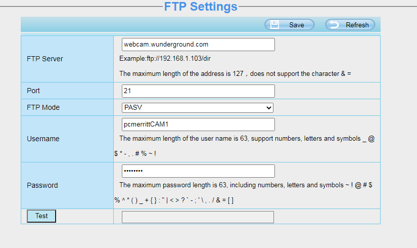

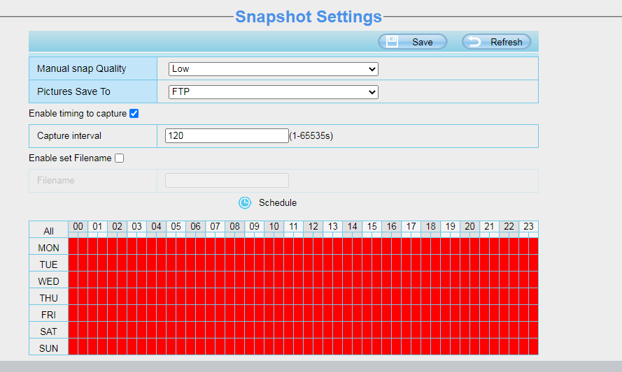

Can you please post a screenshot here of the settings page?
It probably wants you to enter details such as your router/gateway IP and some DNS options too.
Phil,
Many Thanks for taking time to reply.

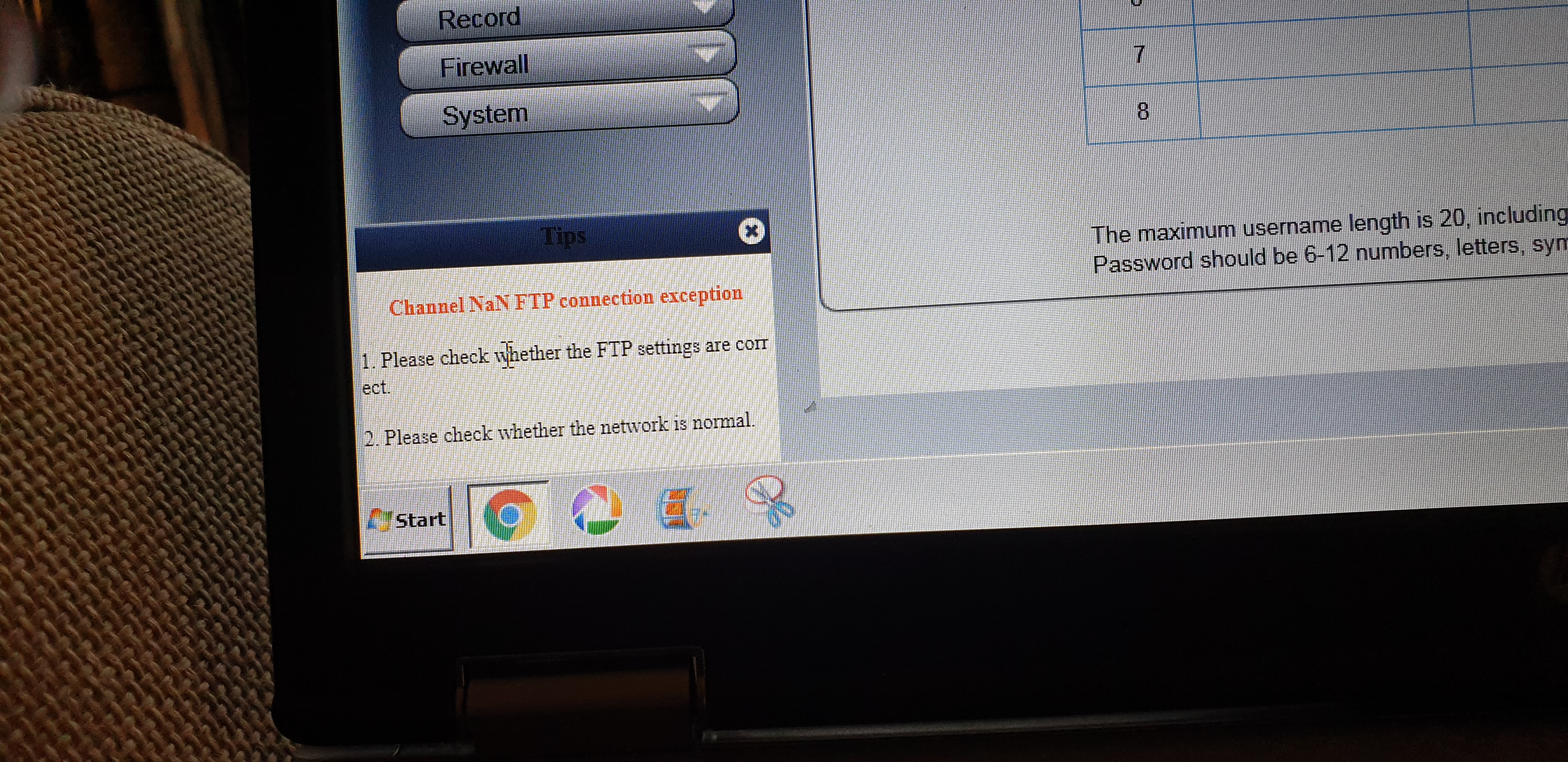

Attached 3 screenshots of settings and on Foscam 4 you will see an error message in bottom left....

What are the other options in the dropdown for "FTP Mode" please?

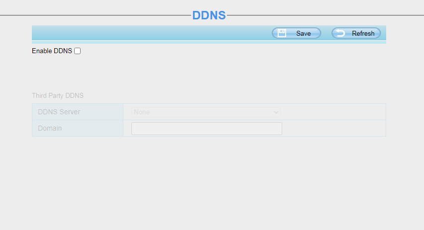

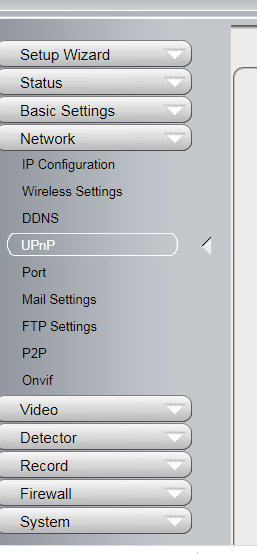

Can you also share a screenshot of the camera's configuration page for Network Settings please?
Options for FTP Mode : PASV or PORT
Not sure which Network setttings you need.........I have sent a master menu screengrab and also Wunderground settings.....

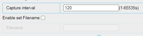

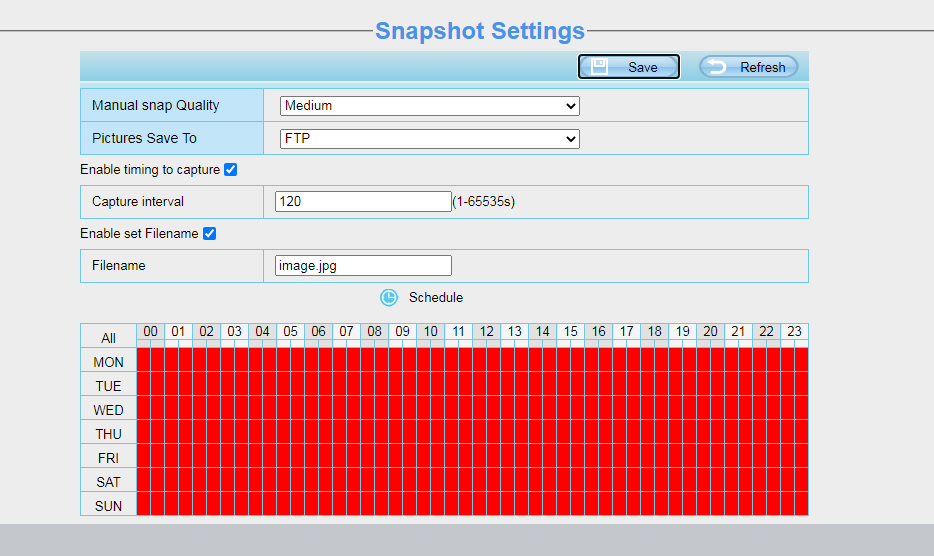

Put a tick in "Enable set Filename" and enter the filename that Wunderground have asked you to use e.g. image.jpg
When you enable set filename, you may then get a further dropdown to allow you to set the file type to a .jpg (JPEG) - if not, then type it fully as image.jpg.

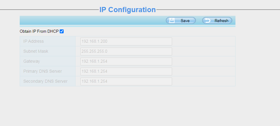

However, this is NOT what is causing the error message - please share a screenshot of the IP Configuration page.
Thank you for your patience...........
Those settings look OK. :)
What happens if you switch from Passive to PORT FTP mode and test again?
If it asks for a Port number, and Wunderground have not stated one, then try with 21.
Toggeled between Passive & Port............Port number was 21
No Change

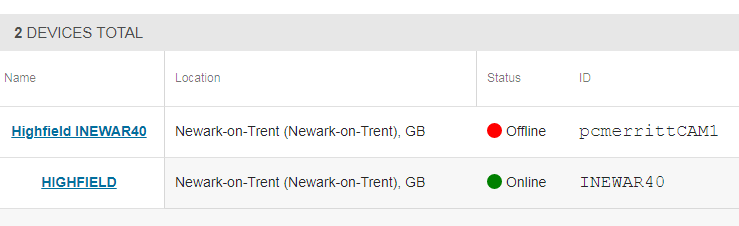

Camera remains inactive as per wunderground.....
I guess, as it is just FTP that you are setting up, that portal considers the camera as 'Online' after it has received an image from it?
What happens when you click the Test button for FTP now?
I guess the other camera in your account is a different model, and therefore you cannot crib settings from it?

The other device is a PWS ( personal weather station )
Personal Weather Station Dashboard | Weather Underground Has my weatherstation which sends weather data to wunderground. Bottom left of page is where you link up a camera ( Associated camera ) . You can have data & video / pics.........only data is working.
