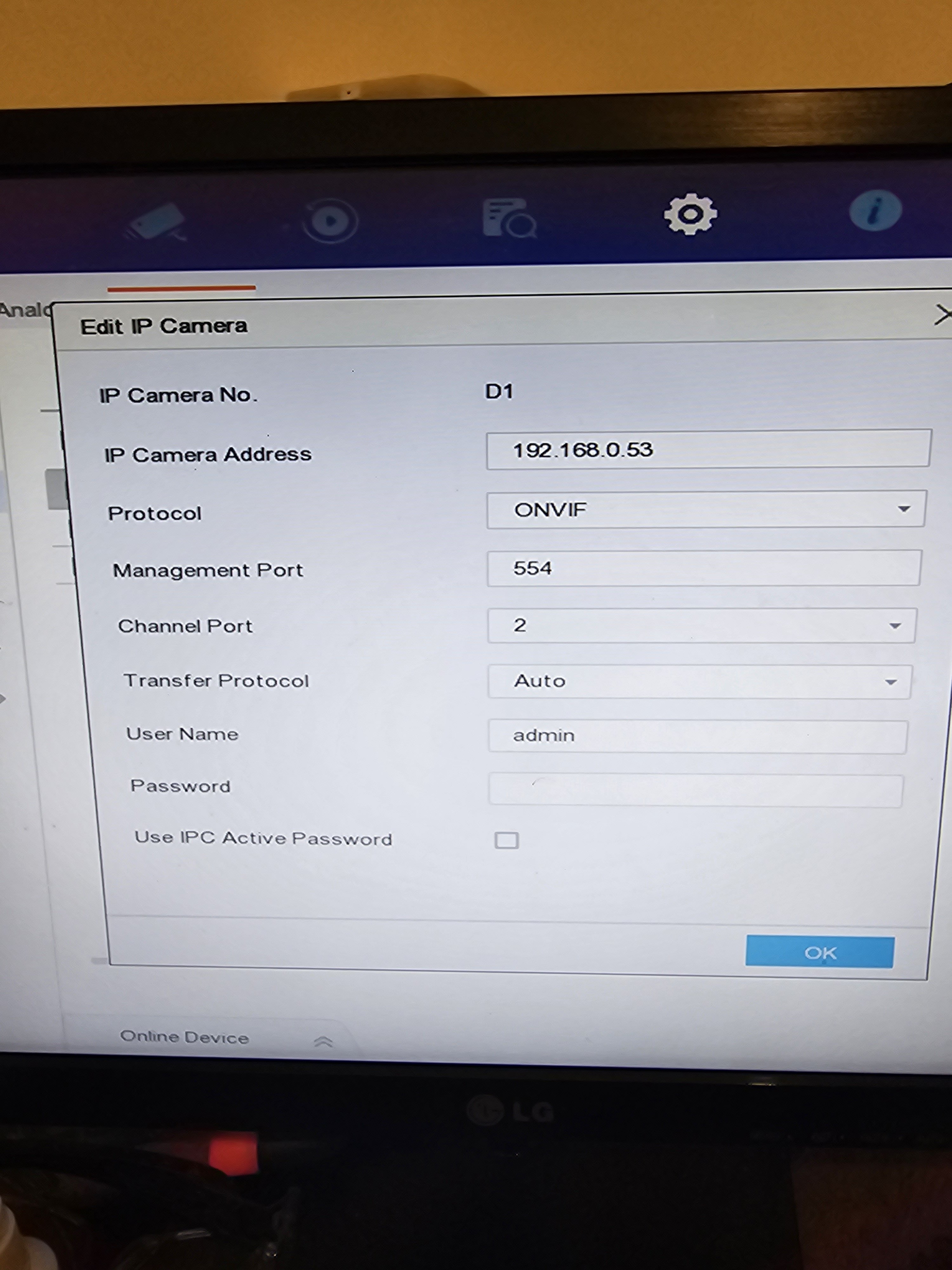

Im trying to add Zosi ip camera c290 to my ANNKE DW81KD CCTV system every time I go to add this camera it fails to connect via ONVIF I have the cameras IP address but I`m unable to connect to cam via web interface.
But yet I can connect to this cam via zosi mobile app without any issues.
I have also tried different ports in the management port section.
Like port 80
8000
554
None of these work any advice would be much appreciated.

I've had a closer look at the specs of your DVR and Zosi camera, when I search for the Zosi model on the ONVIF Conformant Product List I cannot find it and I also see no mention of ONVIF on the C290 product page at the Zosi website.
This suggests that Zosi is not an ONVIF-compliant brand so you probably won't be able to add it to a 3rd-party recorder, it is quite common for cheap Chinese brands to not be ONVIF compliant as they often promote themselves as "closed loop" brands (e.g. you must use Zosi Camera with Zosi Recorder & Zosi App).
Also, found this article on the Zosi website for another camera model confirming no ONVIF support.
Thanks mate I have ordered a onvif compliant camera yesterday I'm giving this Zosi one to my father in law.
