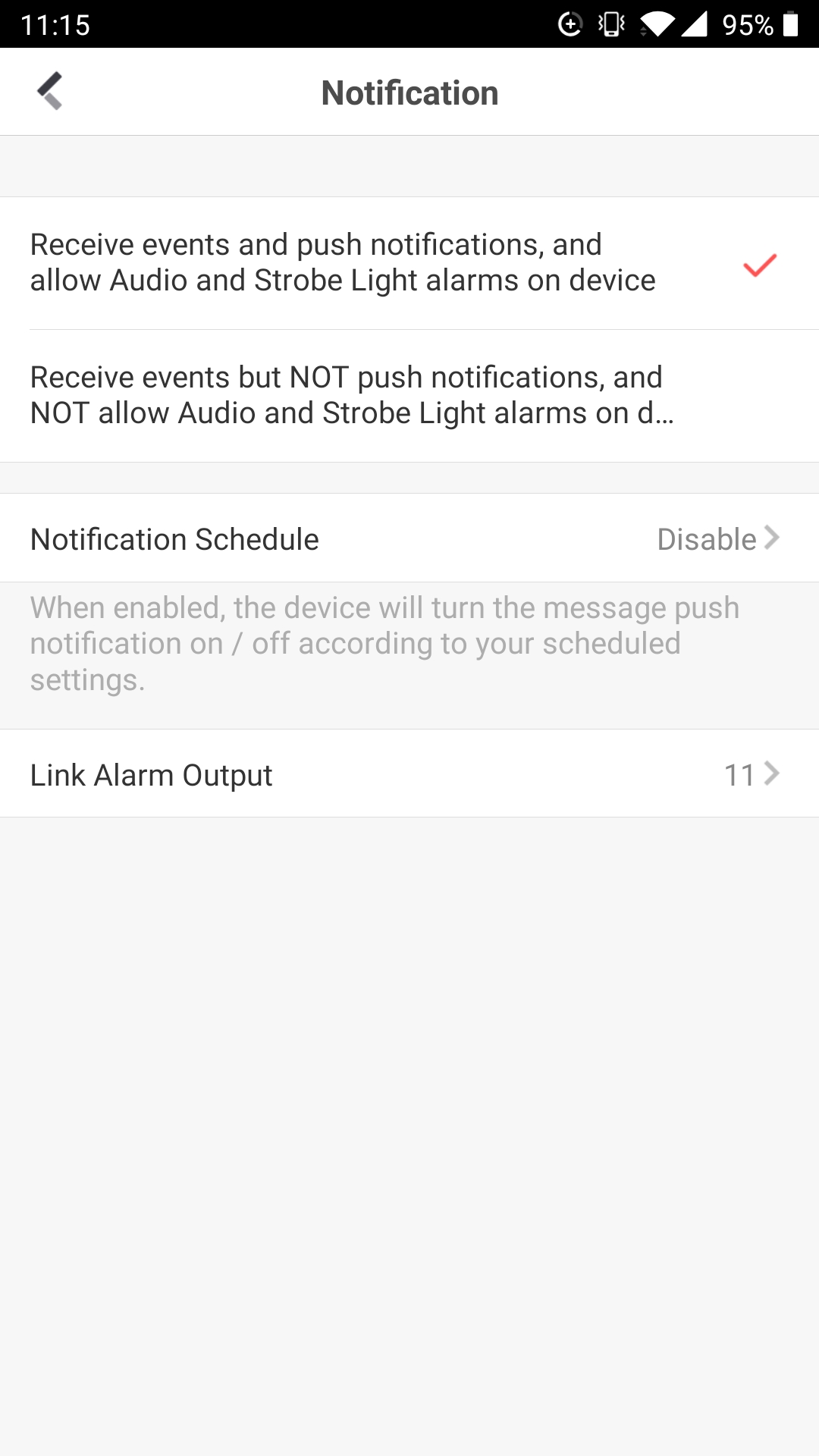

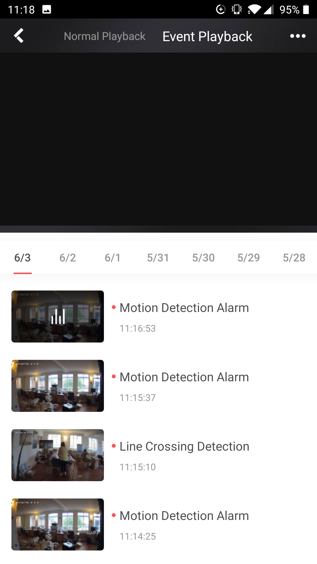

I have trouble to set up region entrance alarm and/or recieve a warning via Hik Connect smartphone application (iOS).
Setup:
Hikvision DS-2CD2086G2-I(2.8mm) AcuSense camera
Hikvision DS-7608NXI-I2/4S AcuSense NVR
First try:

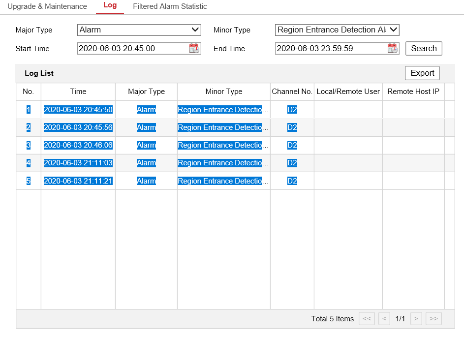

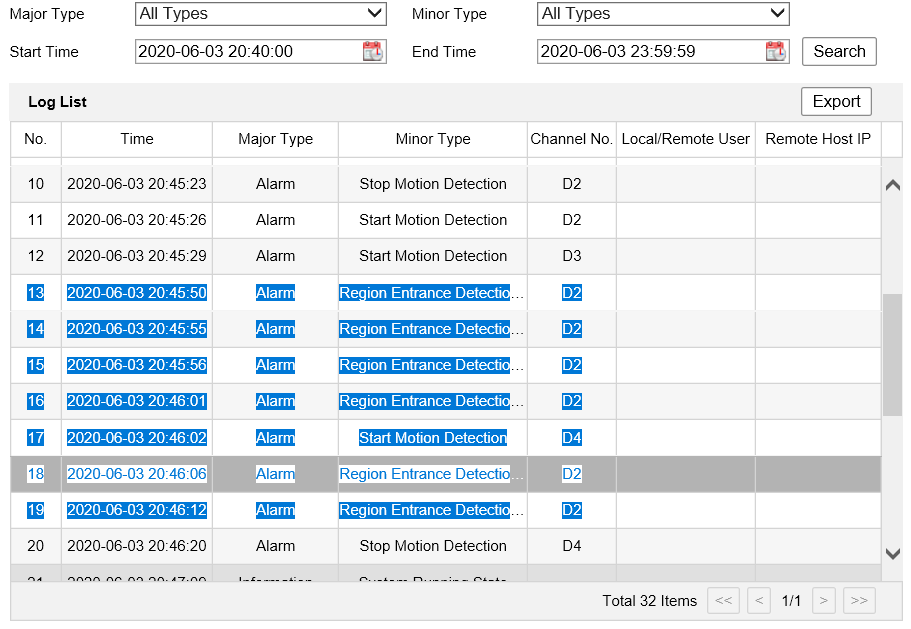

Set via NVR configuration menu: region entrance detection surface, arming schedule, notify Surveillance Center enabled, sensitivity between 50 and 90 even 100!
- no alarm in Hik Connect application
- in NVR log there is some trace: D2 camera log shows region entrance detection
Second try:
Set via camera web interface configuration menu: region entrance detection surface, arming schedule, notify Surveillance Center enabled, sensitivity between 50 and 90
- no log in NVR for region entrance detection
I have tried local (camera based) or NVR based (Enable Local Smart Analysis) option for processing, but nothing helps.
Issues:
- Hik Connect application never gives a warning.
- If I configure the camera through NVR then at least the camera logs show region entrance detection entrance event.
- If I configure the camera directly using web browser, nothing happens, no alarm, no logs.
Do you have any pointers?
