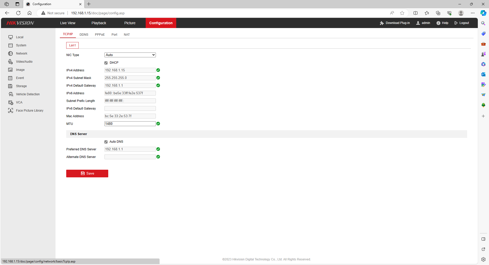

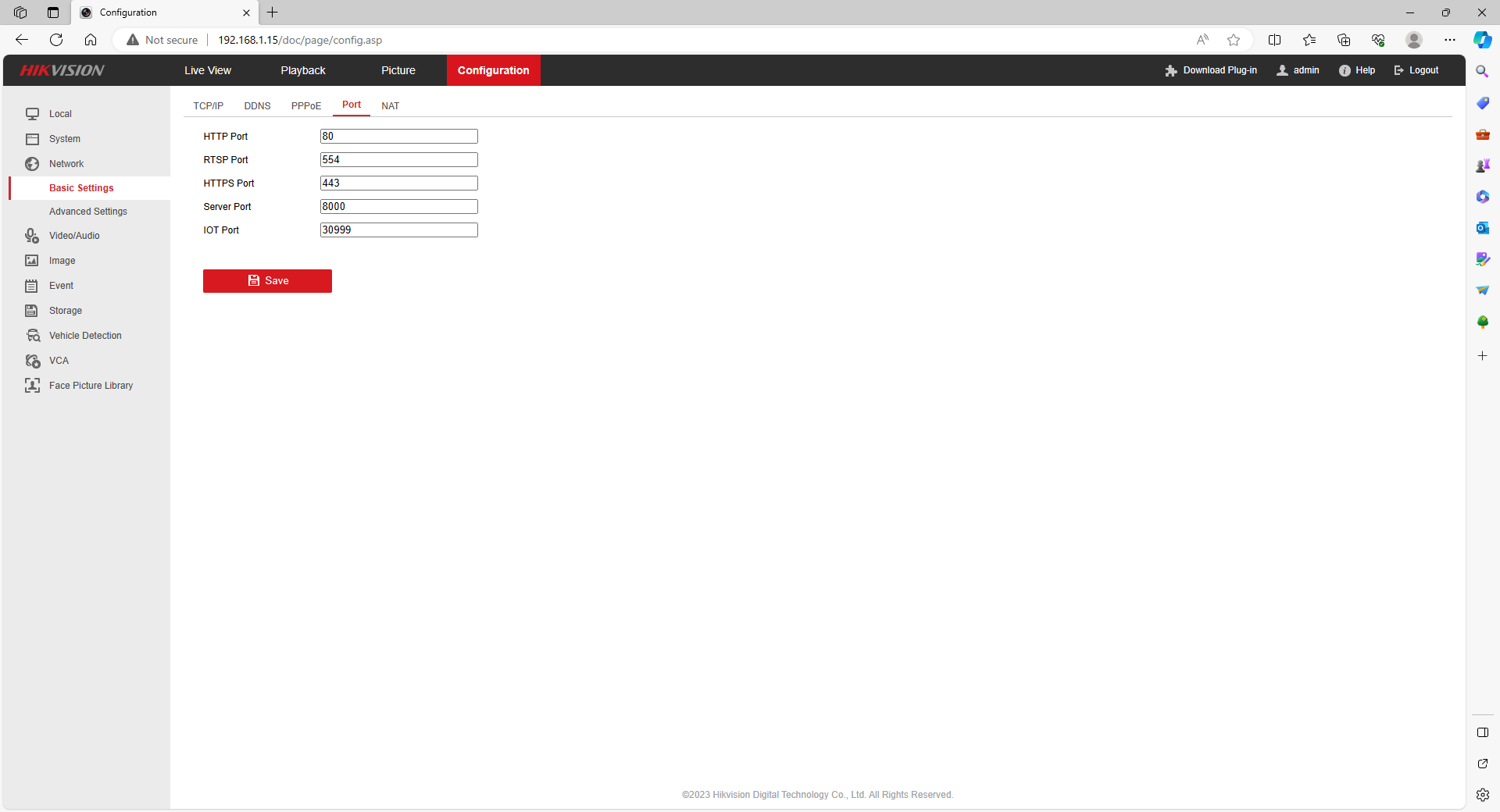

Ipv4 address and port 8000

I foresee issues as you've used DHCP not Static addressing. At some point your NVR, door station, indoor station will be powered down and they may be assigned a different address from the router at boot up. The doorbell and indoor station are (should be) paired to one another so if the IP addresses change they're no longer paired until the settings are amended.

The DHCP is now disabled, thank you for that point.

Thank you for advising on the nvr IP to connect devices. After trial and error I discovered the port setting that worked was the RTSP 554. I successfully got 2 cameras linked on the monitor but puzzling the 3rd (garden) on channel 3 reports live view failed as the encoding is not supported. I assume it's referring to H.265? I checked and all cameras are the same from the adjustments we made yesterday.
Yeah that might have been due to DHCP. The update and subsequent reboot could've caused the router to issue a different IP address and so the monitor would've been paired to wrong IP. Using static IP addresses prevents those things from reoccurring
Yeah I couldn't actually remember whether it used the RTSP port or the Server port but at least you have those two working now. I think if you check the sub stream settings you'll find the two that are working on the indoor station (Cameras 1 & 2) will be H264 and the one that's not will be H265. If that's the case, just copy the sub stream settings to Cam 3
