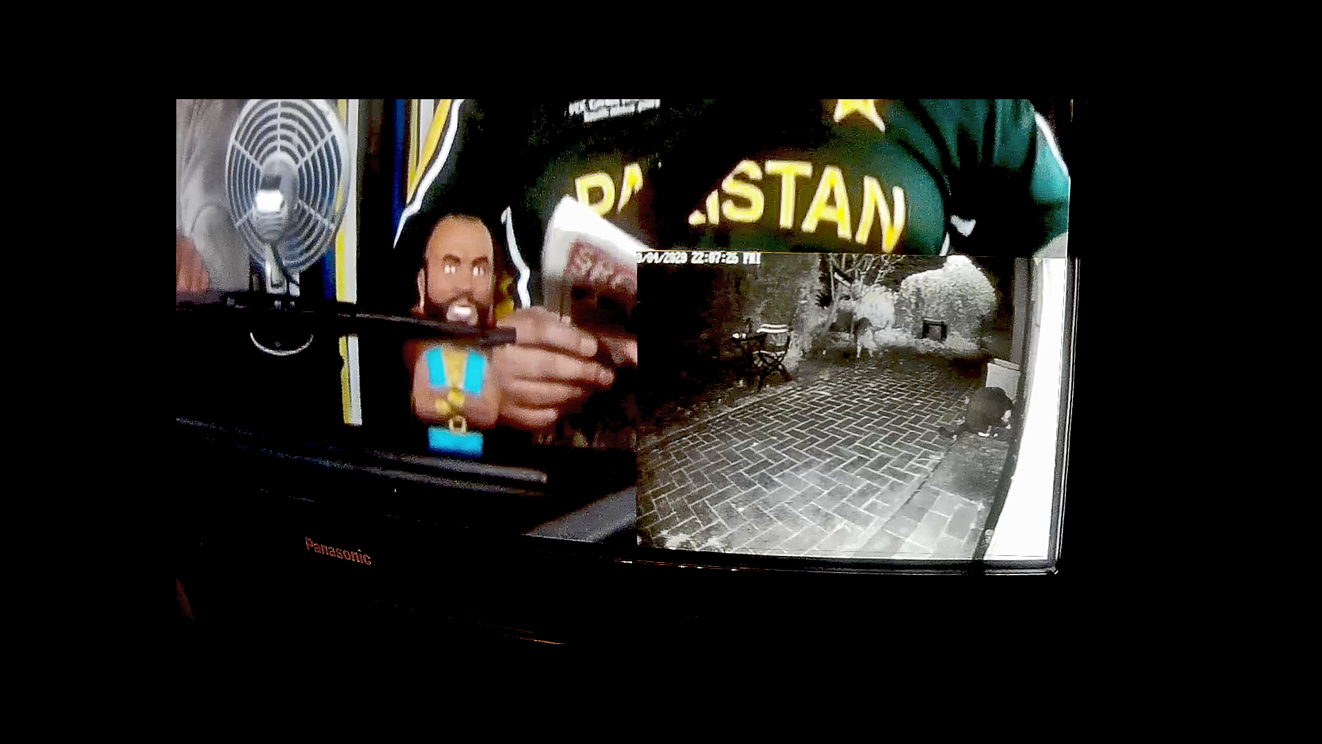

Connect an Android TV streaming box like the Nvidia Shield to your TV via HDMI and sideload Hik-Connect onto it. You can then view your cameras by switching AV channel on your TV or by playing the feed in PiP if your TV supports it. You'll need a cordless air mouse (or cordless keyboard with a trackpad cursor) for the Nvidia box. Works for me.
