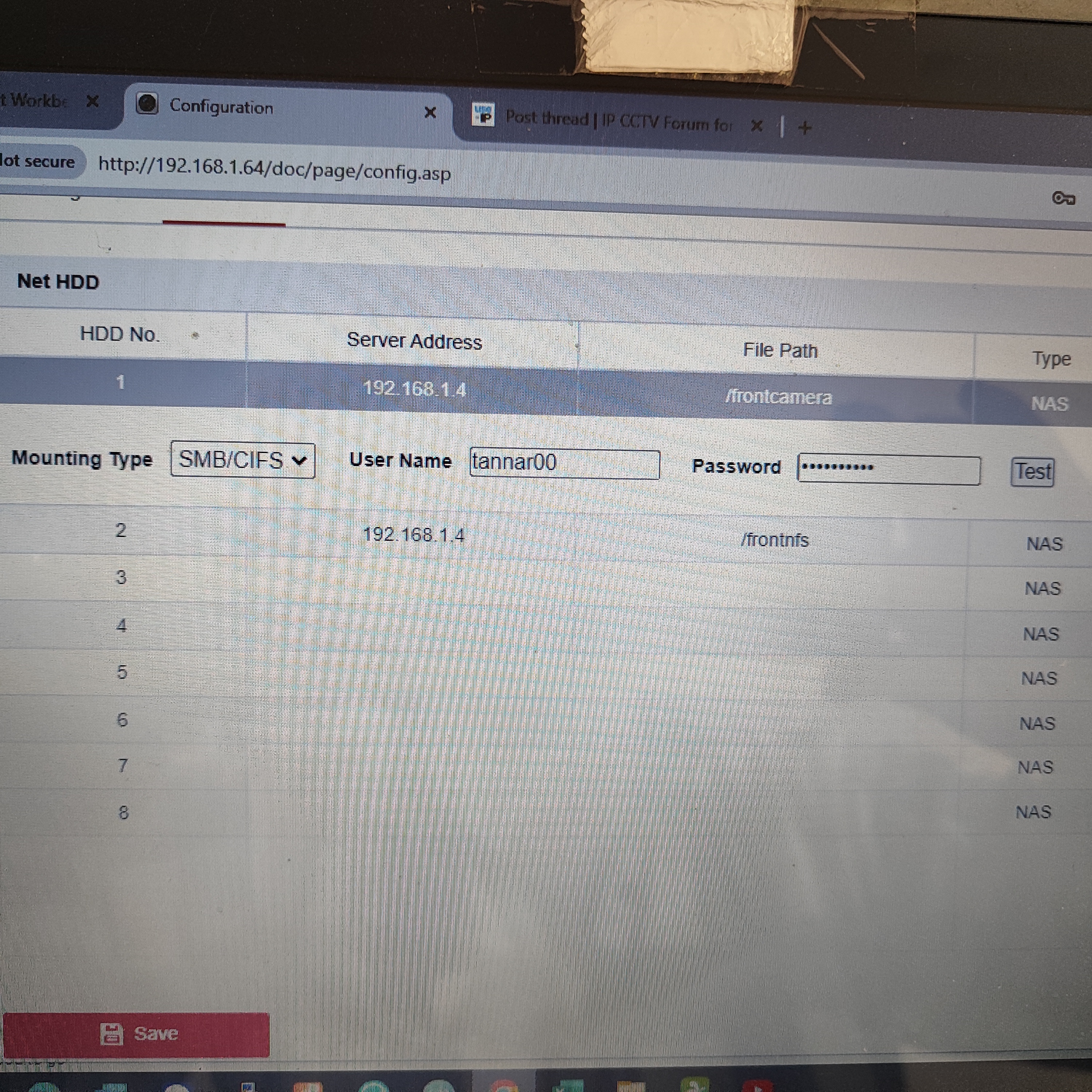

I have a Hikvision DS-2CD2347G1 fixed turret which is working fine through the web portal.
I also have a NAS running through openmediavault with a dedicated HDD set up both as a NFS share and SMB/CIFS share. I can access the share folder through SMB/CIFS on a windows machine.
However, when I setup through netHDD for the life of me, I just can not get either NFS or SMB/CIFS to successfully test.
Any ideas of what I might be doing wrong? IMG_20240517_083745.jpgIMG_20240517_083751.jpg

I have the Hikvision user manual and have followed it to set it up but I still can't get it to work, hence why I thought maybe it is how I am writing the filepath of the NAS etc?
