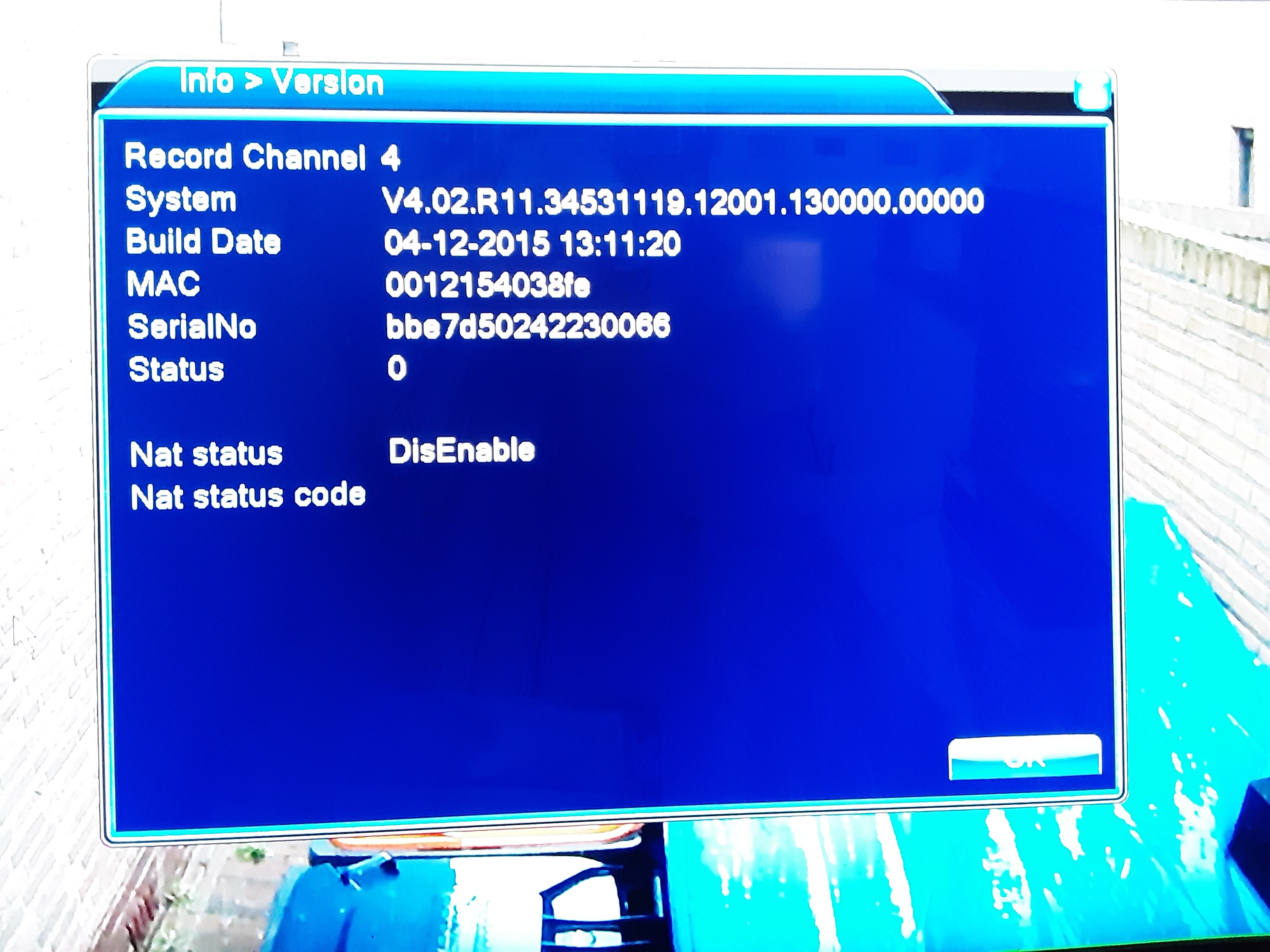

Dvr IP address will not connect?
It now says Nat status DisEnable is this correct?

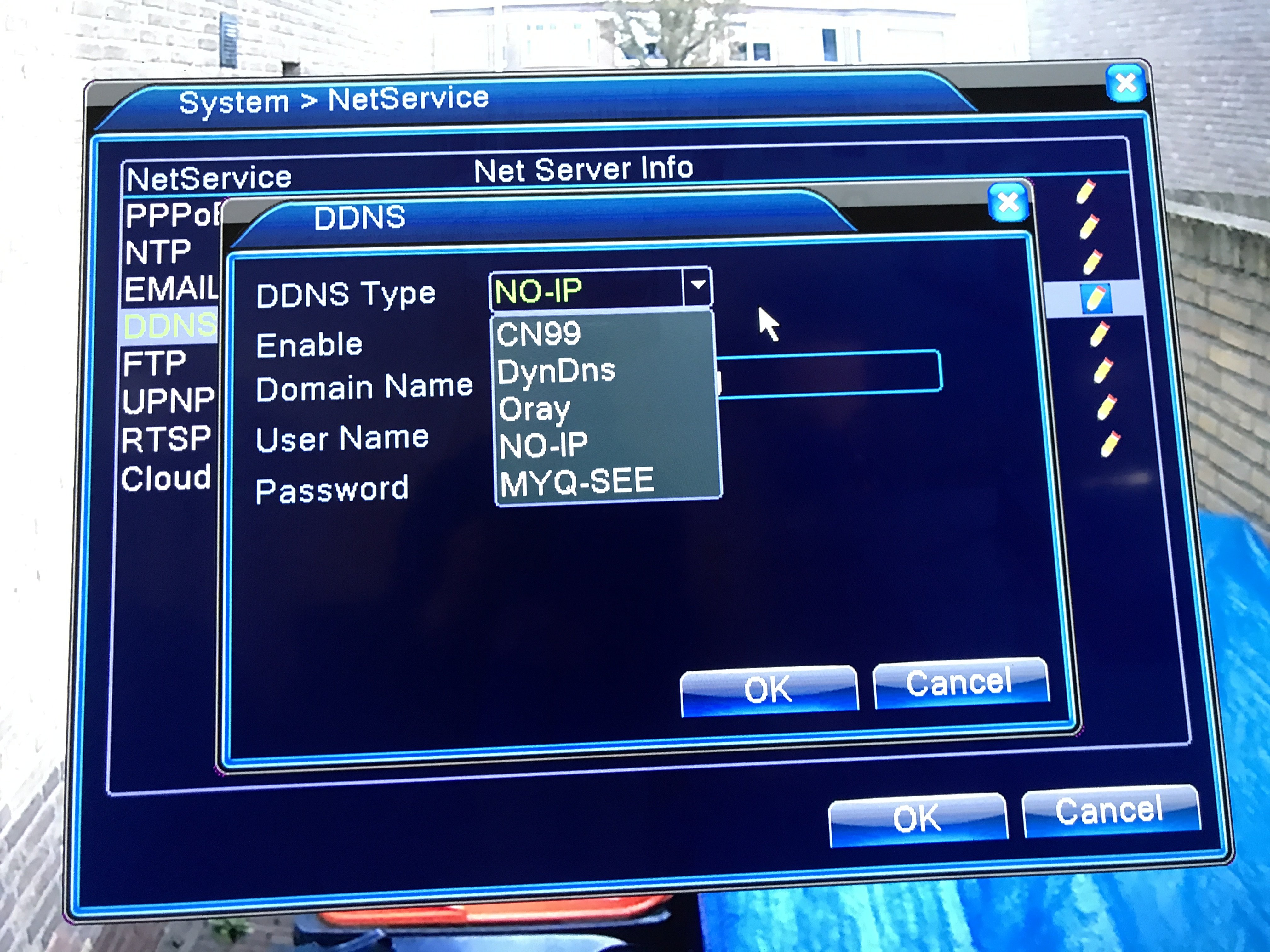

Should i be using No-ip for the ddns?
I'm not sure what it means in this context, I think it is related to the cloud connection.
No-IP is fine, are there other options?

Before i restart does the info look correct?
Apart from the username and password i have kept the domain name the same as i was given the details, it’s a free account but needs updating every month.
looks ok, can you post the network settings?
