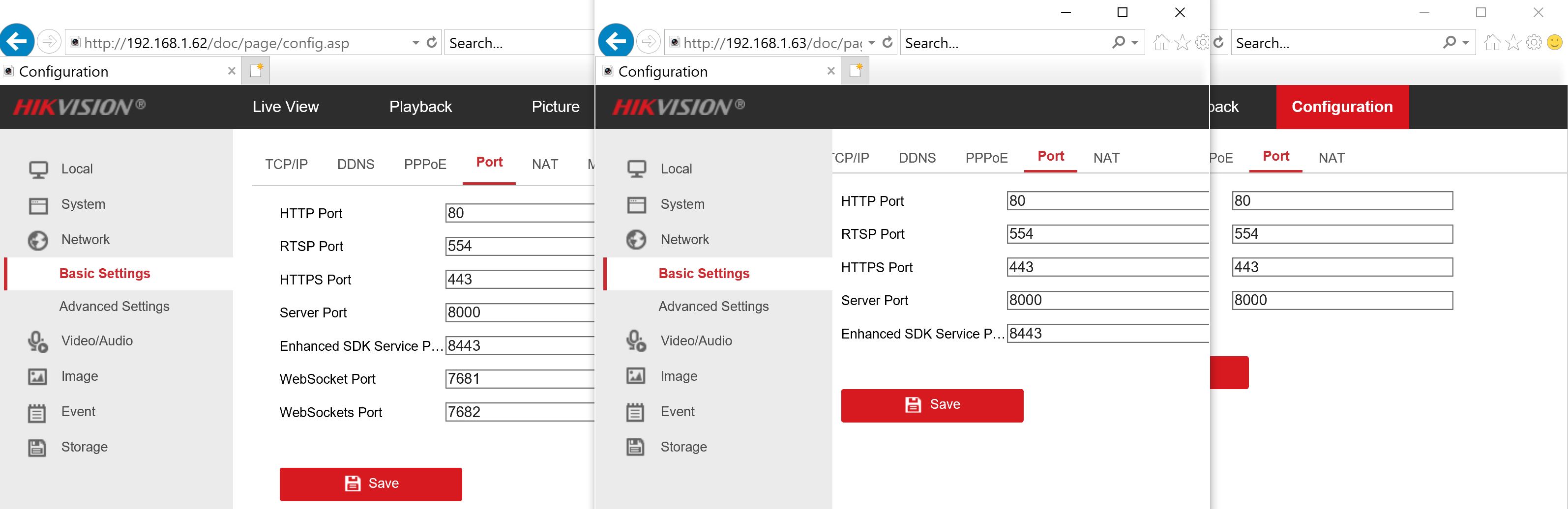

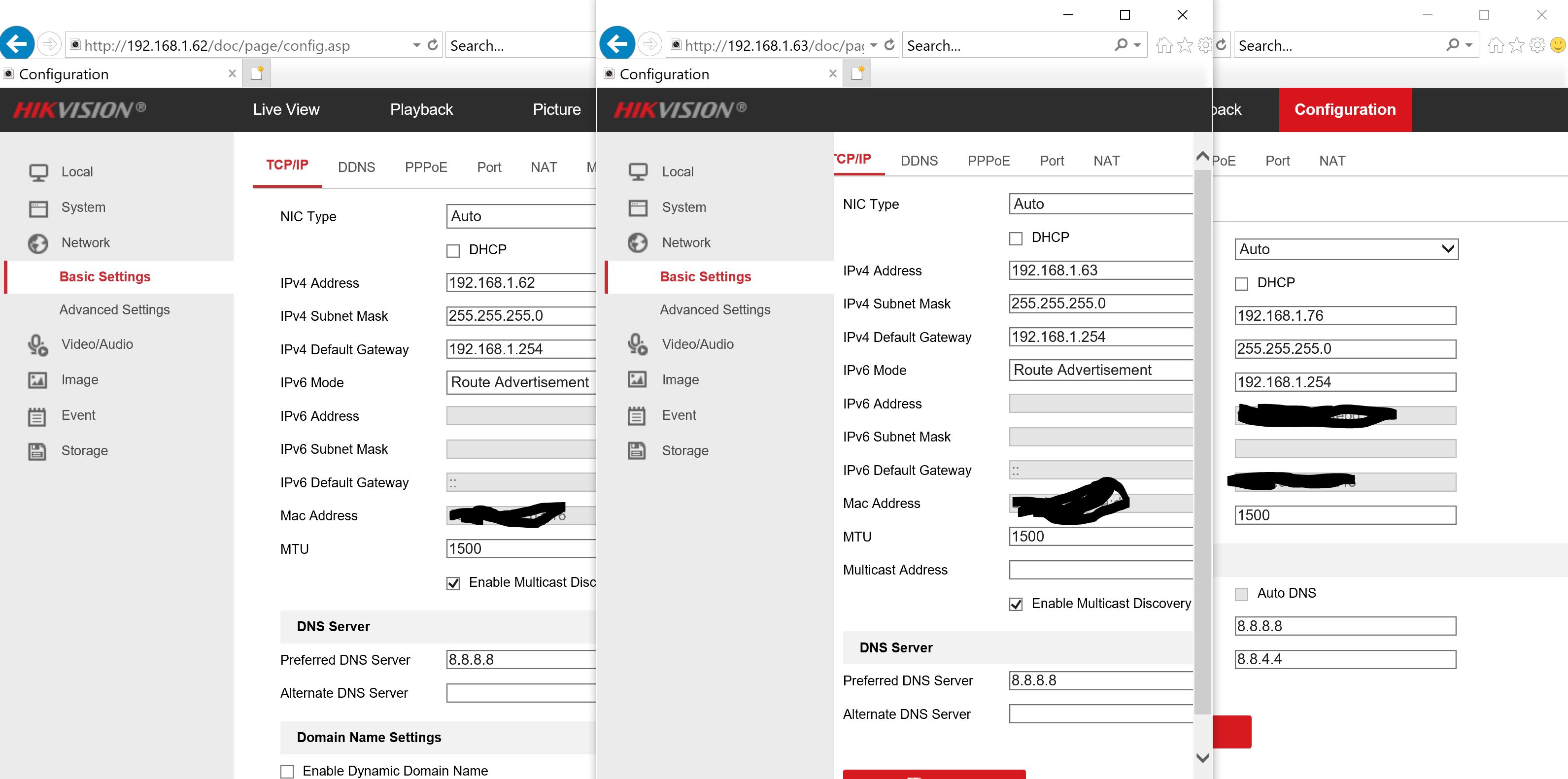

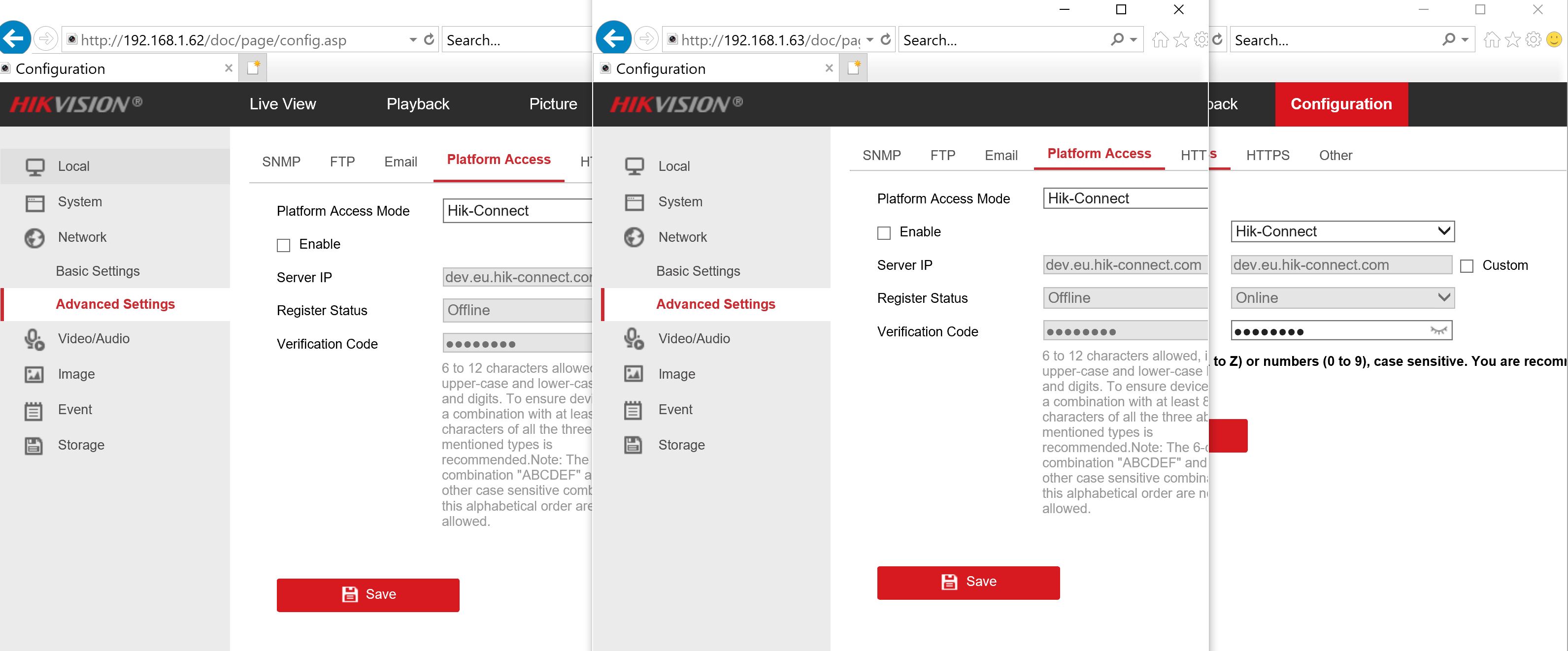

Here are some Network settings screenshots to see if i missed anything. In each image, on the left is the working RoofCam, in the middle is the DoorCam and the right is the NVR.
The last screenshot shows that I havent 'enabled' Hik-Connect individually on the Cams, only on the NVR. But the NVR should push through both feeds, so just one is odd. If I try to 'enable' the cams individually, the RoofCam works fine but the DoorCam doesnt work.

One test you could try. Enable Platform Access on the DoorCam and register it on the Hik-connect portal (using the same account you used for the NVR) by searching for the serial number. You can have the NVR registered with the cameras connected and have the cameras registered independently.
Once added, close and re-open the Hik-connect app on your mobile device and you should then see both the NVR and the DoorCam listed as separate entries. If so, check if the live view works. This will help narrow down the issue.
Out of interest, if you disconnect the RoofCam (power it off) then open the Hik-connect app, does the live view for the DoorCam still not work? Is there an error code?
I disconnected both cams from the poe port for a while and then plugged DoorCam back in and it worked. RoofCam also worked when back online. So both now work via the NVR registration.
Still cant get the DoorCam to register as 'online' in the 'Platform' section of the web GUI, or to accept as its own device directly onto HIK-Connect.com (RoofCam installed fine) but not necessarily a problem as at least it works (for now!) via the NVR device under HikConnect.
