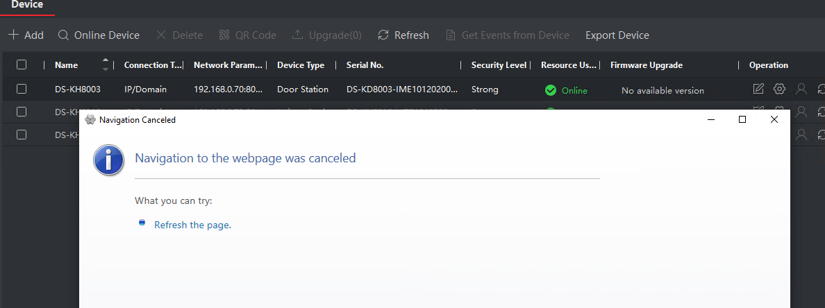

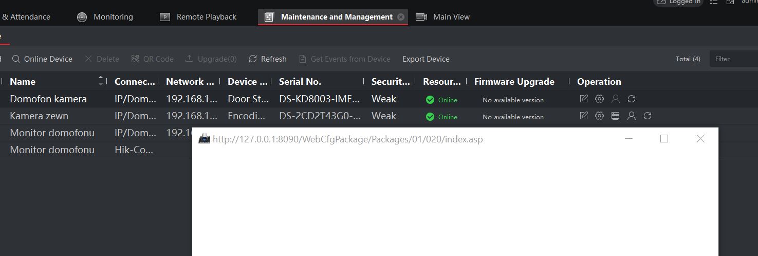

- I did a firmware update of outdoor station to the newest release V 2.2.62 built 230110. Update was successful, everything works fine (live view on the indoor unit, on the app, calls) etc) but after the update, I have no access to settings of outdoor unit over iVMS-4200 (the newest version 3.6.1.3)
When I click to cog wheel of DS-KD8003-IME1 I see only a blank page linked to http://127.0.0.1:8090/WebCfgPackage/Packages/01/020/index.asp
So I am not able to see any settings nor to make a firmware upgrade (or downgrade)

How to solve problem of lack of access to setup of outdoor unit over iVMS-4200 ? It seems to me that it might bring about problem with missing pictures.

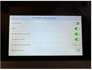

Hi, on newest FW you need to enable that option. Go to Settings, choose little house (third option on side), enable it and choose call management center, snapshot...
Do you have a picture of the steps mentioned. It is not clear to me where I can make a change. I can no longer go to the website of DS-KD8003-IME1 : Via the website I get this error message : Access Error: 404 -- Not Found Can't locate document: /
Do this trought indoor unit it self. On screen. Not trought outdoor unit.
Touch screen inside the building - DS-KH6320-WTE1/EU.

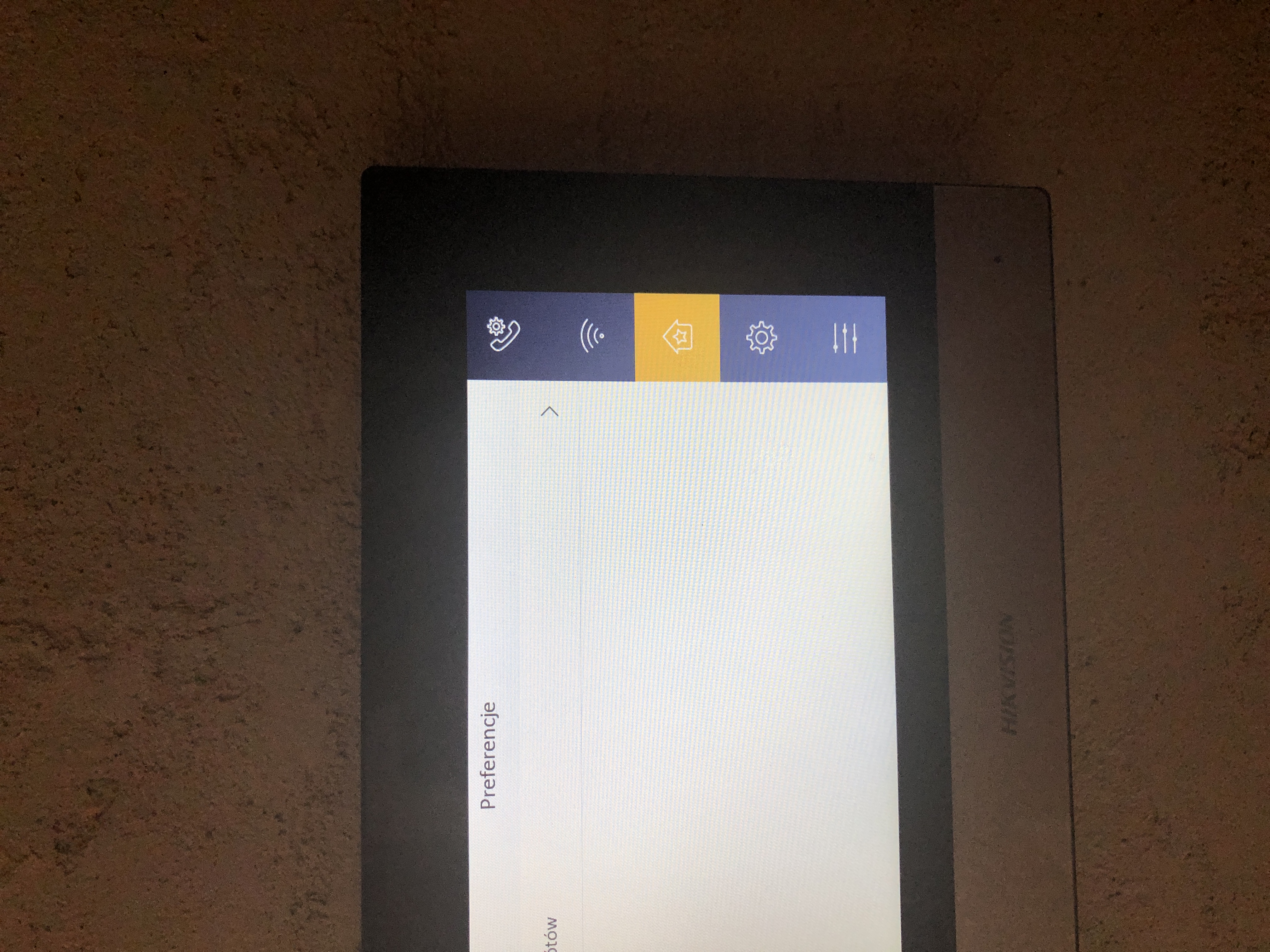

Cog wheel (Settings), then Preferences (little house icon with star inside)
