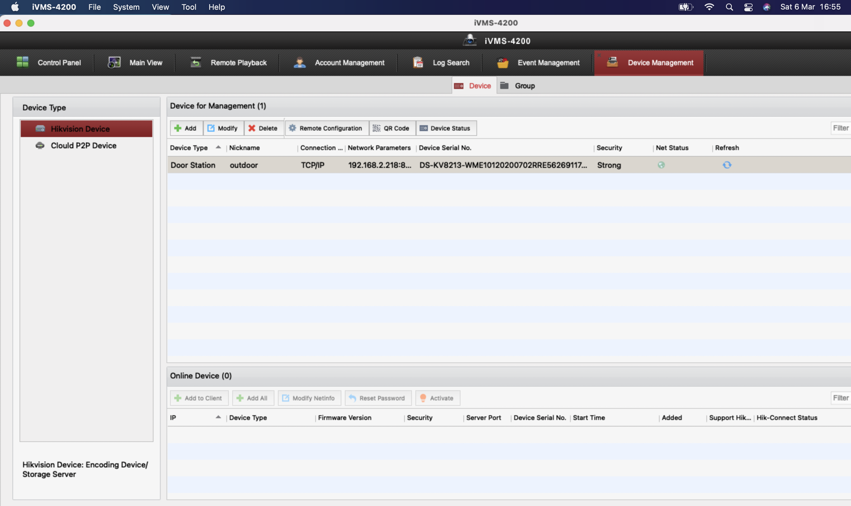

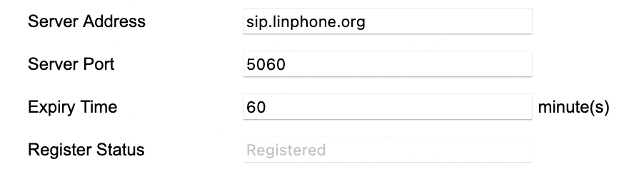

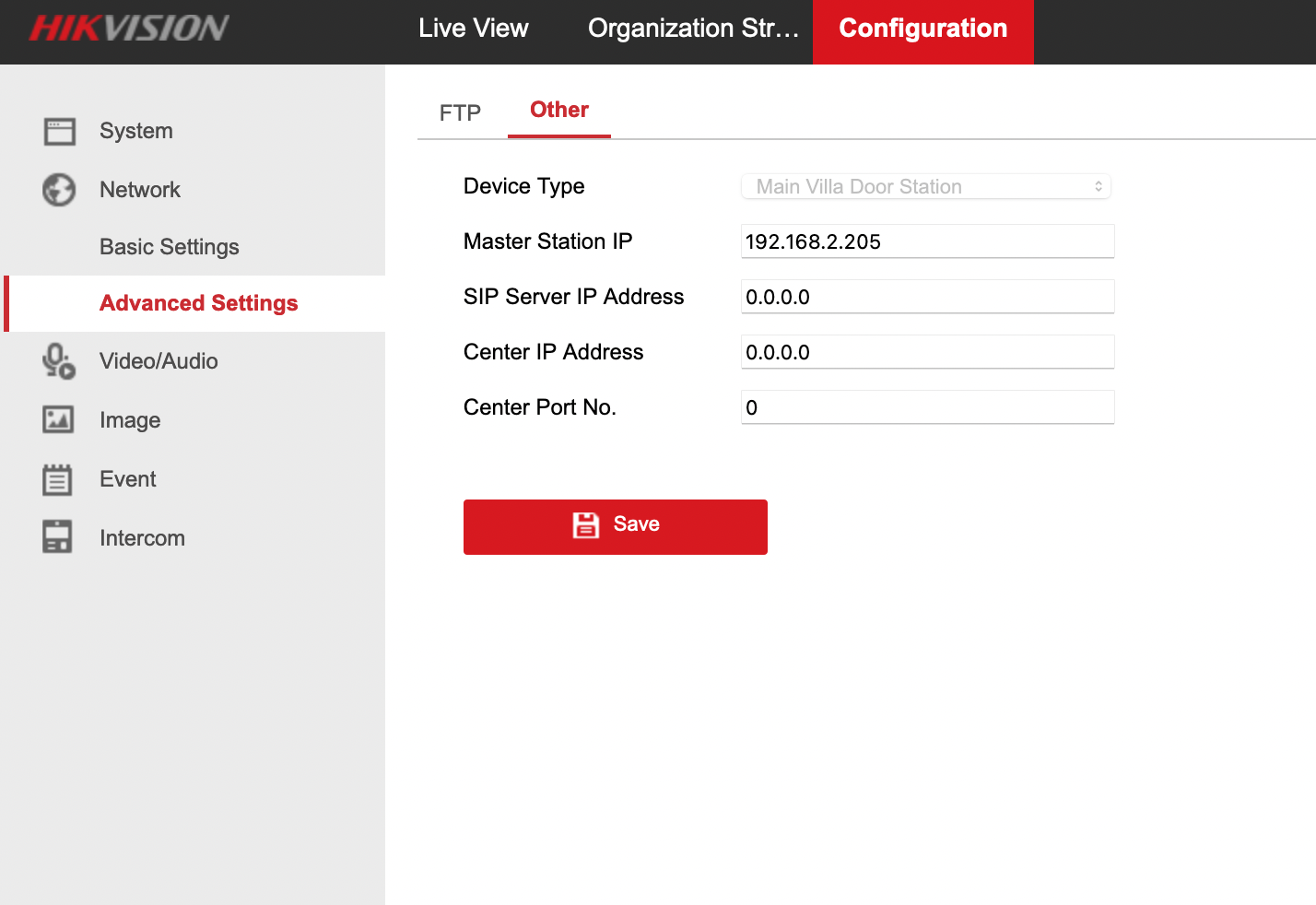

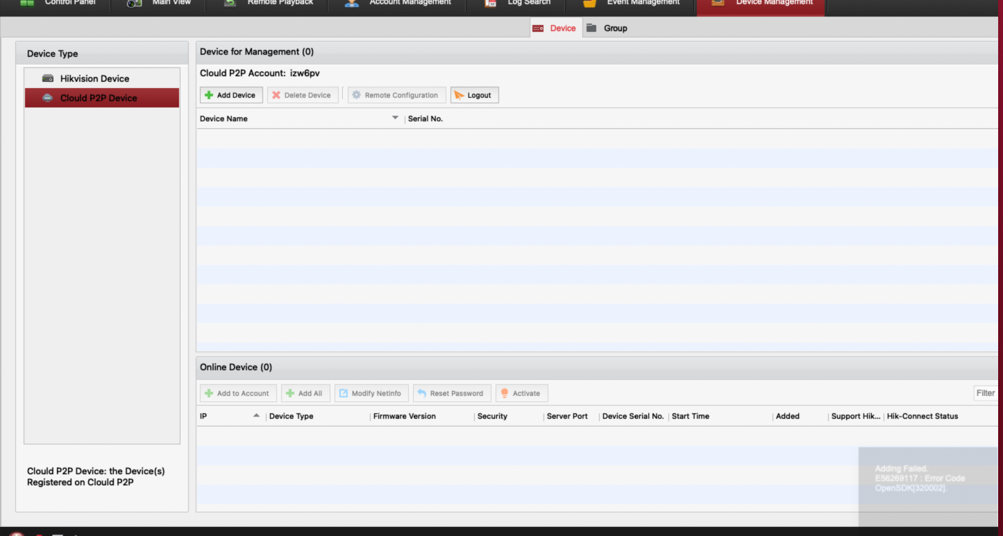

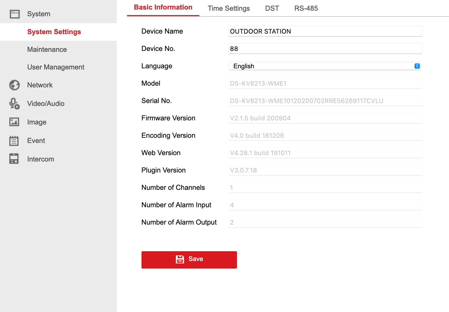

I also bought a DS-KV8213-WME1, and there is no option to connect to hik-connect, I can manually add it to the IOS app, but then I don't get any calls when they ring, and on the website it doesn't appear, on the IVMS 4200 I was able to add , but then when trying to put online, putting the serial number and the verification code, an error appears saying: Error Code OpenSDK (320002). I also created an account on sip linphone.org appears as registered, but when pressing the button, make the call but after answering an error message appears: Not Acceptable, can someone help?
