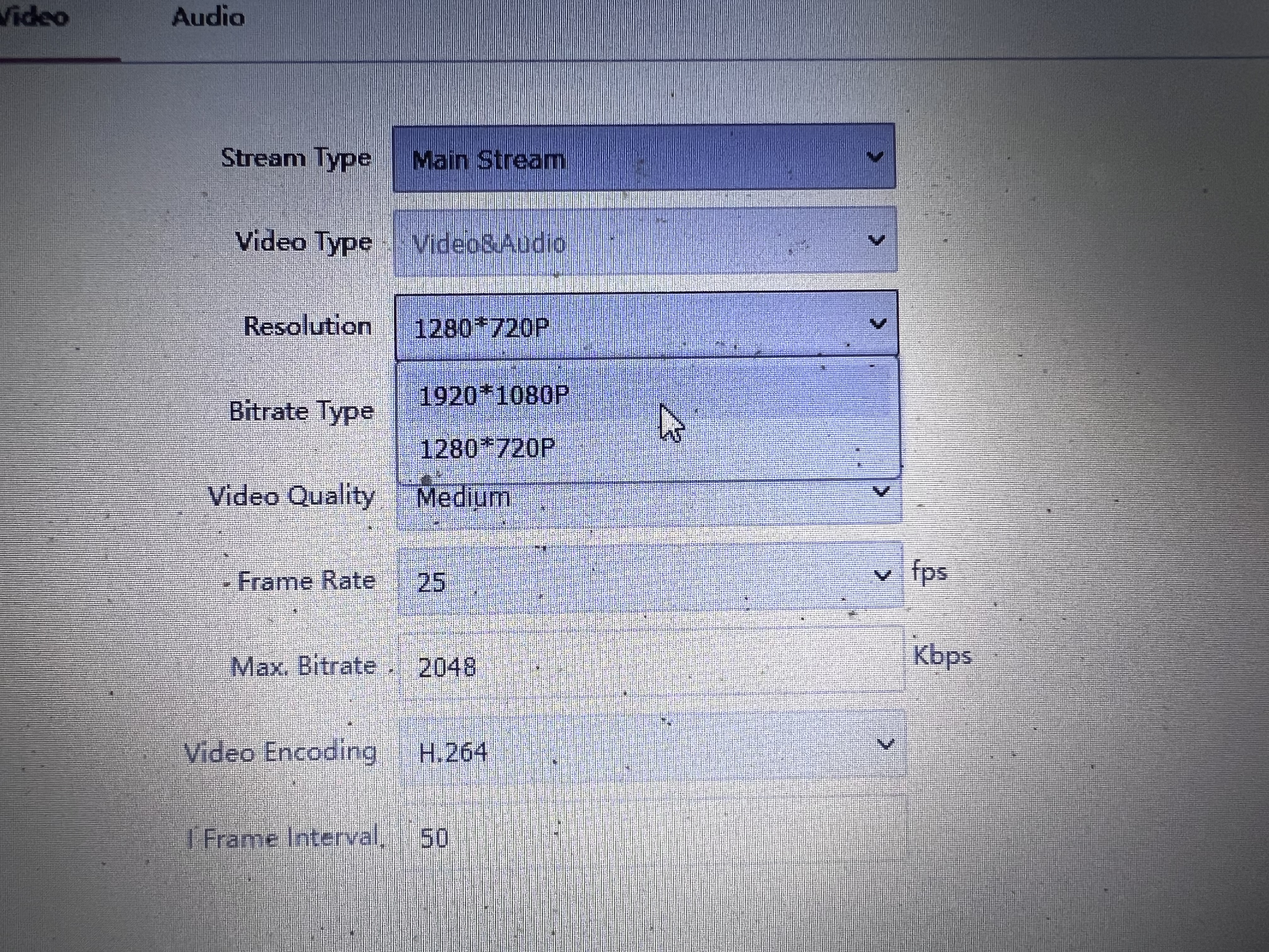

IP cameras can be added to your DVR but at a maximum resolution of 960P. The default for the doorbell main stream is 1080P. Login to the outdoor unit using a web browser and change the resolution down to 720P and it should work fine.

I have logged into the doorbell and I can only see these two resolutions? Does that it won’t be supported?
It should be fine if set to 1280 x 720P.
The DVR supports up to 960P (1280 x 960), so 1280 x 720P is lower than that limit.

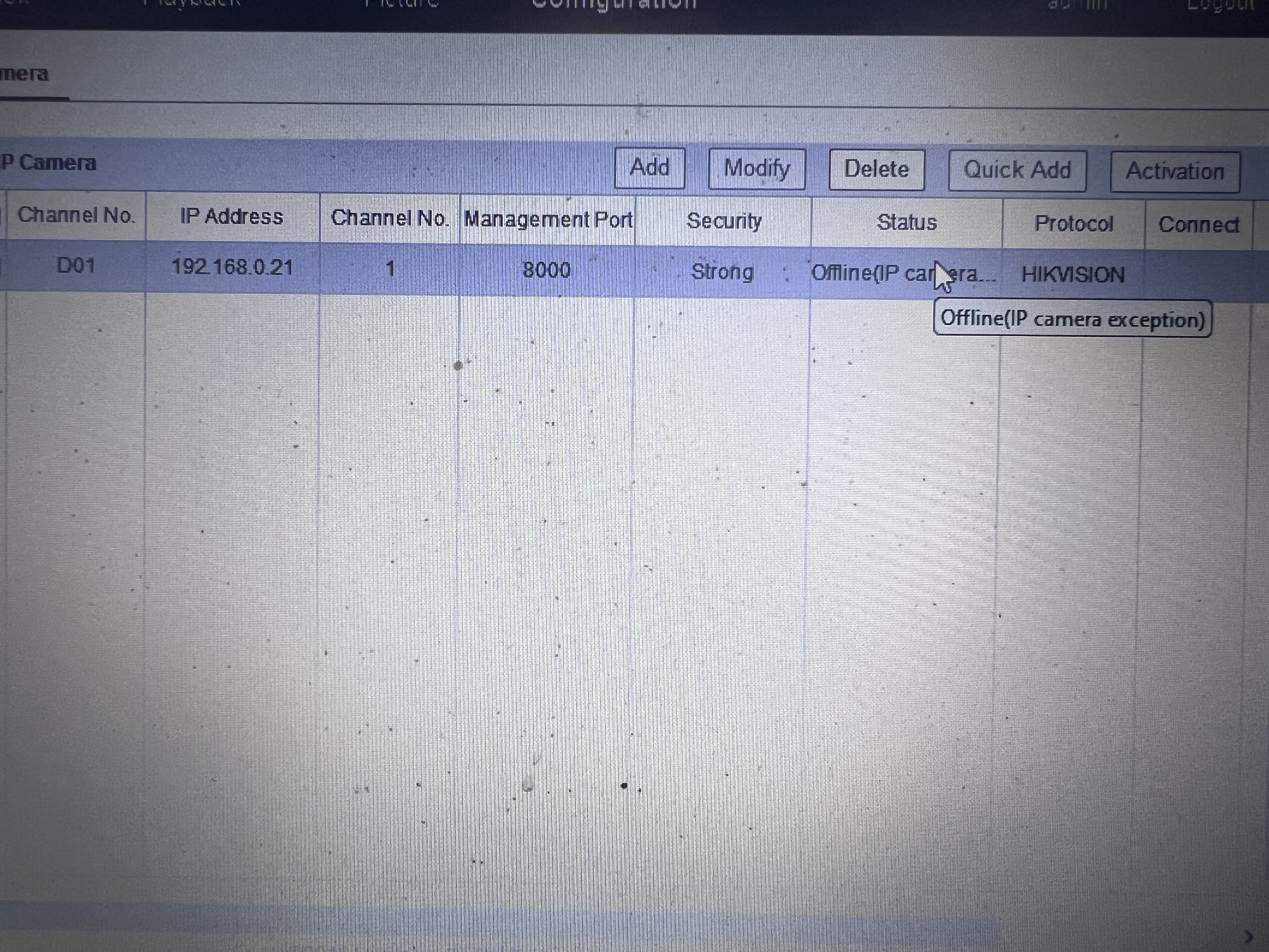

I changed the setting of the doorbell down to 1280 x 720
When I add the camera with the ip address that’s in sadp, it’s says connecting for around 30 seconds then I get the below message saying it’s offline?
Not sure what the ip camera exception means?

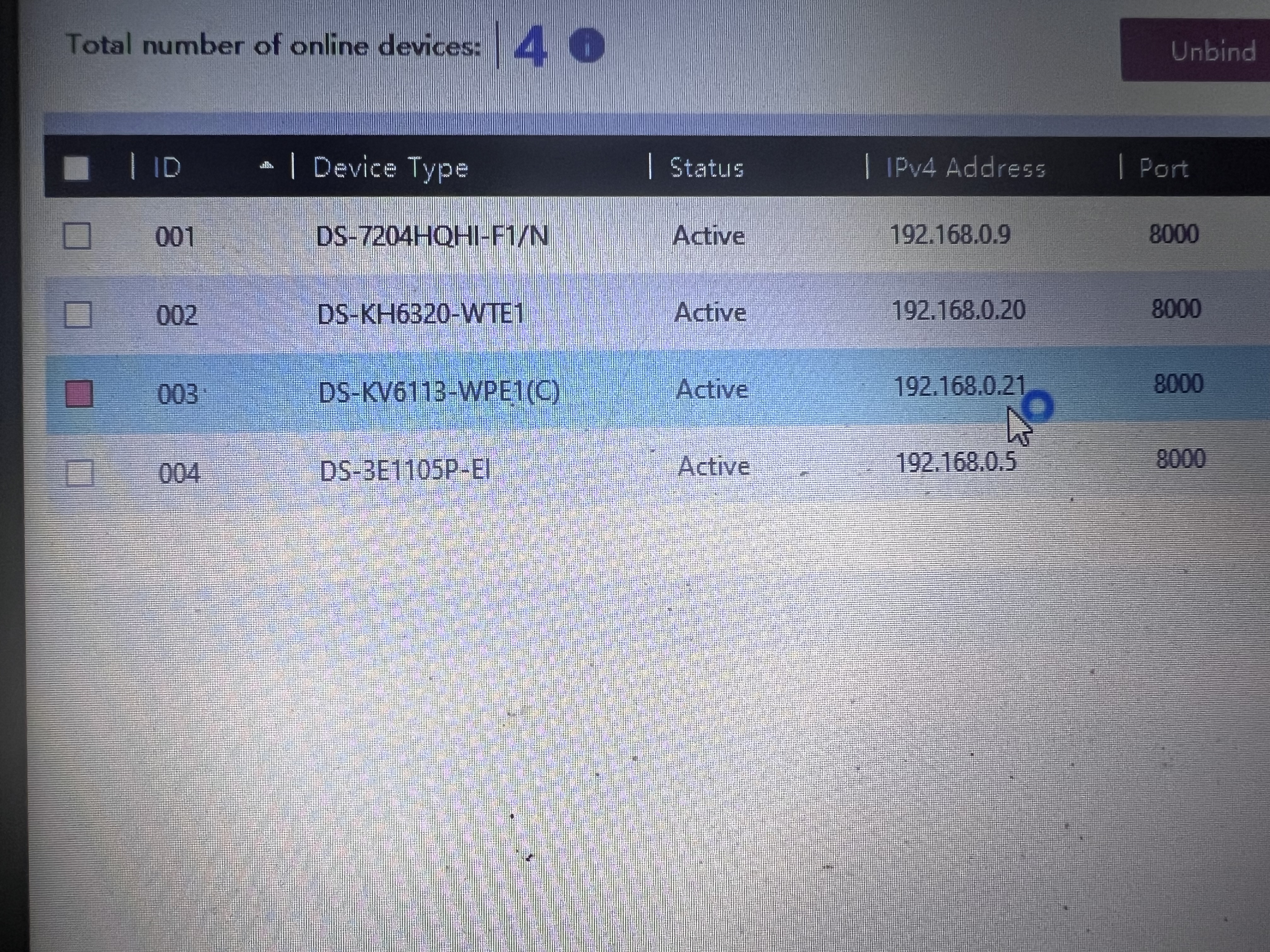

It's not connecting then. And when you fill the details in for the KV6113 you're definitely entering 'admin' along with the password for that device (not the DVR)? I can't think of any reason it wouldn't work (assuming the doorbell has the correct gateway address and subnet mask to match the DVR, but it would be unlikely that they're wrong). I'm out of other ideas unfortunately.
Yeah 100% the correct password, ive checked the gateway and subnet mask and they all match, im at a bit of a loss too, thanks for the help, maybe time to upgrade the dvr to a later one
