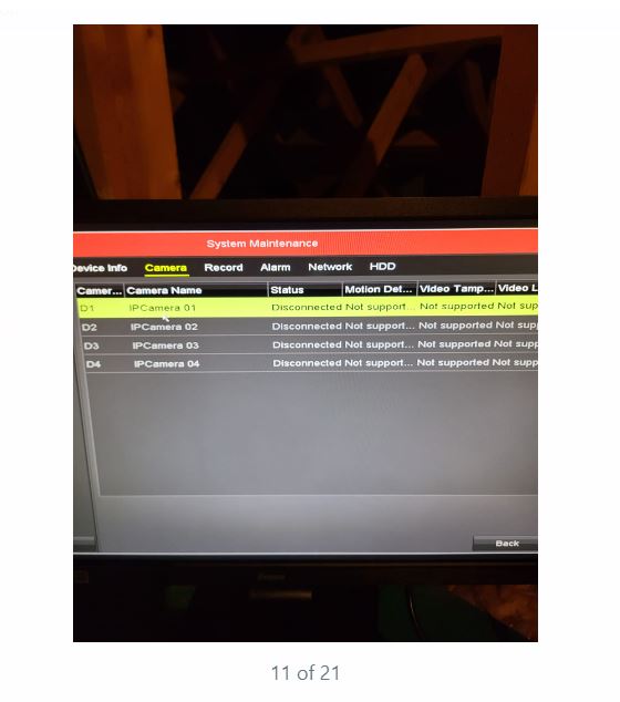

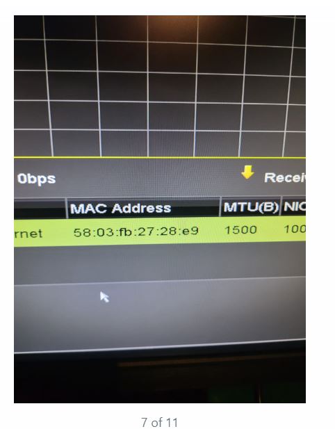

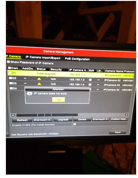

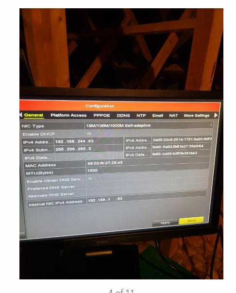

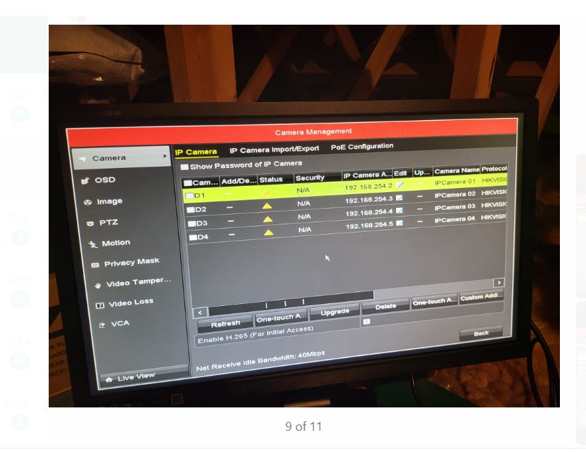

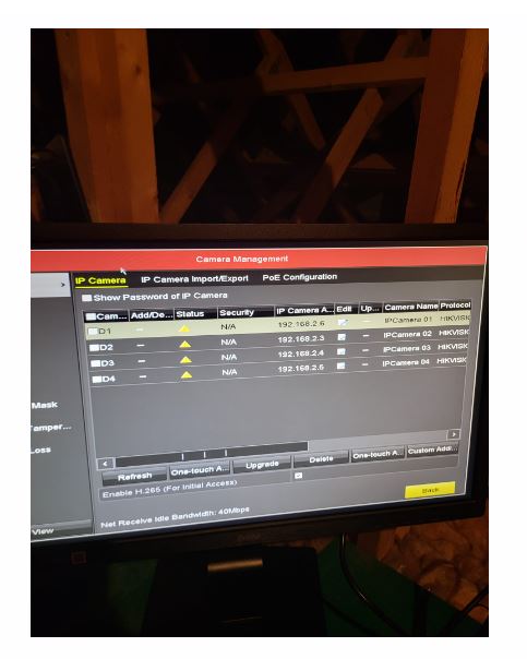

There is some very strange stuff going on in those photos. This could be my fault, sorry, as i am not sure when i took which photo when, i can send you the latest if you tell me which ones you need.

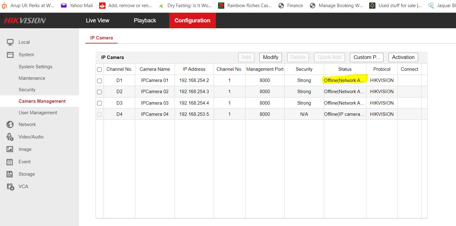

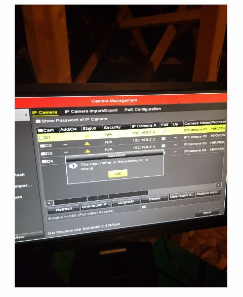

Are all 3 cameras plugged into the PoE port on the NVR?........ yes at the back of the NVR

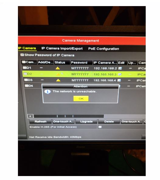

Was this system installed by a previous owner of the property? yes Did they leave you the NVR password? (I assume they did because you managed to log in to reset it) well, I was given the tick for the dots sign in, not sure what the original password was.
I think what has happened is that the cameras are directly connected to the PoE ports on the NVR and were activated with the NVRs original password, when you hard reset the NVR and probably set your own password this broke the connection to the NVR because the password they were assigned was no longer recognised by the NVR.

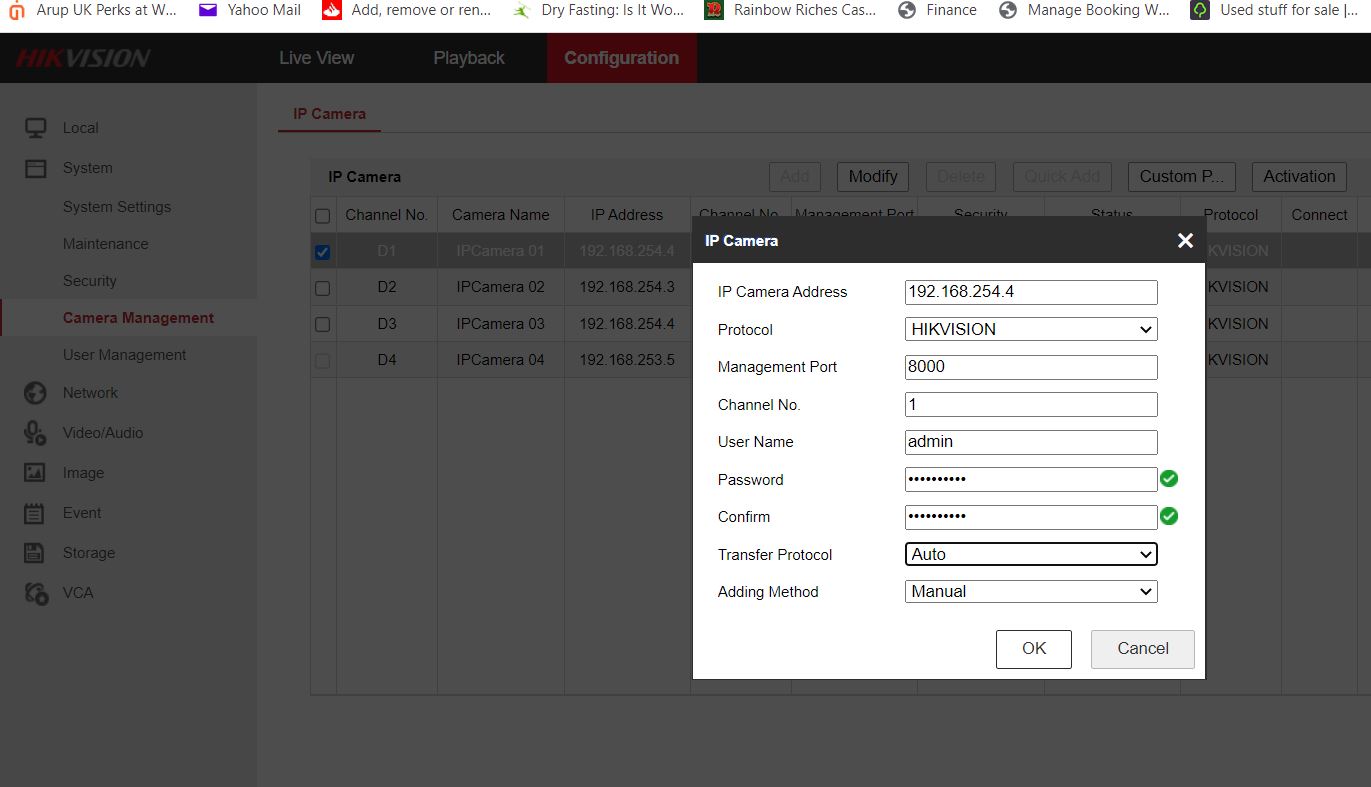

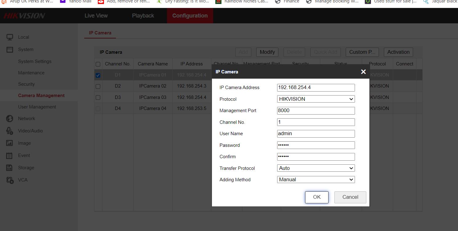

If you go into the camera management page (on either the browser or direct monitor), select one of the cameras, click the edit/modify button, enter the old NVR password as the camera password, and click save they should come back online. ok I think I may have it but what if that is not it, how can the old password be obtained or reset? Thanks for looking at this, much appreciated.
