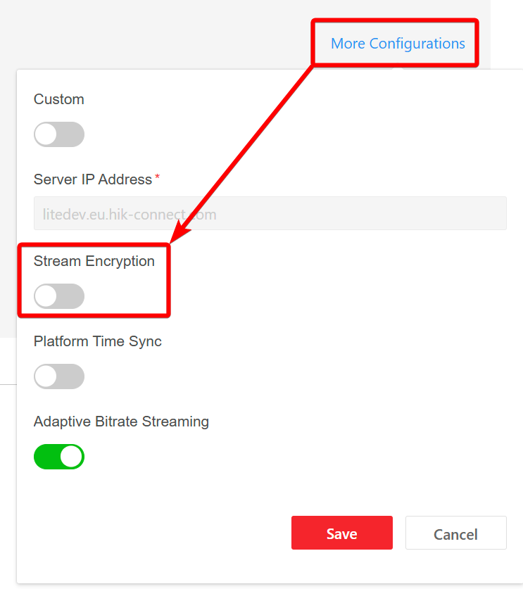

It may be that something has changed with the encryption key when you updated to V5, or it has been wiped completely.
Try setting a new encryption key as shown in step 4 or part 1 in this guide, and then enter this on the 'Local' page again.
Or, disable stream encryption entirely by clicking 'More Configurations' on the Hik-Connect settings page:
