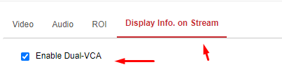

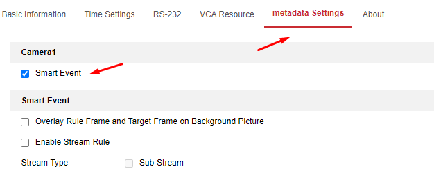

***SOLVED***

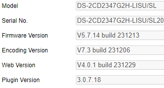

4.63.005 appears to have broken VCA search with the NVR possible discarding VCA data sent by the camera.

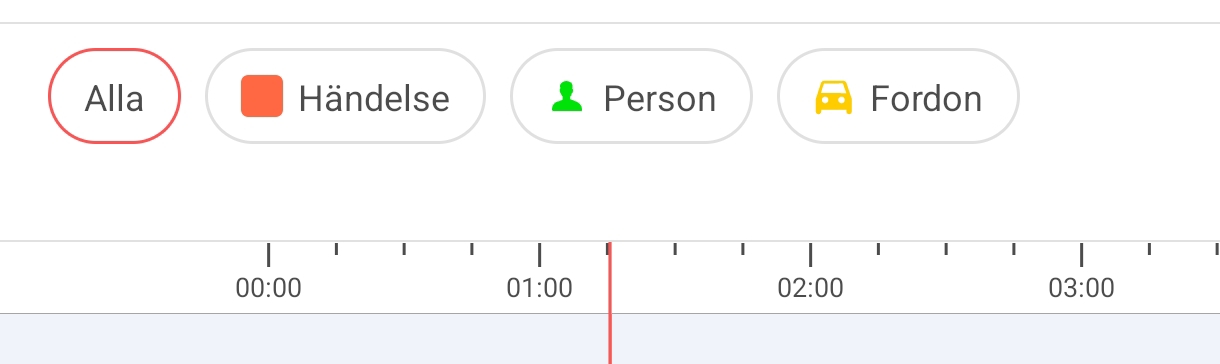

In Smart Playback, markers are shown automatically for pre configured events. Using the VCA search and 'Draw Line' then automatically updates the markers to reflect the searched area.
In 4.63.005 the search is not working for any recording made after the firmware update. I can do the VCA search in Smart Playback for video recorded before yesterday and all the markers display. However any VCA search on video recorded after the search give no results at all.
