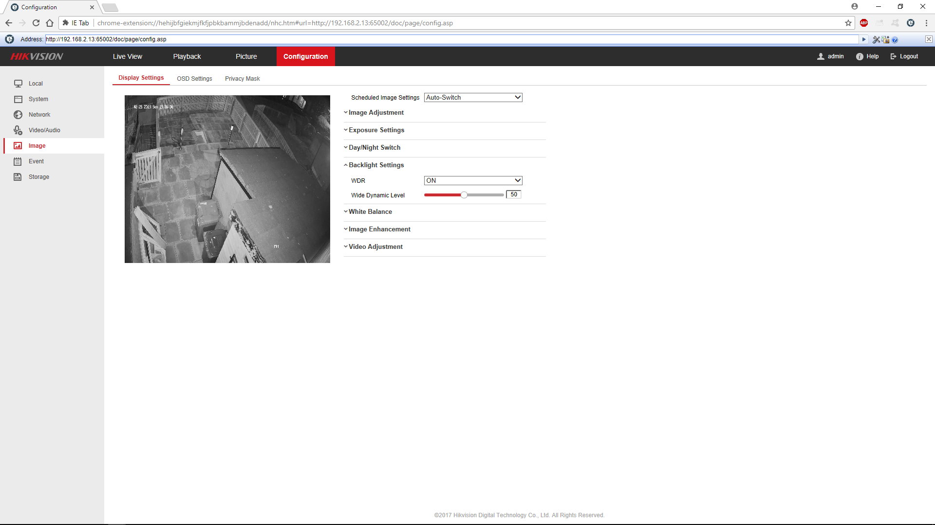

I wondered why one of our turret camera's wasnt playing and it turned out to be the WDR setting in the config.
May not be the same problem but worth a look

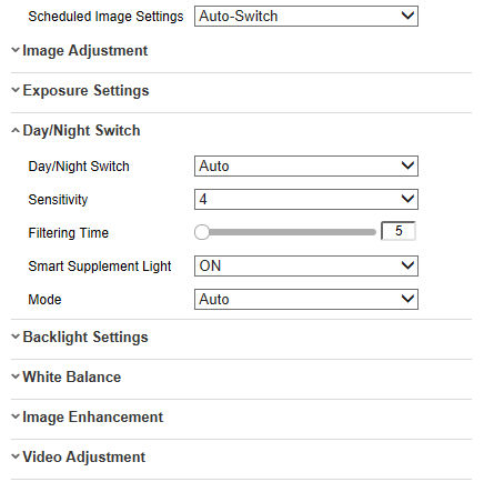

How our settings look like
Many Thanks for your reply I will check the camera settings and let you know , I will take a screen grab and show you but it looks the same as yours but I see you have got a day and night switch so me thinks this is how you adjusted the light level sensor .Many thanks for your feed back .

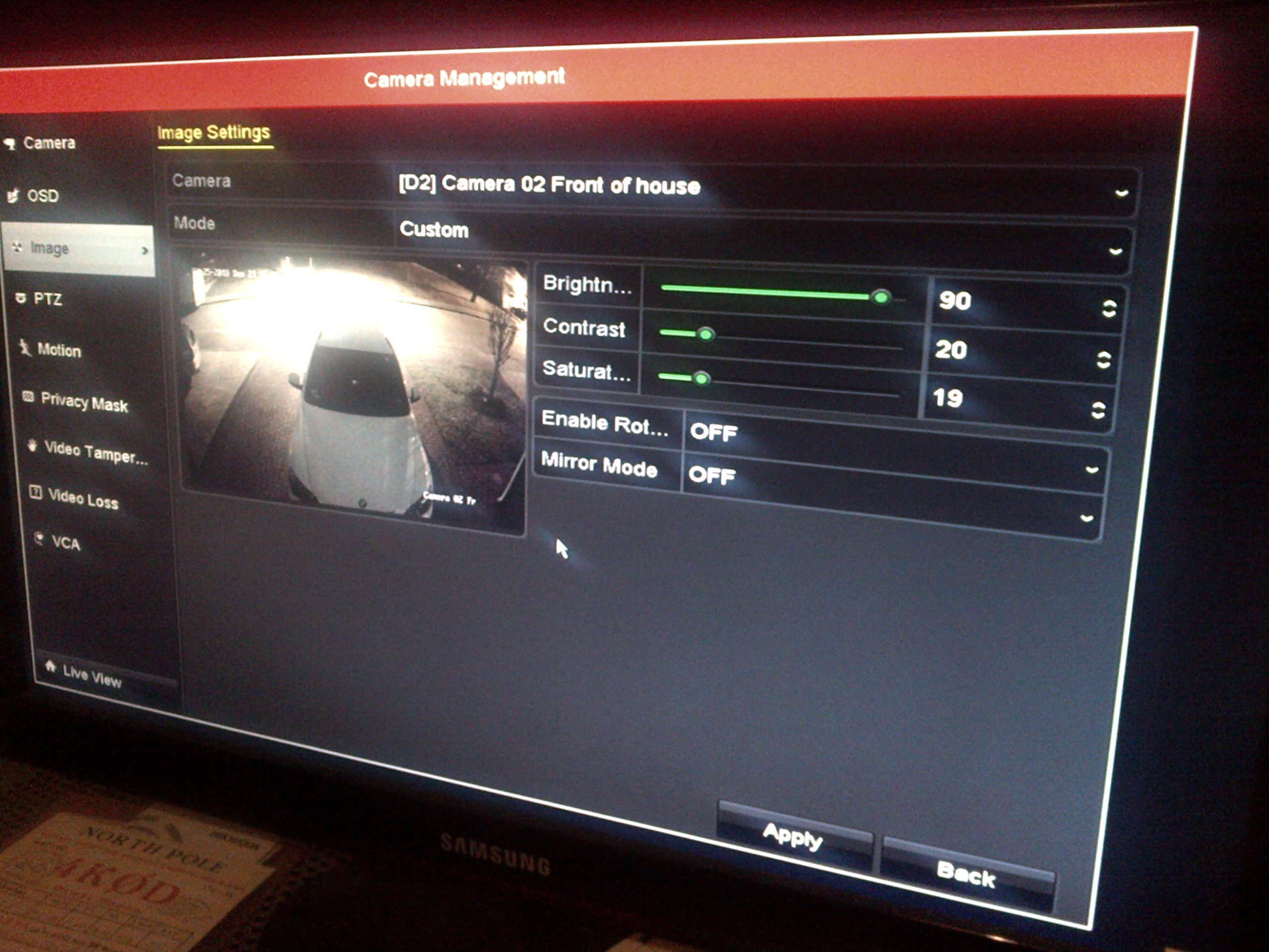

Well I had a look at my menu and it does not seem to be the same as yours or maybe I am looking in the wrong place ?
My NVR is a HIKVision DS-7608NI-E2/8P/A 8 Channel IP NVR
I have done picture of what I have unless I am looking at the wrong menu ?
Cheers
can you log directly into the camera using its ip address
you are looking at the nvr settings
directly into the camera gives you more settings as per brian robinson's picture

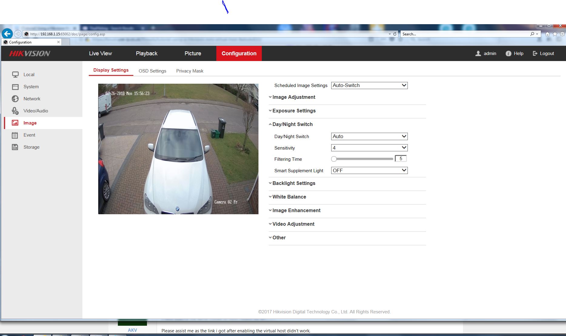

Ok I am now into the Day / Night camera settings , What do I adjust so that the camera comes on just as its getting dark and not when its zero light .
Once the setting has been done do I need to click off Virtual Host ?
I think if you set the sensitivity to a higher number it will switch when it is not so dark.
Click the contextual help icon at the top right of your screen and see what it says / recommends.
Virtual Host can/should be left on - it's such a useful feature that I don't know why it's not 'ON' by default.

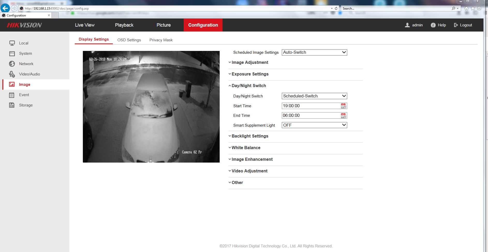

Ok guys I set the sensitivity at 7 and it still will not switching into night mode the only way I can get night mode to work is to switch to scheduled-switch night vision on at 7pm and off at 06.00

I will have a look at my setting and see what there is, i had this prob and put it to schedule, then back again and also turned WDR on ;-)
Hi Phil / Mick Well the good news I got the Auto to work by lowering the lighting setting to 2 and that seems to switch over ok .

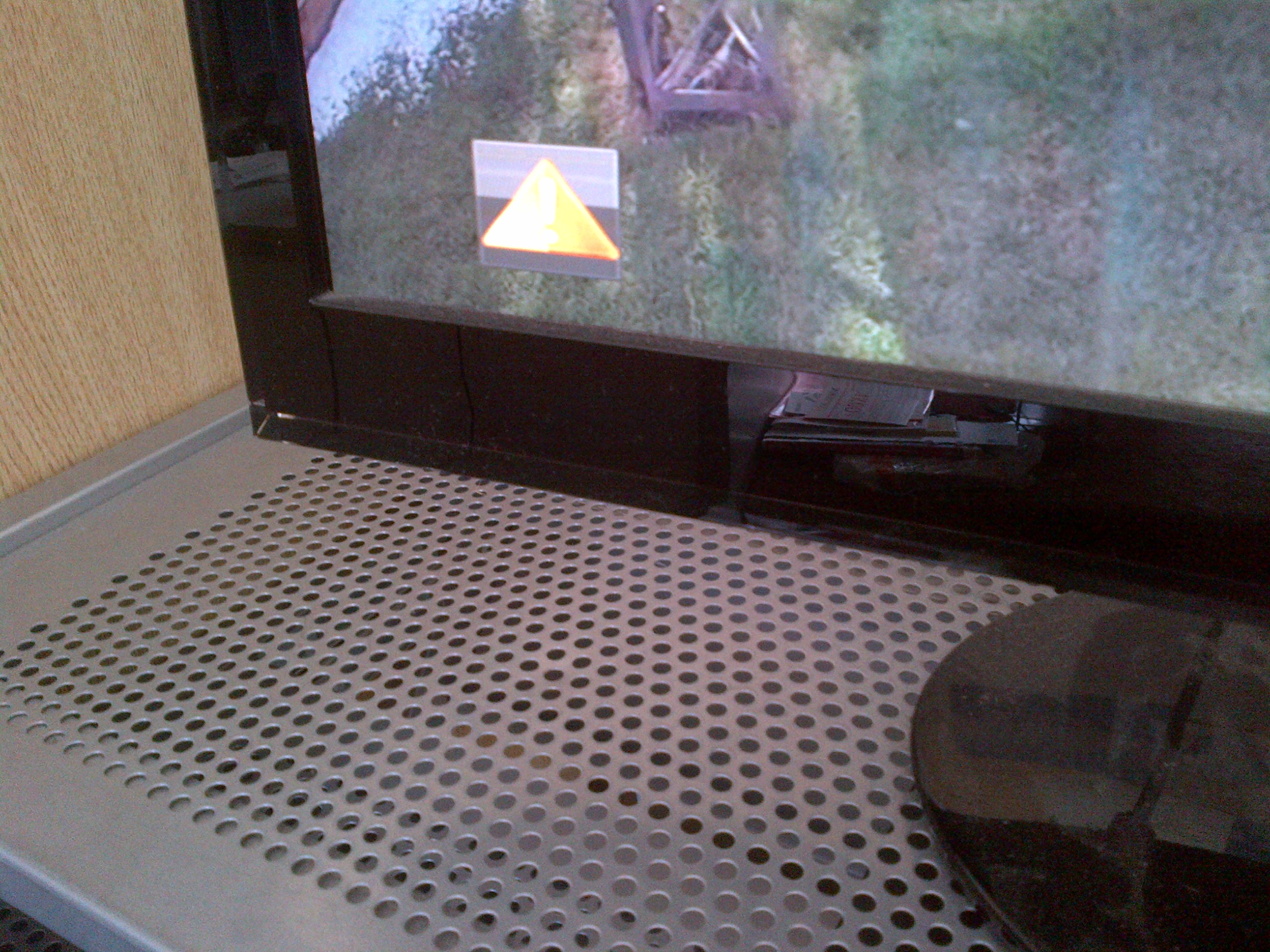

Hi Phil yes its all working now fine I got night vision to switch over when i set the level to 2 so all is well , While I am talking to you on my number 7 camera I keep keep getting a warning sign about every 2 minutes , I thought it was some thing to do with motion detection so I turned it off but still getting the sign in the bottom left hand corner . So how do I turn off this warning sign ?
Thanks again
I don't know what is prompting that, can you check the camera's Log please?
