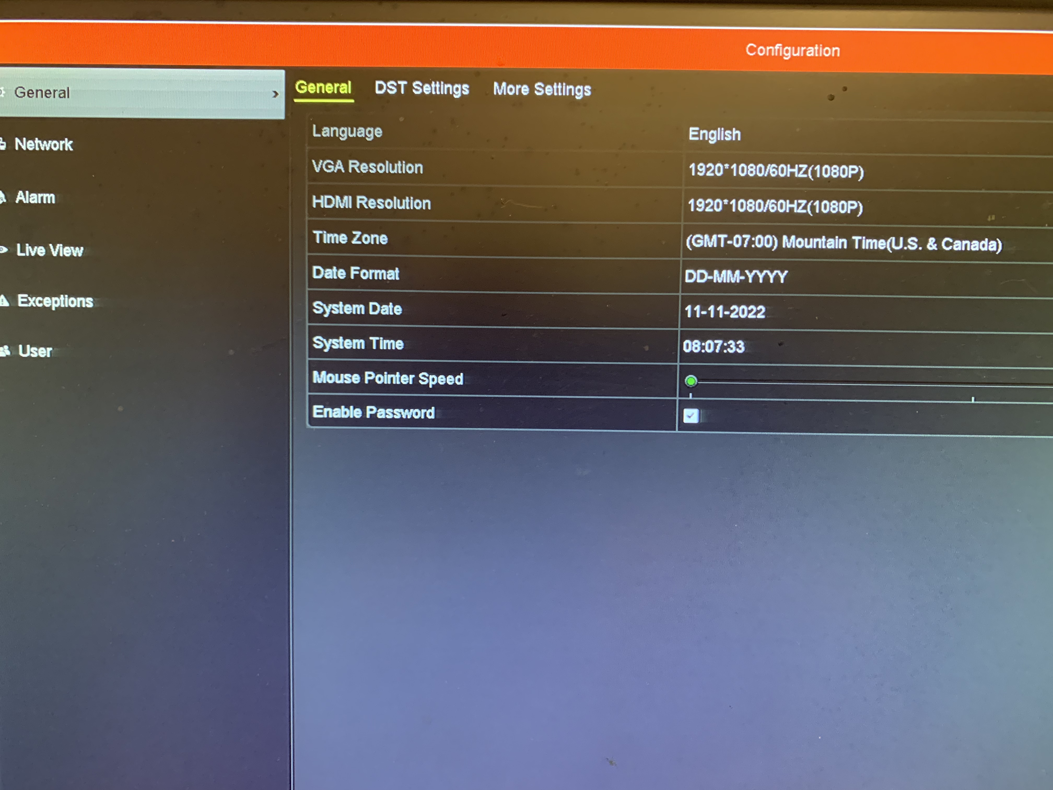

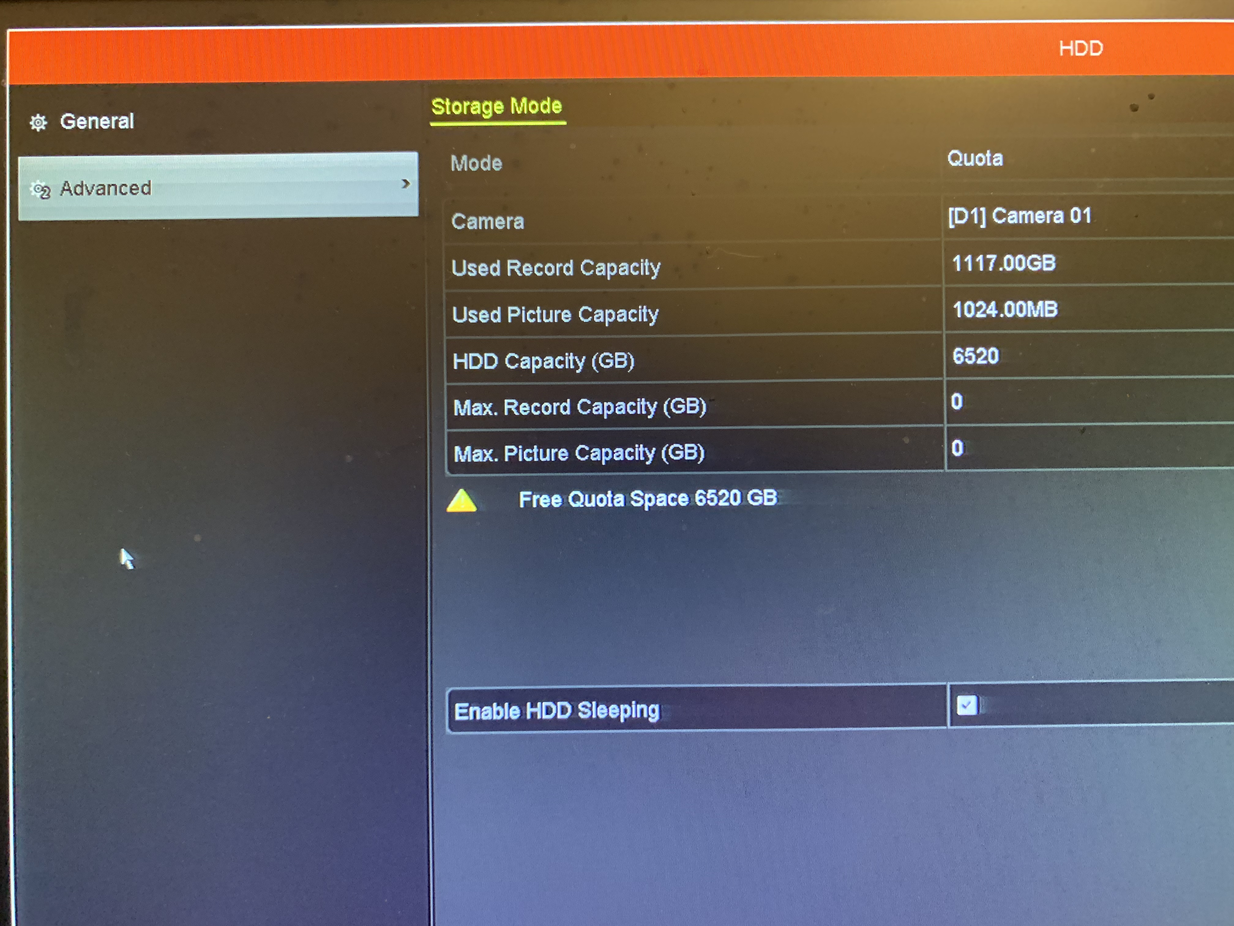

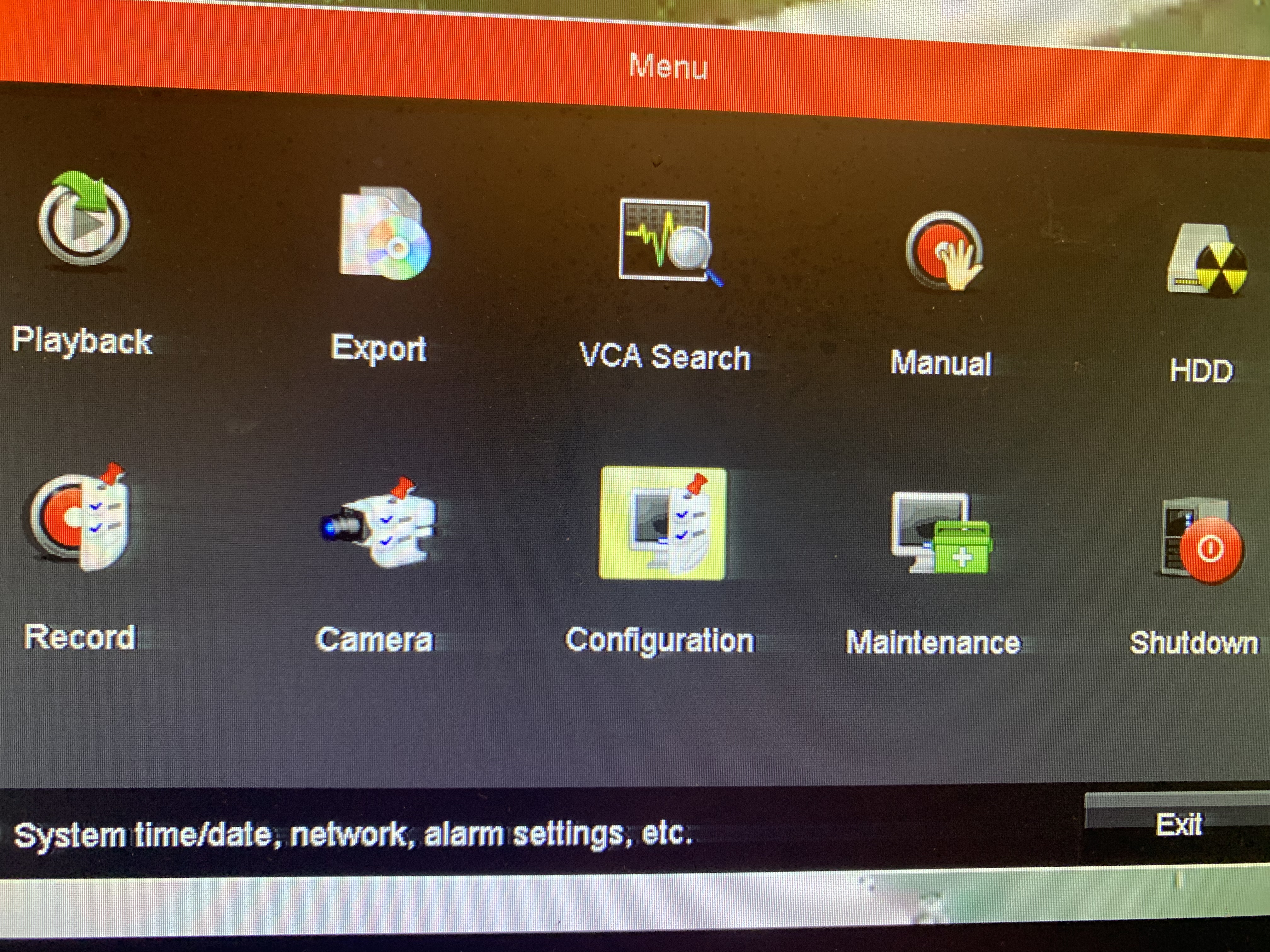

Thank you for the response. Unfortunately I do not have a storage option in my configuration menu. I do have Menu>HDD>Advanced settings however nothing is labeled packet time.
I will upload the some screen shots. ACAB7678-B7D1-4ACC-AD28-EEC39A670462.jpeg64A8CD51-1832-446E-90F1-50500D6CA05F.jpeg2BE21D43-E848-4DCE-AACC-D1638830593E.jpeg
Okay,
It looks like your NVR might be running quite an old firmware, can you go to Maintenance > System Info. > Device Info. and let us know what version your NVR is currently running?
