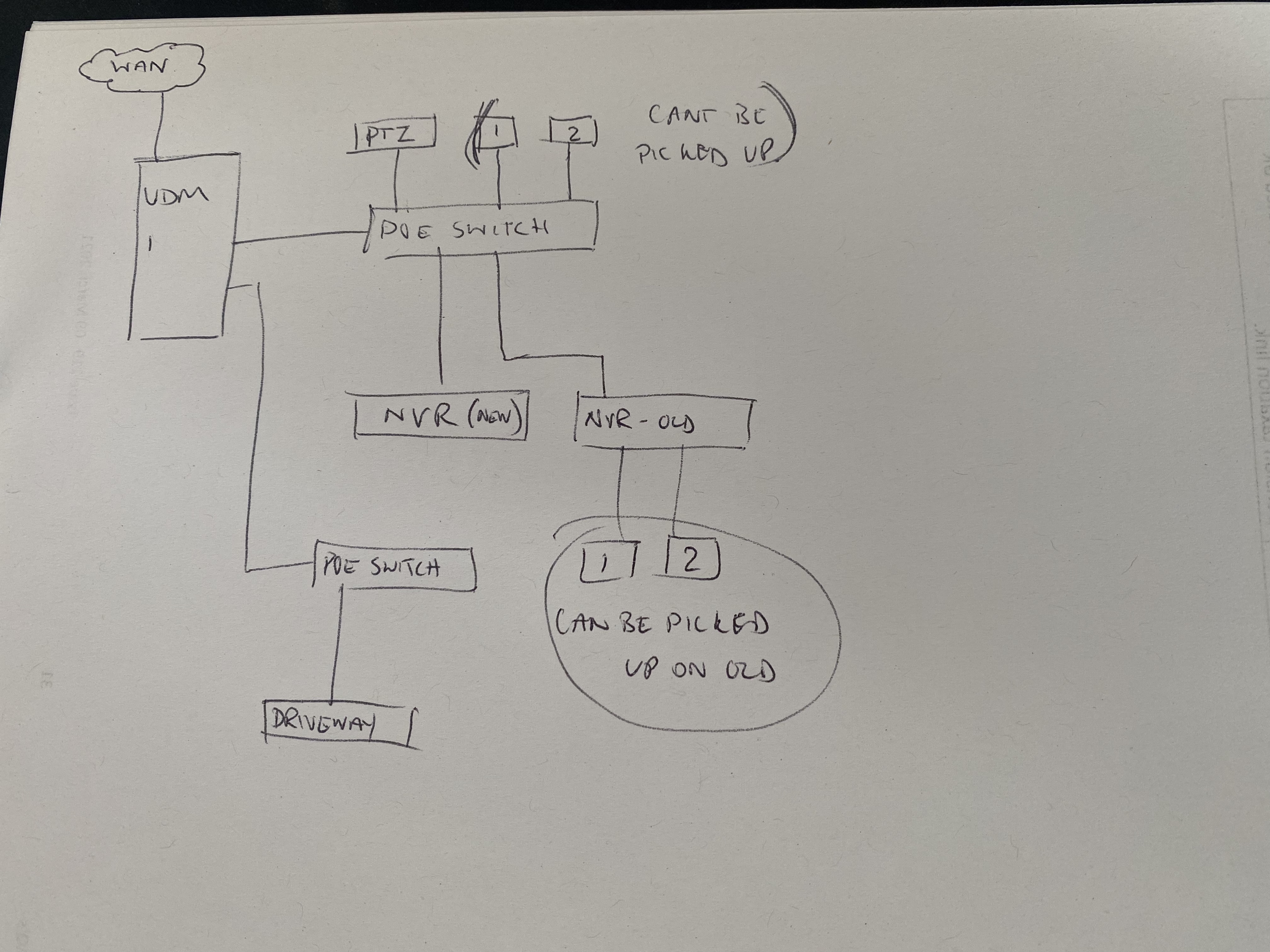

Hello,
So I've been having a proper nightmare the past couple of days ever since I upgraded my NVR.
So on my old NVR I had 4 cameras (one of which was IP over my local network, the other 3 were connected directly to the NVR POE).
Since changing my NVR I can only access the one thats IP over my local network, and a new camera I installed in replacement of one of the 3 I had previously. My new NVR will not pick up in any way shape or form the remaining 2. However when plugged back into the old NVR they work and pick up fine.
SDAP doesn't see the cameras unless they are plugged into the old NVR. I have tried changing the IP through SDAP to match ones on the ports I am using on my new NVR, this hasn't worked either. I have then connected my PC to the old NVR (ip set up etc) and logged into the two remaining cameras, did a full reset on them though the web interface, thinking that when plugged into my new NVR they would work, they don't, they still only work on my old one.
Does anyone have any suggestions as to how I can get over this, currently 2 cameras down and I'm loosing my mind as to why the new NVR won't pick them up or even attempt to adopt them, even after the cameras have been reset via the web interface.
When connected to my new NVR it just comes up with offline(detecting)
It is impractical for me to access the camera and pull the LAN at the same time due to their position of install.
Any help would be greatly appreciated!
