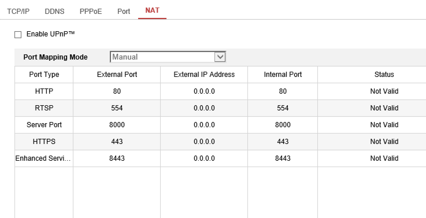

Does the DVR NAT tab look like the attached image?

No, the 8433 port is not shown.
@old codger Ron,
8433 is the enhanced service port and not really needed for this.
