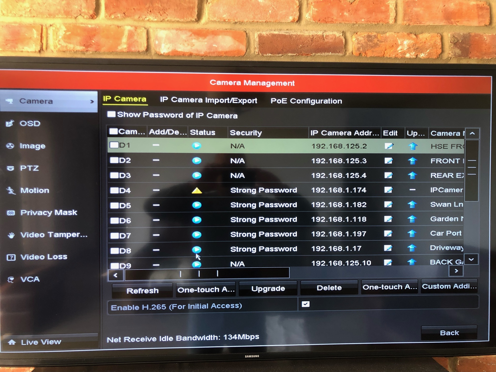

Recently, one of the PoE cameras (D4) has started showing as offline and I am unable to view it either via the HIK Connect app or via the NVR interface. The other 8 (including the other 4 PoEs) are still working without issue
Having spent hours trying to find a solution (to no avail) on the internet I came across this site. I’ve read through the various similar threads but I’m either doing something wrong or not grasping what is needed.
I attach a couple of pictures of the camera configuration and would be grateful if anyone could offer any words of advice. Although I am reasonably tech savvy with day to day stuff, I might need to be treated like a child with anything too in-depth!

Hi @Chip
What NVR model do you have and can you confirm the current firmware the NVR is running? (all this info should be under the Maintenance > System Info menu)
What camera model is the offline camera?
You say the offline model is one of the PoE models, do you mean one connected to the PoE ports on the NVR or on remote PoE?
If it is remote PoE have you tried accessing the cameras with a browser on the local network? just open Internet Explorer and put the 192.168.1.174 IP into the browser address bar, if the camera is still online you should get to the login page and this will help us identify if it is an issue with the connection to the NVR or an issue with the camera.

Hi Dan
Thank you so much for the reply - hopefully this will answer your questions
The NVR is model DS-761NI-K2/16P
The firmware is V3.4.104, build 190128 (I checked for any update and it said there isn’t any later build)
The camera model is DS-2CD2623G0-IZS
The camera that is offline is via a remote PoE switch located in an outbuilding (the other 4 working PoE cameras are also connected via this same PoE switch)
I have tried entering the IP address into a browser and I just get an error message saying something like “error, connection timed out”. If I try putting the IP address of a working PoE camera it does take me to the log in page
At night, you can see the infra red lights on the faulty camera, so I would assume that power of sorts is getting to it.
Thanks again for your assistance and I hope the above helps with suggesting a possible solution!

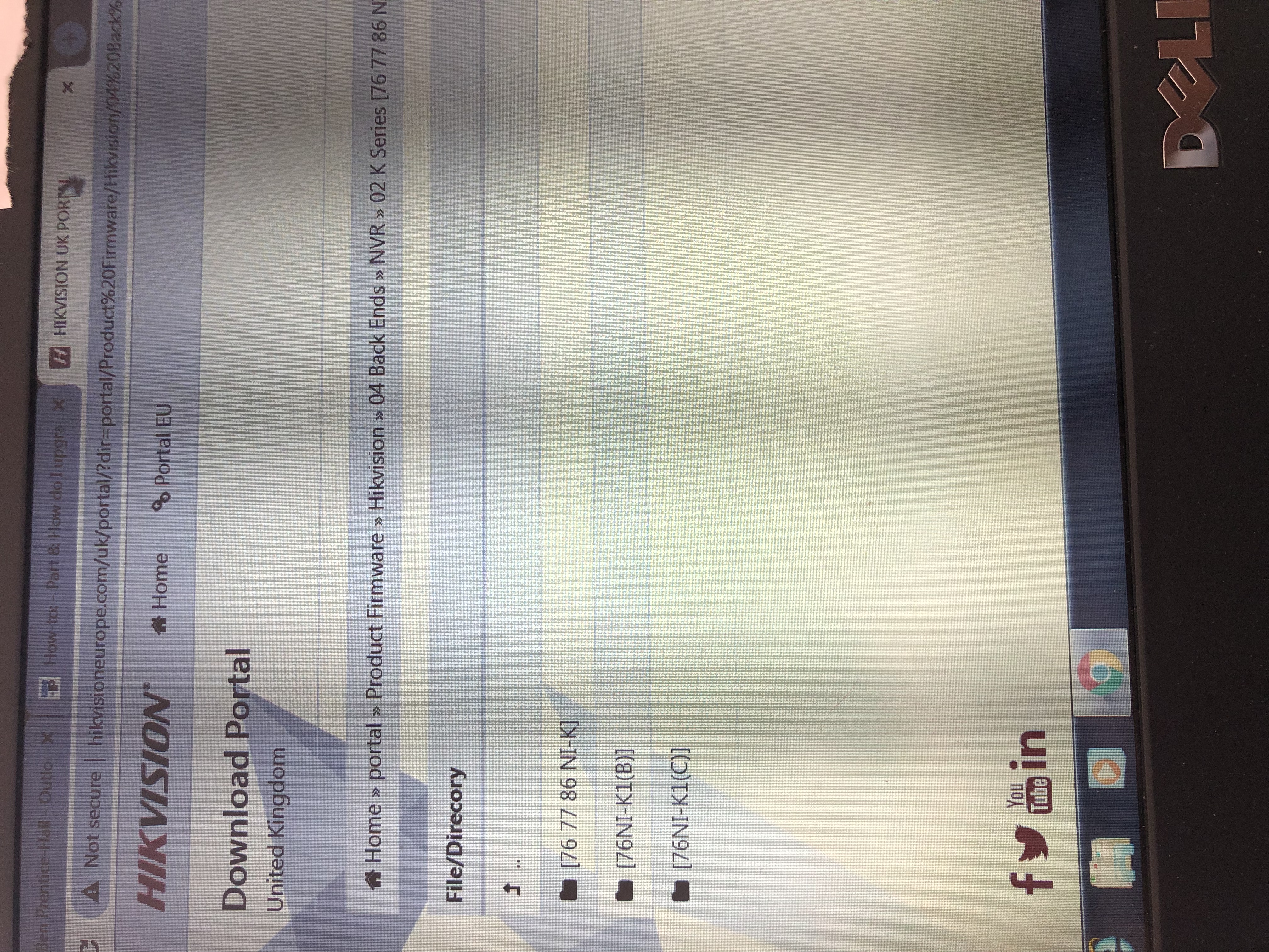

Can I just confirm that mine is a K series? And if so, which of these sub folders (and the subsequent ones after that) do I need to choose?

Hi @Chip
Your model is definitely a K-series as you said it was a K2/16P model.
If you follow the link in my earlier post that should take you directly to the correct sub-folder which is portal » Product Firmware » Hikvision » 04 Back Ends » NVR » 02 K Series [76 77 86 NI-K] » [76 77 86 NI-K] » [76 77 86 NI-K2 K4 K8]

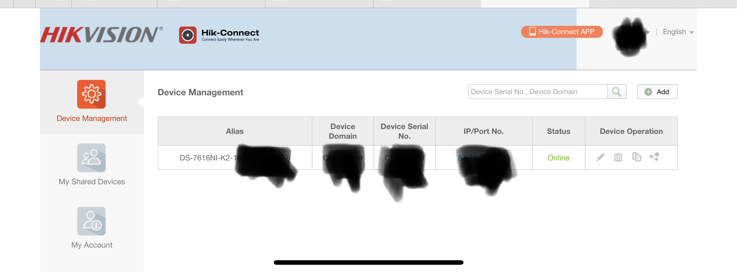

I’m a little confused - I can log on fine to the NVR and also if I go to the HIK connect webpage (see attached). Are you saying there’s another set of log on details I should have / know?
Going back to the installer / seller isn’t a possibility so if I am missing another log on and password, I guess I’ll have to go to HIK directly?

I can log on to HIKconnect.com (as per the previous screenshot)

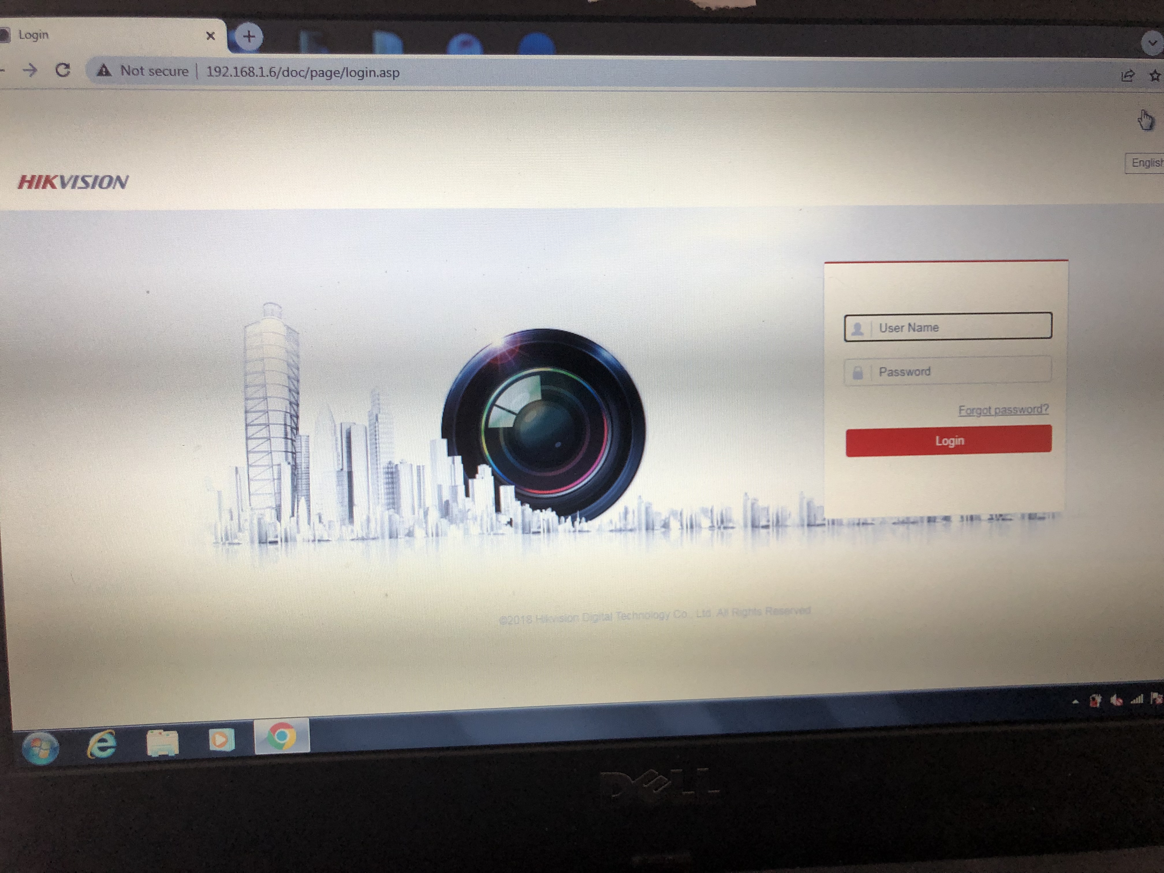

The only bit I can’t seem to log on to is when I follow your instructions in post #4. When I try to log on to the IP address to upload the firmware update file (using the same username and password) it says it’s incorrect
Okay, that's strange.
The browser login password should be the same as the direct monitor login password.
What IP address are you using to log in with the browser? What Browser are you using?
Attached is the screen where it says incorrect username / password
I’m using the IP address 192.168.1.6 (also as per the screen shot)
I’ve tried on both google chrome and a safari browser. Have just attempted it again and it still won’t work

Okay, it may be that due to the age of the firmware you are running it is not properly supported by modern browsers as they removed support for the plug-in that the NVR required for browser access.
You may have to do the firmware update via the desktop iVMS-4200 software, this basically allows you access to the same menus and features as the browser but on your desktop. Install the software, open it and go to device management, either select the NVR from the online device list and click add to client or click add in the top left of the device management window to add the NVR manually.
Once you have the NVR added to the software you can select the NVR and then click remote configuration, a pop-up menu should open with all the NVR menus, click System > System Maintenance and you should be taken to a page with a section labelled Remote Upgrade where you can load the NVR firmware.
