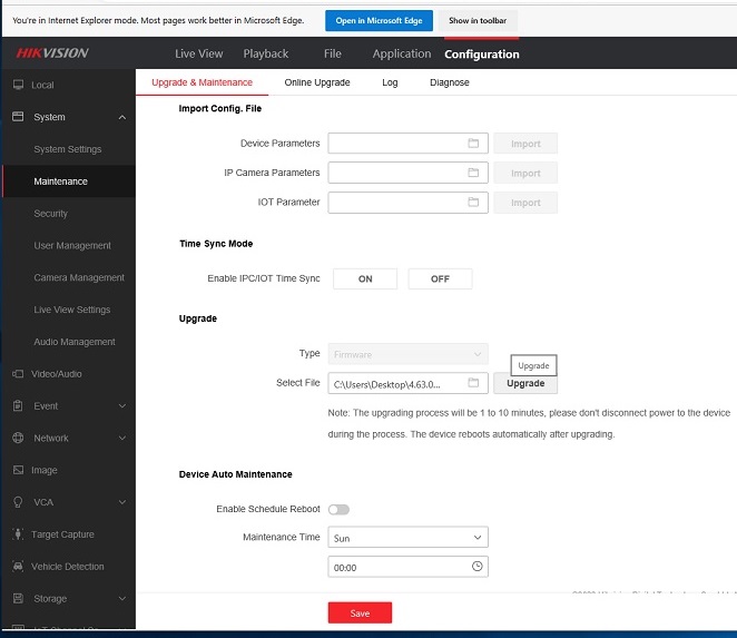

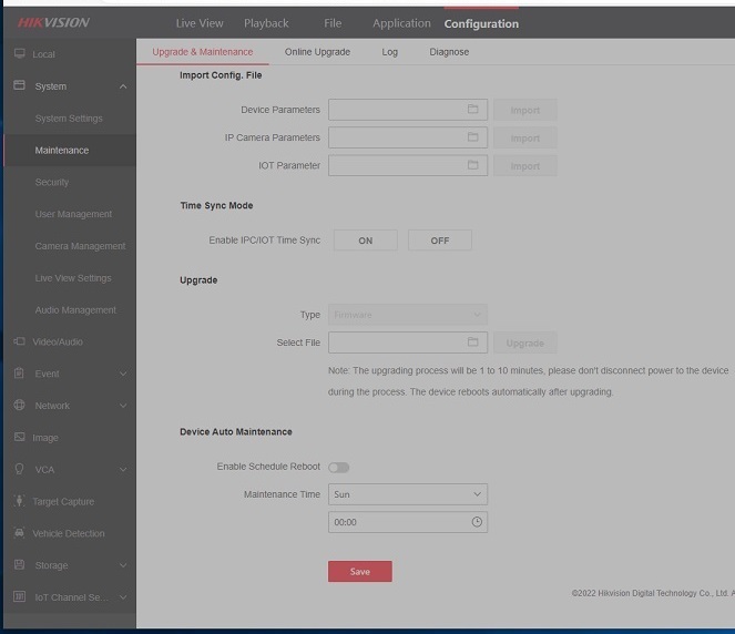

I have just tried to update the firmware on my M series NVR in Edge, however, when trying to select the firmware the whole screen greys out and becomes non-responsive.
I have to refresh the page to bring it back.
Reloading in Internet Explorer mode allows me to select the firmware and click 'upgrade'.
Has anyone else with an M series experienced this?

It doesn't work at all for me. The page just stays dim and non-responsive. This only seems to happen when I click on a box to browse for a file and it happens every time. Refreshing and reloading the page is the only way out!
I've previously updated in IE mode with no issues. Its only since @Kyle advised me that the M series is compatible with Edge, that I started using Edge.
I will install the plug-in (which incidentally is v1.0.0.60 from the NVR) and see if that makes a difference.
